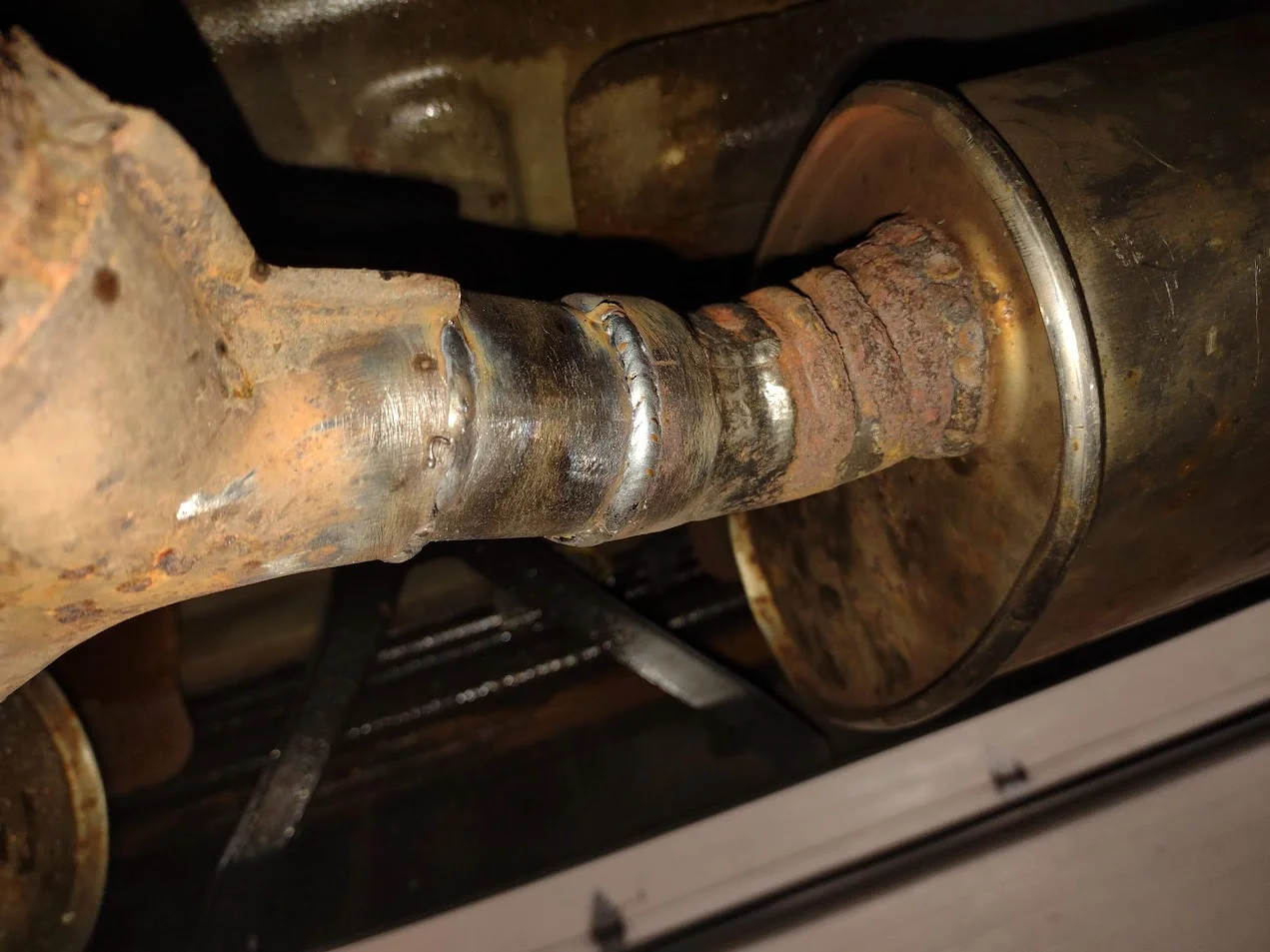

Many choices if just having muffler shop weld up. But I would not let them cut off the CAT flange, like seen in picture above in post #6.
