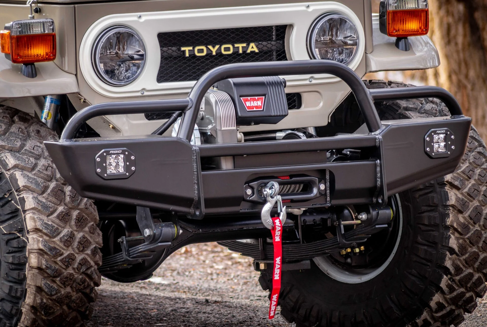

Looking for mud member pics and advice on best way to cut into a steel bumper to mount a pair of fog LEDs - either into the stock or aftermarket bumper. Always hard to cut perfect squares with a circular angle grinder/cutter.
While I'm not a huge fan of those lights... the best way to cut squares with basic tools is mark all four corners of the square. Drill the corners out with a fairly large drill bit (probably 1/2" or so). Then use an angle grinder and connect the outer tangent of the holes. Now you have nice rounded corners and you're not trying to make the corners with the wheel.
