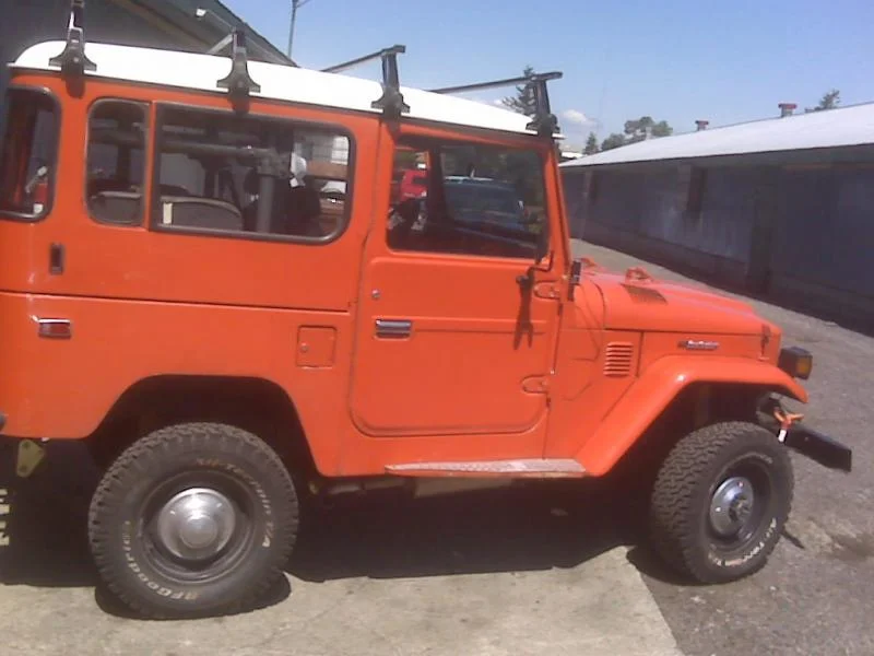

I'm at 1500km of my BJ40 for pic but if you do that you need to keep your top and door. When you drive under 20m/h you'll have some smoke inside. I run 2.5'' glasspack exaust right in front of my passager side tire. Sound is good, not to loud but some smoke run inside by rear door if you have some holes.

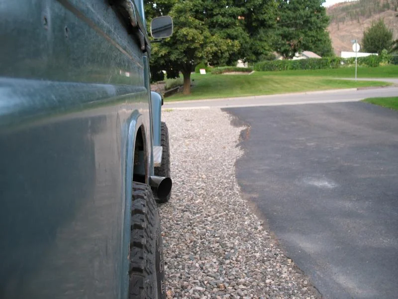

3 inch right off the turbo, a short flex pipe, and then a 4 inch chrome tip
I like how it sounds
I stuck it out the side a little extra because the box and wheel were getting all black
