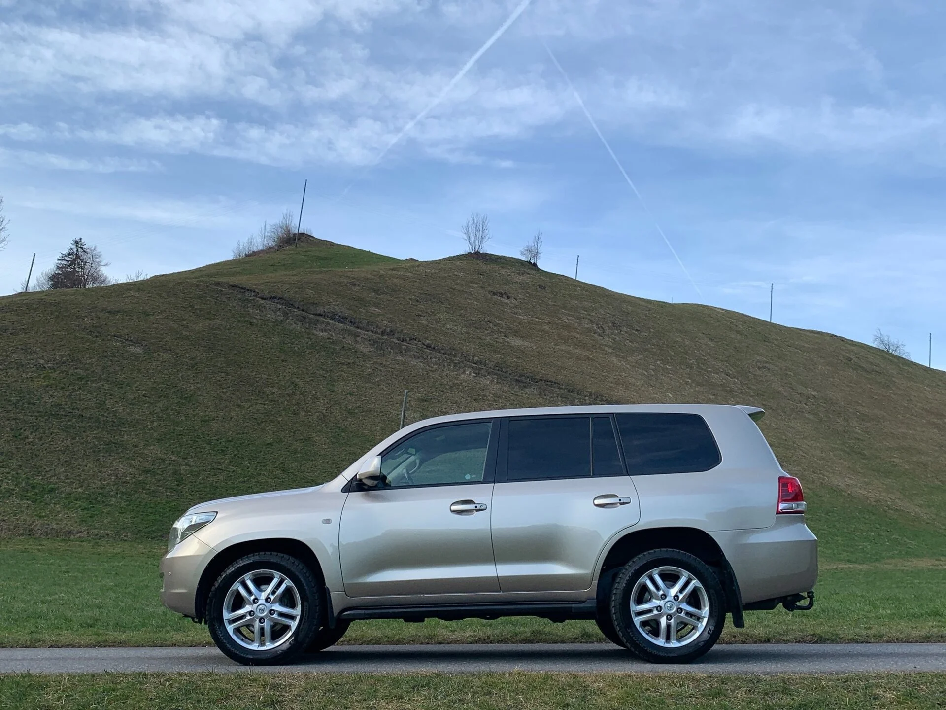

Hello all,
I'm wondering if anyone is running 275/60/20's on original rims LC200 2008 without any modification?
Thanks!

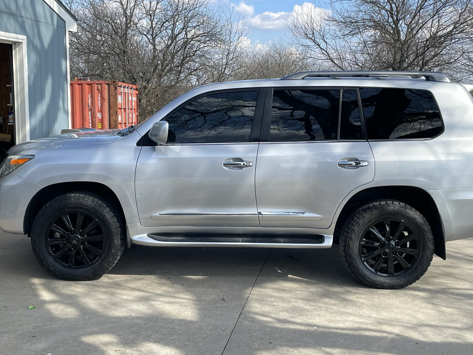

I know it might be a smidge different when it comes to fit- I have an LX. I'm not by my car for any real measurements if needed but will be tomorrow. I just put on 275/60/20 Nitto Recon Grapplers about 5 days ago and love them. I had zero issues but didn't ever go full articulation or anything. Mine's an 09.

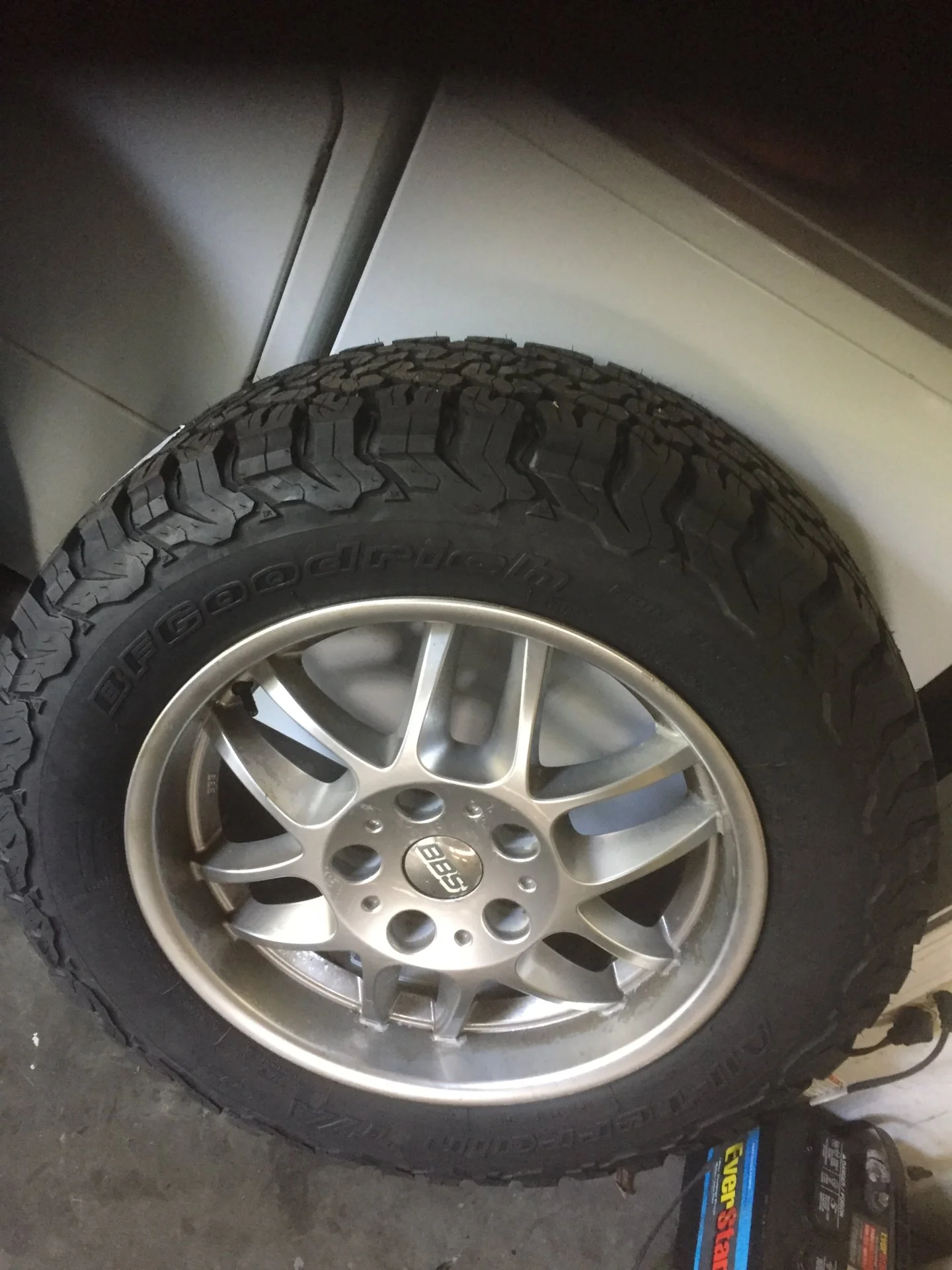

If I'm not mistaken, those are ultra rare factory BBS wheels in 20X9 +40mm. A super awesome set of wheels you have, with a perfect offset.
You'll want to confirm the offset which should be stamped of the backside of the wheel barrel but I'm 95% sure.
A 275/60R20 should fit. I'd caution if you're really taking it off-road and airing down, might be a recipe that easily looses a bead on account of a narrow tire on a wide 9" wheel. I'd recommend a 295/55R20, which should still drop in.

The Tundra XSP package came with BBS 20s that had a +50 offset similar to the rock warrior. They used to be easy to find cheap, but are a bit harder to find these days but still out there. That's probably the closest Toyota wheel to what you are looking for around the US. I think they'd look sweet finished in gunmetal on your truck.
And to the OP, that looks to be right at a 33" tire. No reason it shouldn't work. Very similar to the 285/70R17 Toyota recommended with the Rock Warrior rims.

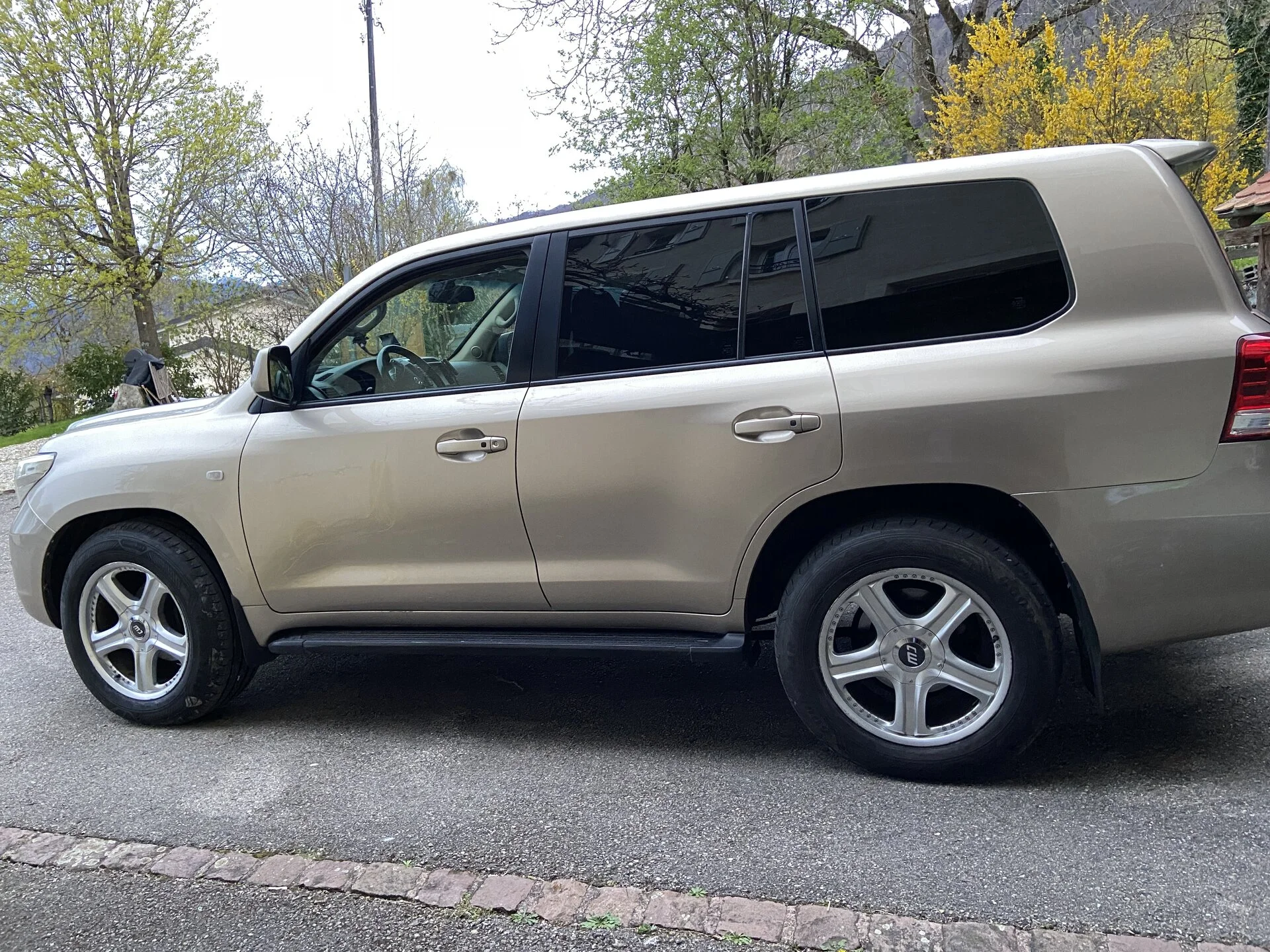

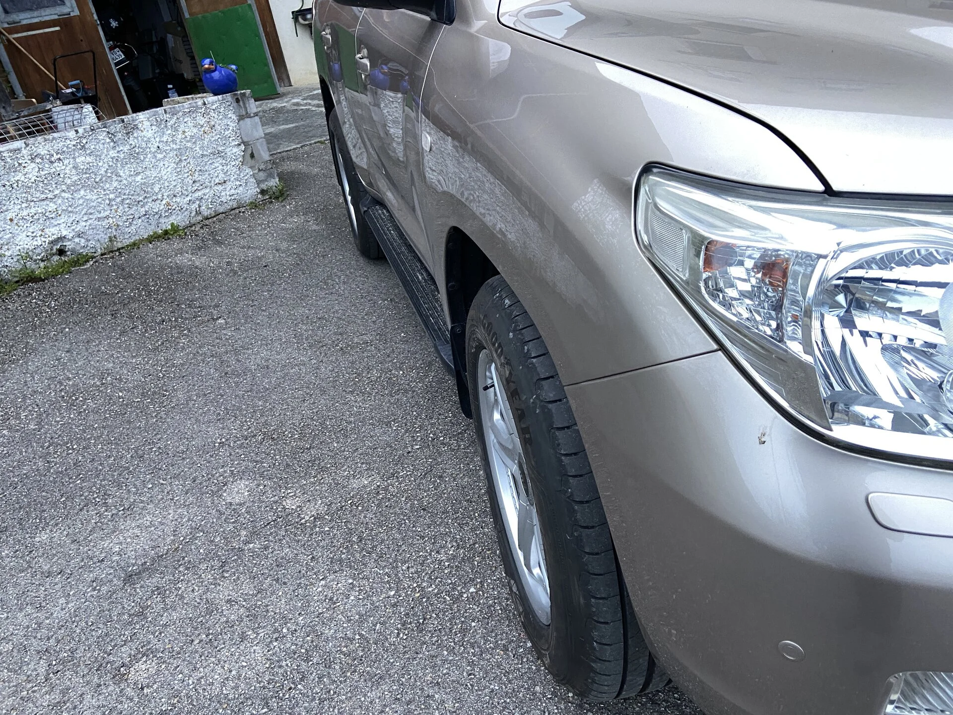

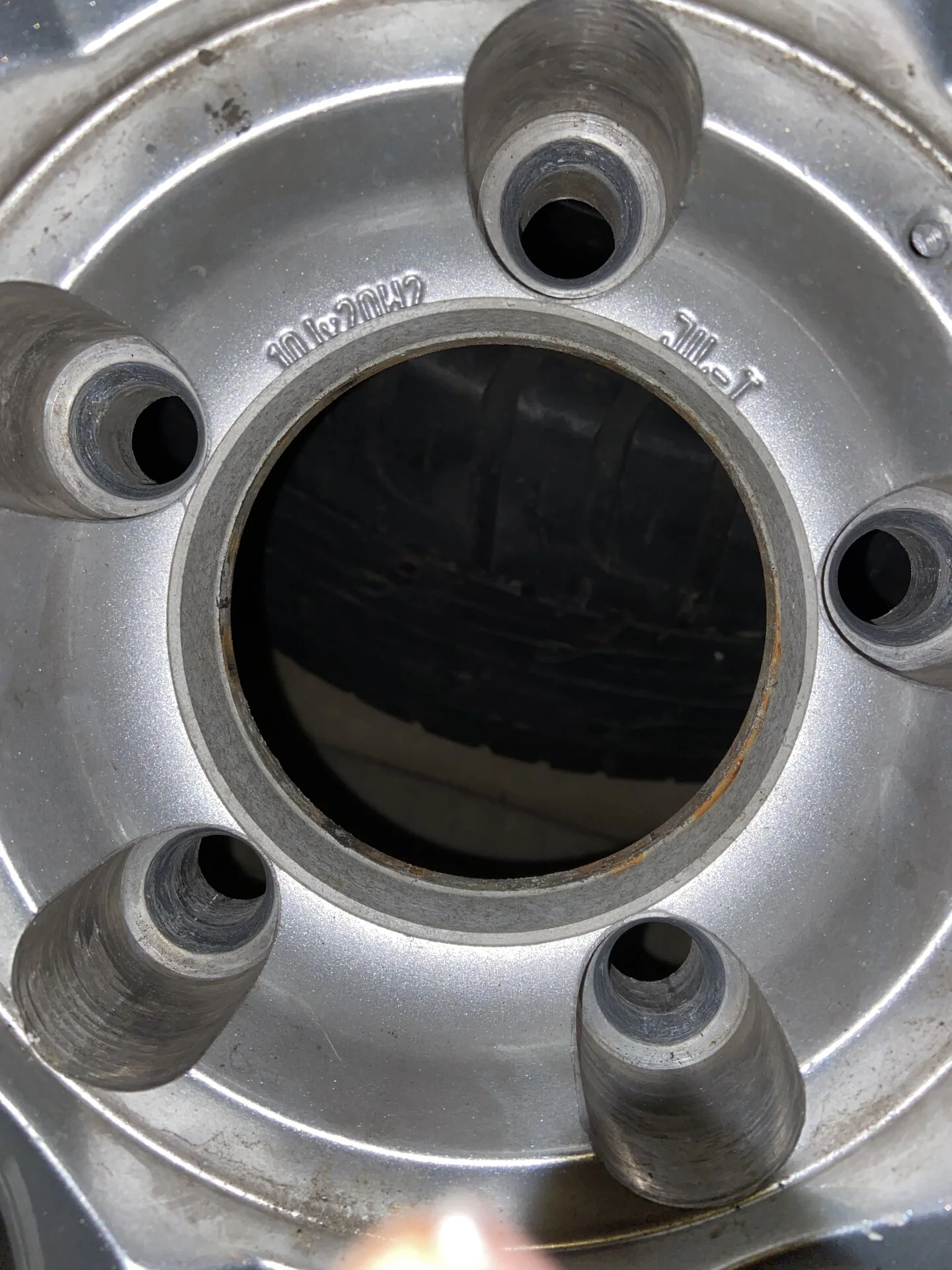

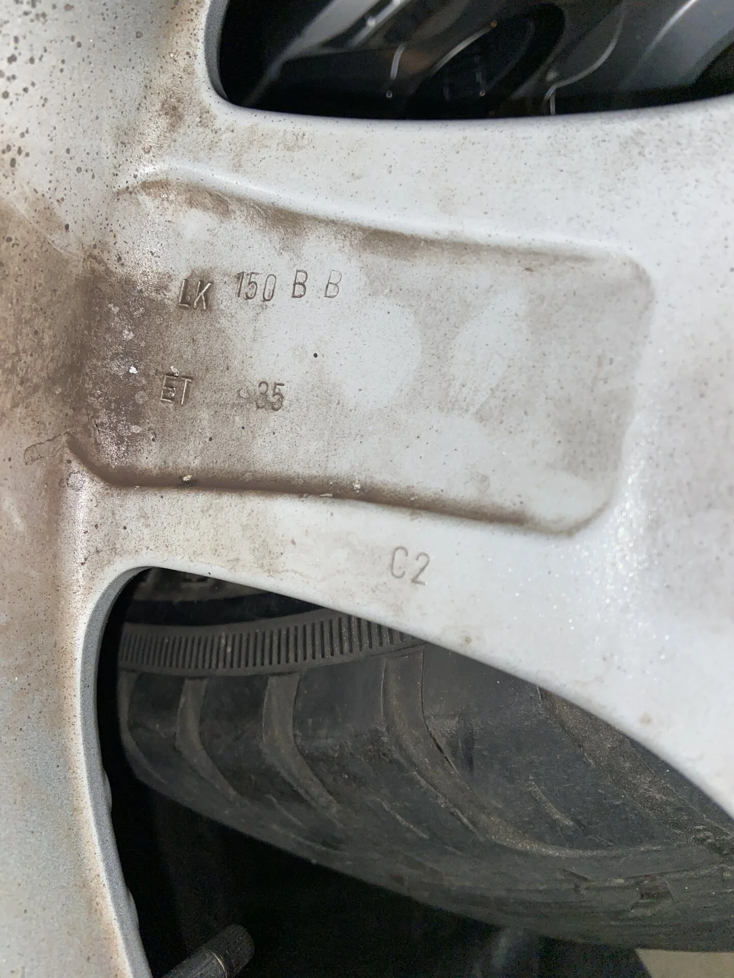

The story is that I have a set of Borbet wheels 10J20 that I mounted today the 275/60/20 tires, I was afraid it won’t fits, but it did, the ET is 35 si it sticks a bit out of the body like 1 inch or so. The thing is that the OE wheel nuts won’t fit this rims, I have to order next week. I will post some pics when all is done. To begin with, I wanted to put the original winter tires 285/50 r20 (the ones on the picture I posted above) on the Borbet’s, but finally I’ve tried the 275/60 and it worked like I mentioned above, I might need to put a set of fender flares now.

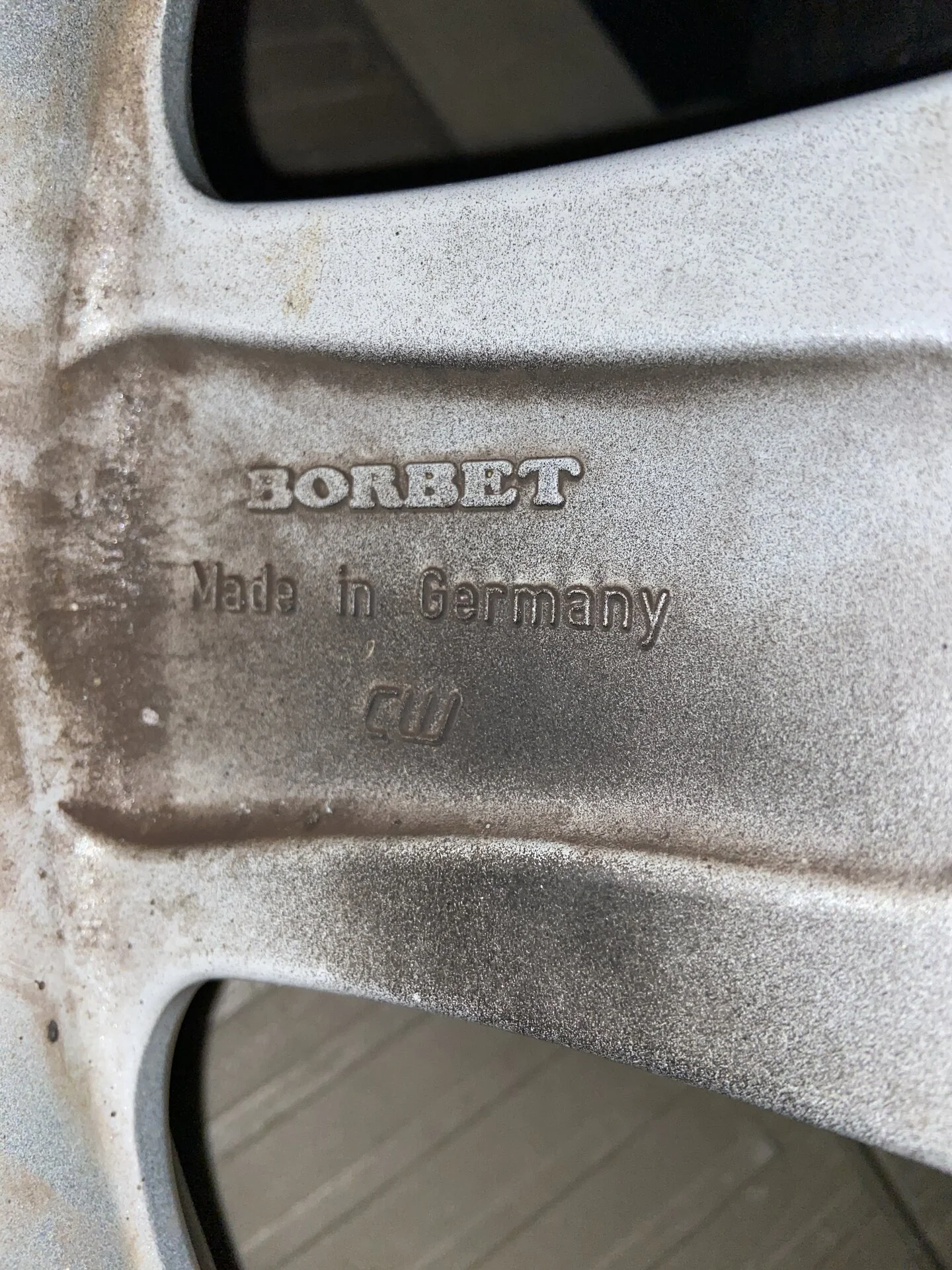

Here are some pics of the Borbet’s.
Finally I have the tires installed. This is how it looks... 275 60 R20 on J10 Borbet
