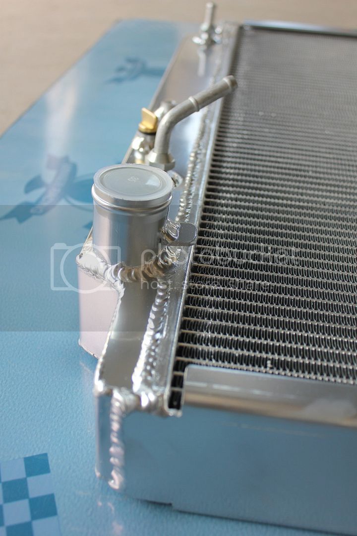

I hate to say it but any American fab radiators made all aluminum to replace the factory Land Cruiser/LX is looking to be around $800 more or less.
I've located a Chinese factory (Winner Racing) that builds 100 series aluminum radiators for m/t but they can add the internal transmission line for our auto trans. My research online shows that they have been building only radiators/intercoolers etc for over a decade and their ratings online are pretty good...
If I can get at least 5 initial interested parties we are looking at about $320 shipped.
This has a larger 56mm core with 2 rows. TIG welded. No epoxy usage. Approx 26 lbs.

So I'm officially going to be the test monkey, they're going to make a one off A/T radiator and ship it next week. I'll post pics of the install once I receive it.
