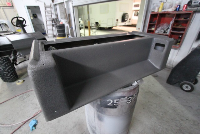

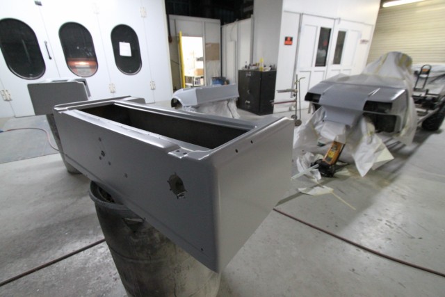

I used the gray Raptor on my golf cart
It's held up fine, but the problem with the tintable kits is that the levels in each of the 4 bottles supplied are not consistent, so even when you add identical drops of tint, you'll end up with a slightly different shade for each bottle if used one at a time :(
Hard to tell in the pix, but each shell has a slightly different shade
That was the first time using one of the tintable kits at my shop.
Since then, if we have to do a tintable job requiring more than one bottle, we simply use a large hopper gun and dump all the bottles in at once so it matches.
