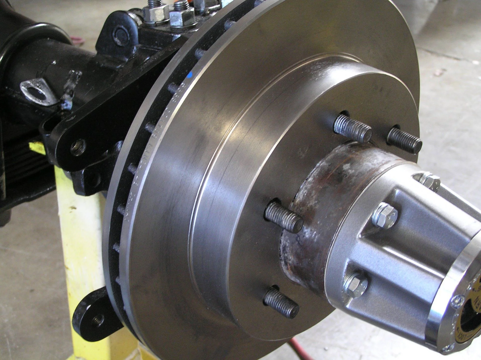

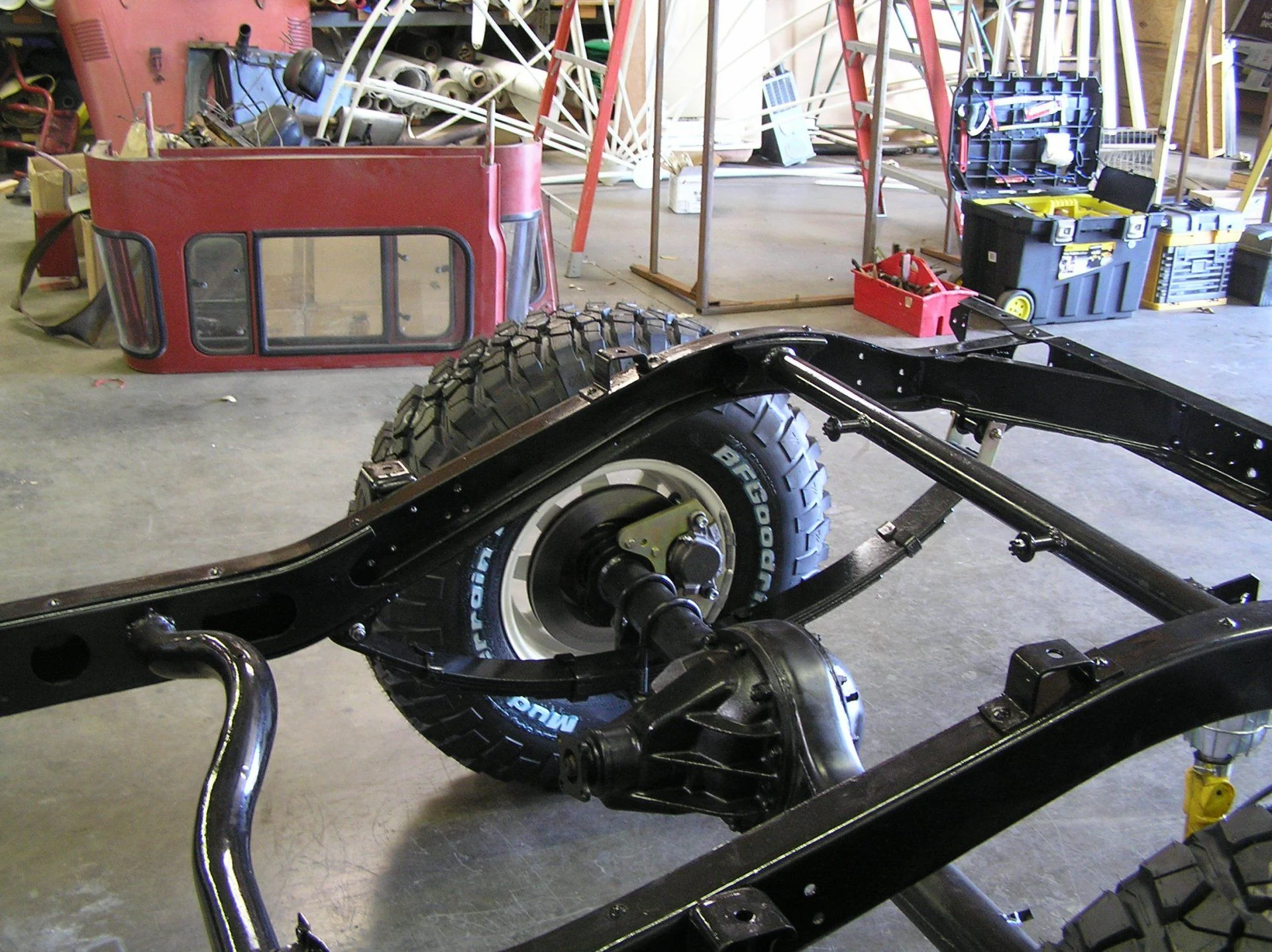

I put them on my 77 eleven years ago and have had absolutely zero problems
