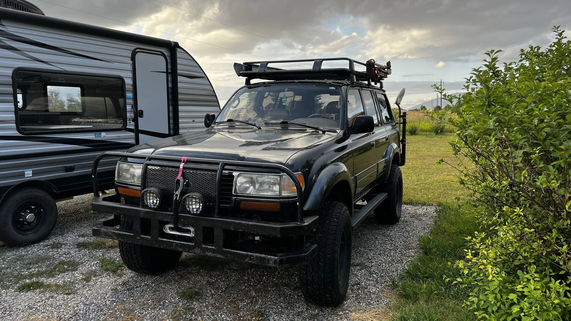

Is that truck green? I work with someone who sold his 80 a while back.
Nope, this is black and is the same color scheme as my 100. My wife said "Did you just buy another LandCruiser that's the same color?". 😂
As Evan said to me the other night, those are some serious "Farm Built" bumpers.
