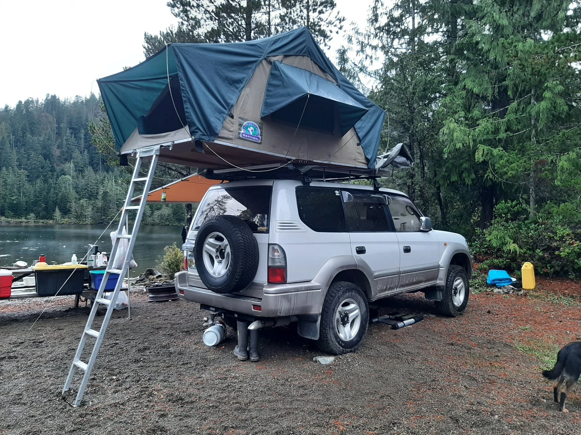

I have the 90 series Frontrunner cross bar/towers set on my KZJ95 and have used it for my RTT for years with no issues. Seems there's plenty of strength there. Don't see a need for three bars.
