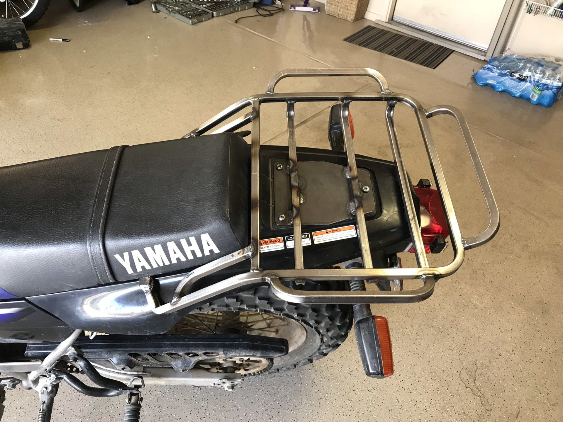

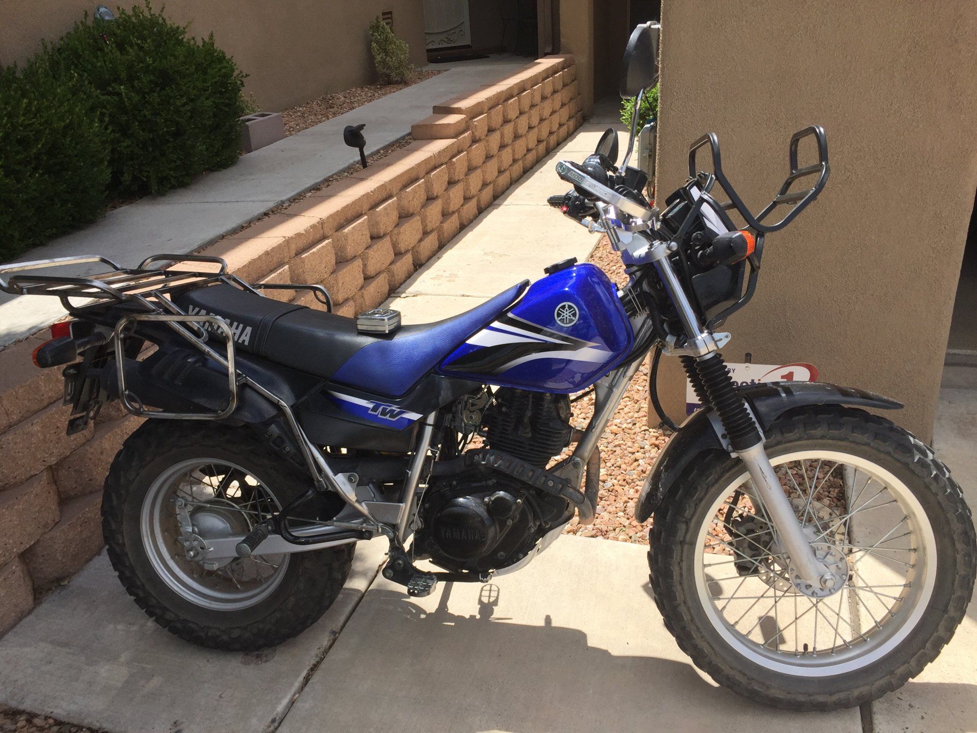

Here are a couple images of my projects.... for grins..
View attachment 1913540View attachment 1913541

Cool projects. Real nice bends.
