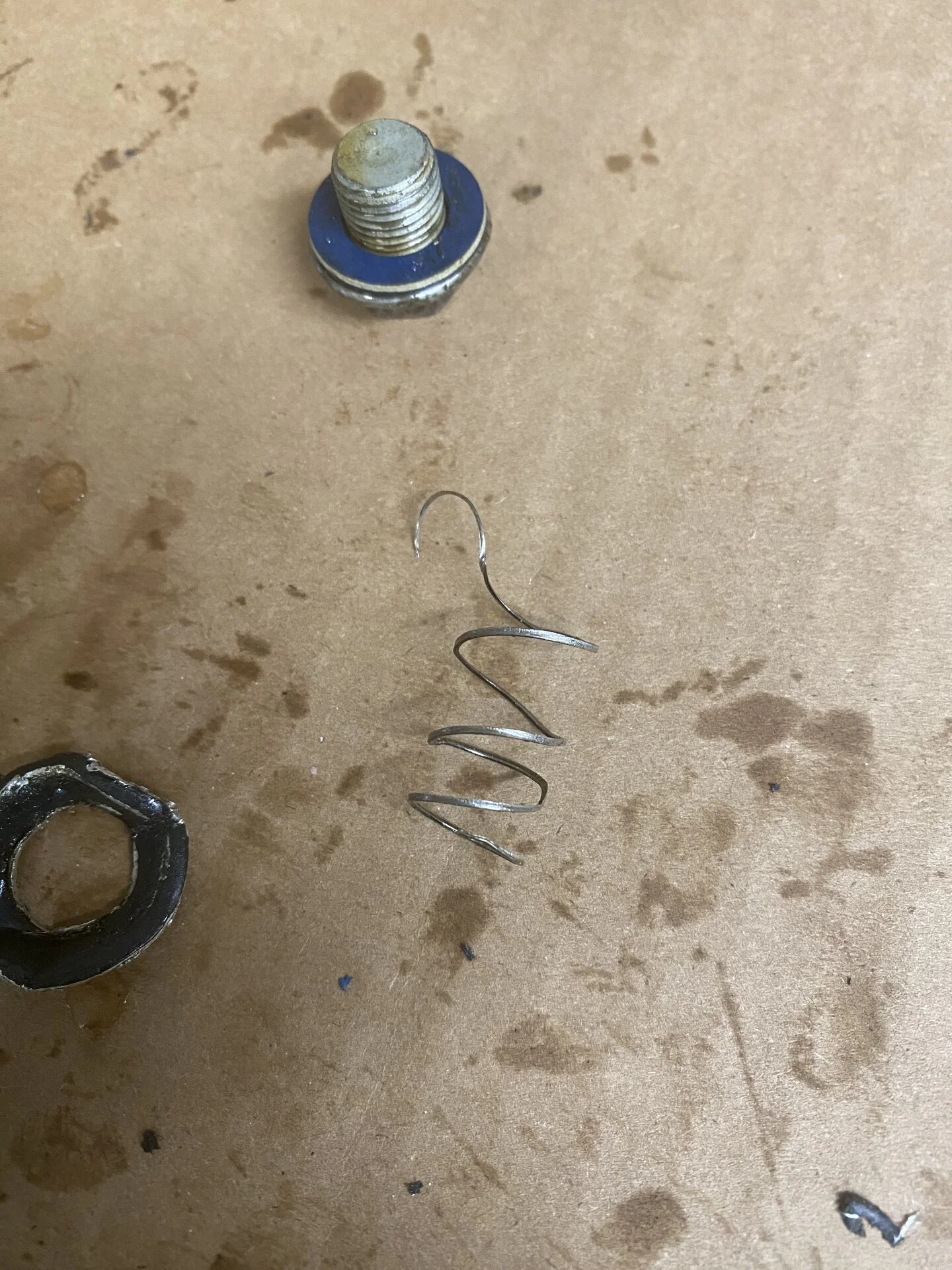

I was attempting to change the oil in our 2008 GX470. When putting the bolt back on the drain hole it just kept spinning. It appears to have had a helicoil on it as something resembling that came out. (The spring looking part in the pic is magnetic so not part of the oil pan).
Is it as simple as trying to put a helicoil back on it and seeing if that will tighten up? It is mangled in the pic bc I could not get the previous washer off the bolt so I had to pry it off with a flathead.

That wire doesn't look like a Helicoil (or any thread repair insert I'm familiar with); it's much too small and is has the wrong cross section. It looks like the threads in the sleeve that is welded into the pan bottom stripped out. Most likely the results or grease monkey(s) tightening the plug so it wouldn't leak, instead of installing a new crush washer.

That's probably not a helicoil, lol.

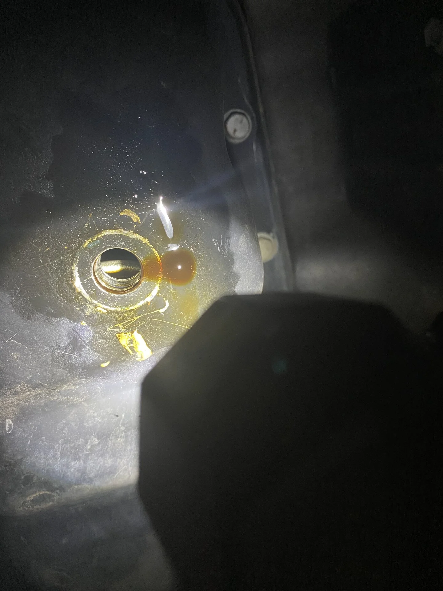

Take a pic of the drain hole in the pan. Are there any threads left inside?
Might not be. Would the threads be aluminum? I’m not 100% sure. Just asking bc that coil in the pic stuck to a magnet. I’ll get some pics in the morning. I’ve been banging my head against the wall all day.

I got under there with a small metal pick and the threads are gone. Will the helicoil still work?
I’m confused on how to get the tang out…it doesn’t seem there is an easy way really. Hopefully a magnet would pull it to the hole.
Helicoil kit will be here Tuesday. I ordered a Fumoto as well…not sure if that can go on with the Helicoil. 🤦‍♂️
You're not grasping what's happening here. There is no tang there.
There was no helicoil. The thing you pulled out was not a helicoil, it was the original threads. They got pulled out from over torqueing the drain plug. Like Fred said, lube techs or someone else probably installed the drain plug too tight too many times, and you putting it on this last time was the last straw.
You're going to have to run a tap into the pan's threadless drain hole to cut new threads so that you can install a new helicoil. After that, you can install a new drain plug and sealing washer. That or replace the pan.
