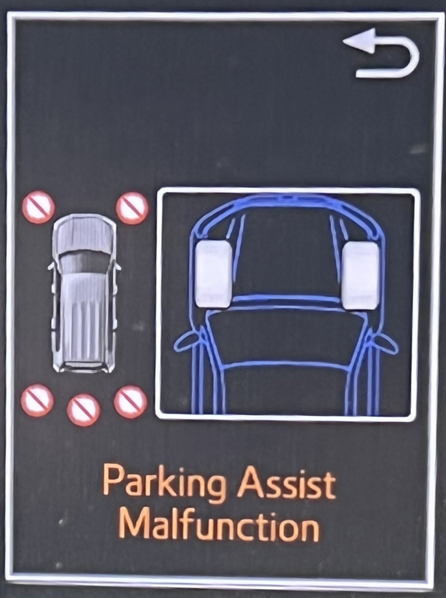

Hi All,
Has anyone successfully disabled the parking sensor system?
My rear sensors are gone, sensors, harness, everything. No errors.
I was offroad, went through a muddy hole, and got a warning message that I couldn't get rid of.
I tried unplugging the harness, but the error message persisted on the dash cluster.
While the error was displayed, I could temporarily get out of the error, but I couldn't stay on any of the other screens, it would revert to the error after a few seconds.
I finally figured out it was just caused by mud on the bumper mounted sensors.
I'd like to remove and plug the holes, but I need to disable it from giving that warning.
Is there anything that I can do in Techstream to permanently disable them?

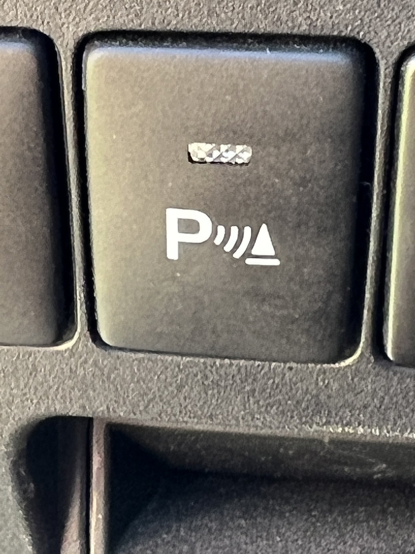

my 08 has a button next to the Headlight Washer/12V switch - I keep it off since I installed the Dissent rear bumper and no warnings on the dash.
was curious and just went and turned it on - constantly beeps, sensors are flashing on dash and I have an "!" warning light
Yes, this solved the problem quickly and easily. I blocked the sensor with painters tape to simulate the mud covered condition and it triggered the error. I pushed the switch and it all went away.
I would still like to code them out, remove the sensors and plug the holes though, so if there is a way to disable them in software, I'd still love to learn more.
There are so many "features" that I don't use and wish weren't installed, this is one of them. I can park a car. :)
Definitely able yo switch them off. Look in manual, but on my 08, its a dedicated switch left of steering wheel.
I turned mine off within a couple days of ownership bc they drove me crazy. If I eed another button soot? I’ll probably permanently remove my parking sensor switch…
