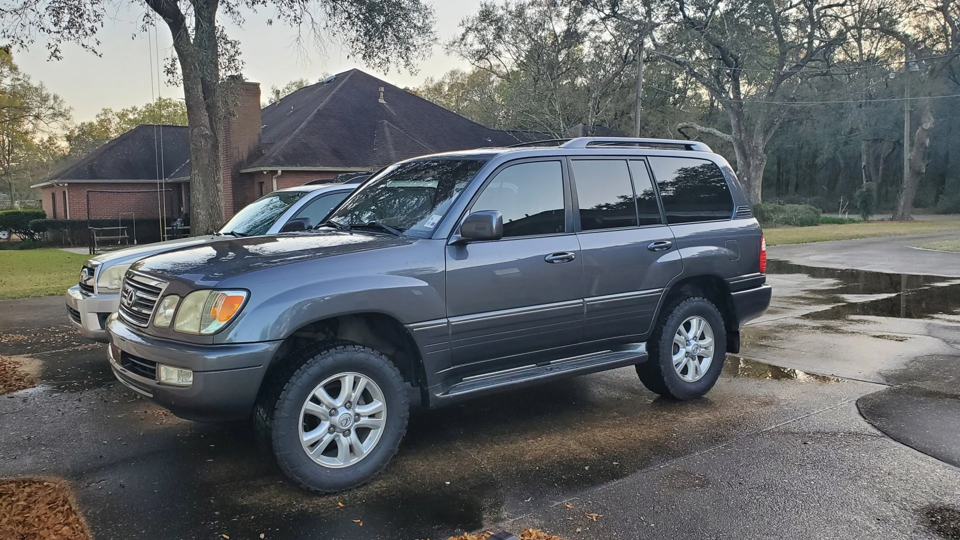

Here is a photo of it! Picked it up like 2 or so months ago.

Edit: I'll get another photo posted when I get the shocks installed so people can see the OME lift with OEM shocks.
