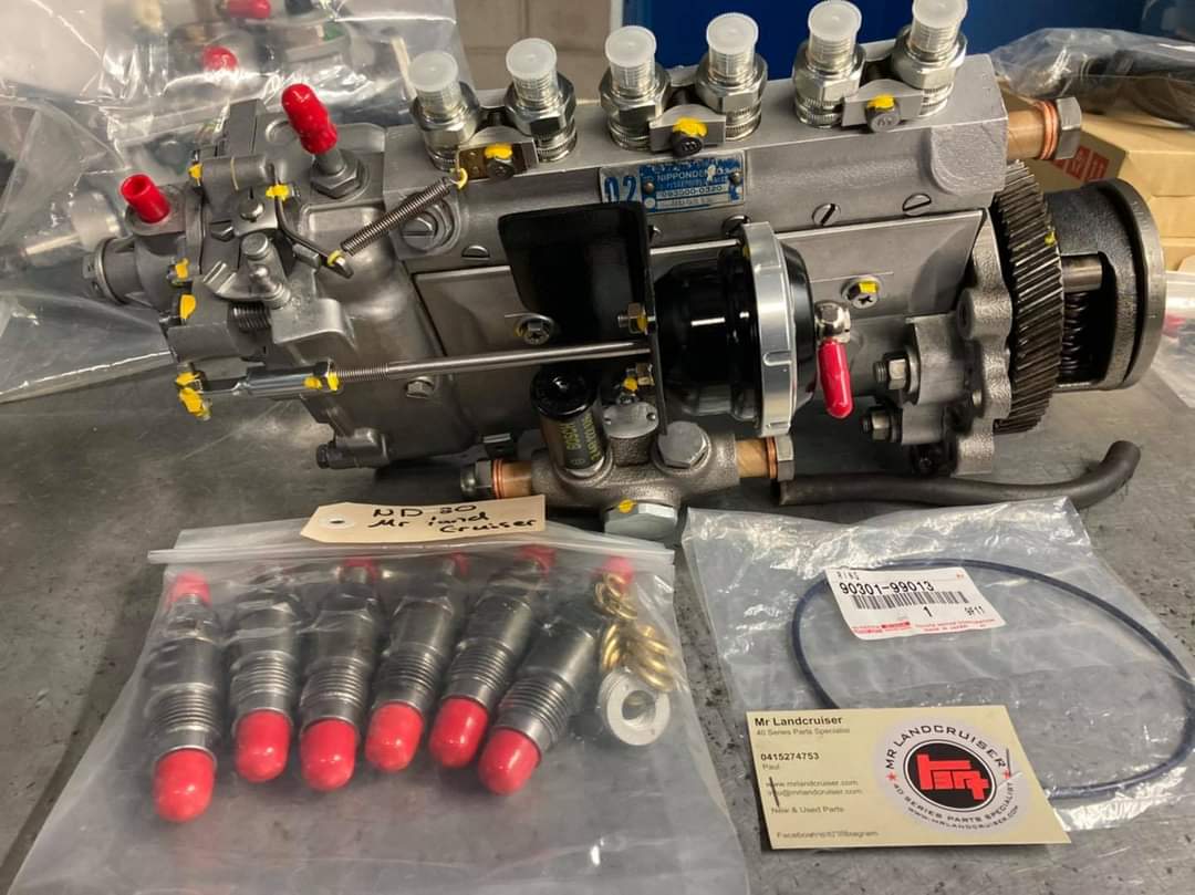

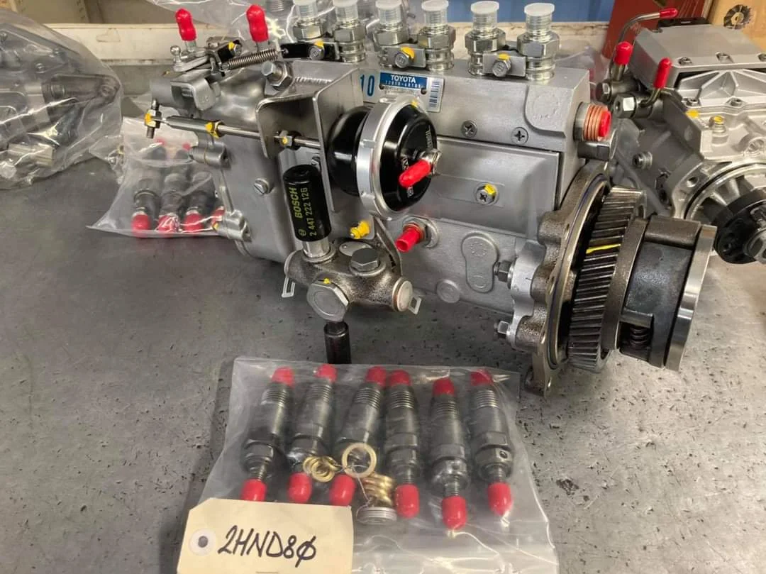

Lol you guys don't want to see the 2H race pumps that JH Hilux builds for these then 🤣
Yeah he's been doing that for years, and yes they can make decent power as evidenced by many clips of said 2Hs on the drag strip. Not the sort of setup thats built for long term reliability though, short term fun is where there at. I think those are kinda cool but not what the average Joe wants to do when turboing the 2h.
