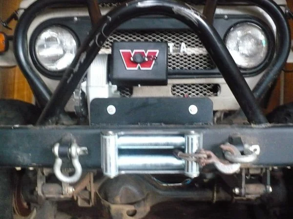

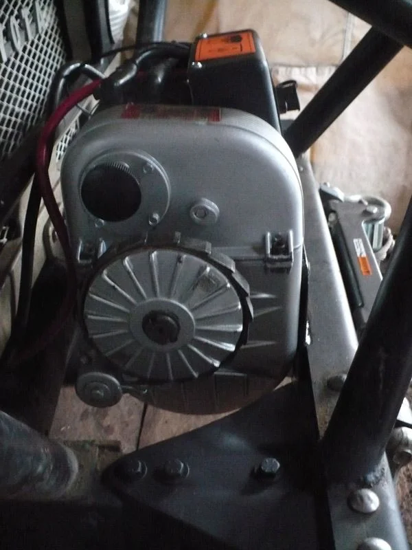

I picked up a 1970's era Warn 8274 off Craiglist for $175, in order to put the M8000 that was in front out behind the rear bumper.

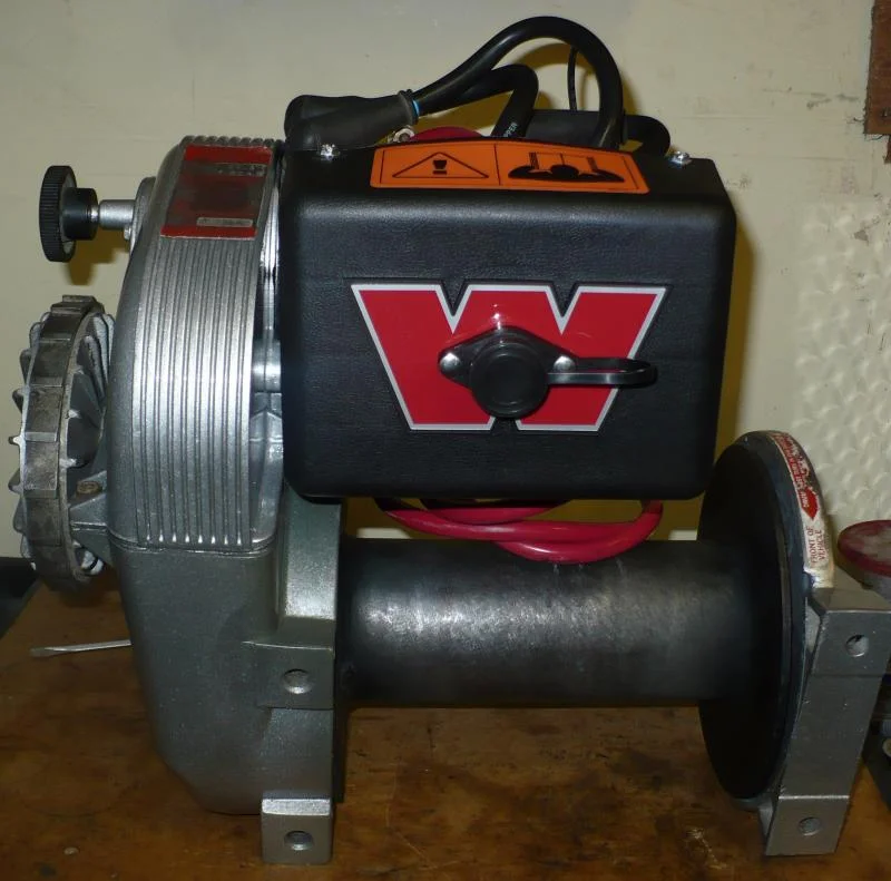

I installed a new brake and lower housing kit and new oil after cleaning out the old gunk. I also upgraded to the newer style solenoids, as the existing power pack was missing a cover and the remote.

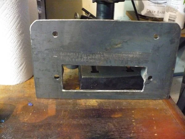

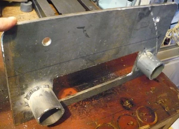

After buffing it down, I gave it a couple coats of aluminum rim paint, followed by a couple coats of clear to make it nice and pretty. Finally, I had to modify the "Hell For Stout" front bumper to work with an upright winch, and make a winch plate to get everything mounted up. I'm happy with the end product, and hope I don't need to use it!
Here's pics of the mount:
Here's pics of the winch, after the rebuild:
Finally, pictures of everything mounted up:

The new solenoid upgrade (4 solenoids, mounting bracket, cover and remote) I think ran me ~$200 bucks? I'd have to track down the receipt to say for sure. The new solenoids also work with the remote kit that Warn sells, which is something I might get at some point. The brake kit was ~30-40 bucks, and the lower housing kit was ~$75.
As mentioned, there are some very nice write-ups here that I used as a reference for rebuilding mine, there's a good one in particular that originally showed up on Pirate. I wouldn't have spent the money on the rebuild if I hadn't gotten such a good price on it initially. If I had paid what they usually pop on on Craigslist for, $500-600 bucks, I would have more likely just used it "as is". At least now I'm a bit more confident in its condition.
