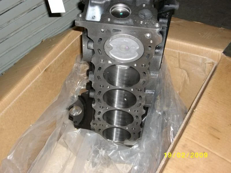

My major issue today involved the removal of the torque converter. The FSM states you pull the TC by unbolting it via access thru' a 'hole' below the flywheel. The issue is that you have to rotate the engine to get to all 6 bolts. I cannot rotate anything since it's all siezed up !
My plan right now is to unbolt both the small and large oil pans and then tip the engine upside down. This will then allow me to access some of the TC bolts. I might have to loosen/remove the crank so that I can rotate everything and get to the remaining TC bolts.
The lower oil pan was disgusting and filled with a gooey, brown, syrup type liquid. It smells foul and I can see a great deal of time is going to be spent on cleaning everything: hours and hours will be spent just cleaning and trying to get back to virgin material !

Finally seperated the large oil pan from the block. The usual disgusting muck and filth was everywhere and the smell, kinda like a bad burnt, fleshy smell: kinda kreepy ? I also managed to get at three of the TC bolts but the others are buried behind the block so that going to be tomorrows improvise session.
Since the pistons are going to be well and truly stuck in the cylinders, I filled all the holes with a great deal of PB Blast hoping that it will seep down the cylinder walls overnite and 'unstuck' them a litttle. Wishful thinking but we'll see what tomorrow brings.
