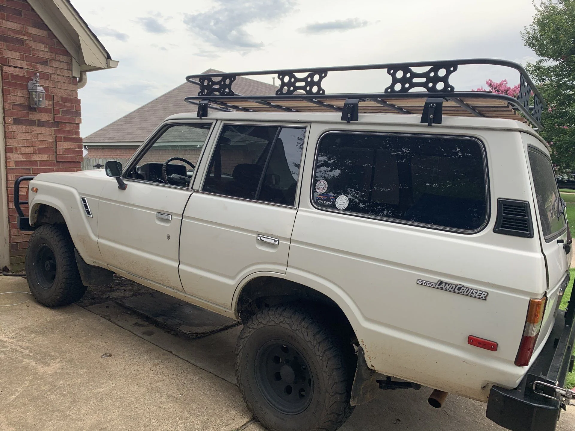

I figured I would show a little about how I made my roof rack.....maybe it will help someone move forward with theirs.
first my design. I love classic wood look. So I wanted to try and use some wood slats on the rack.

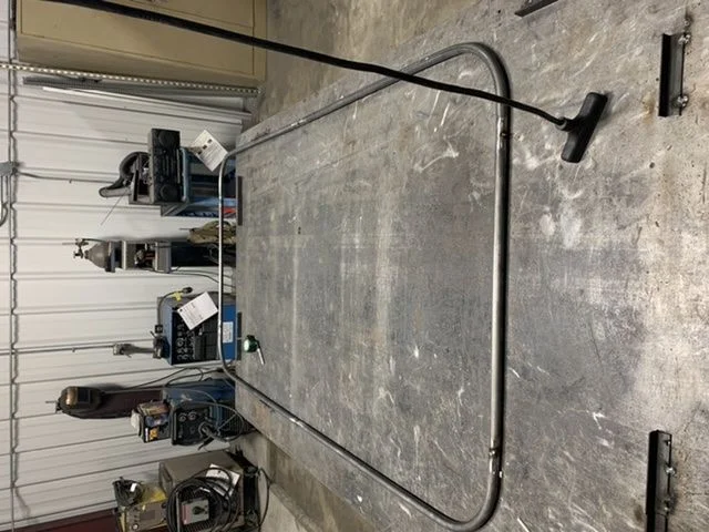

I made a section on the table to try and keep everything square.

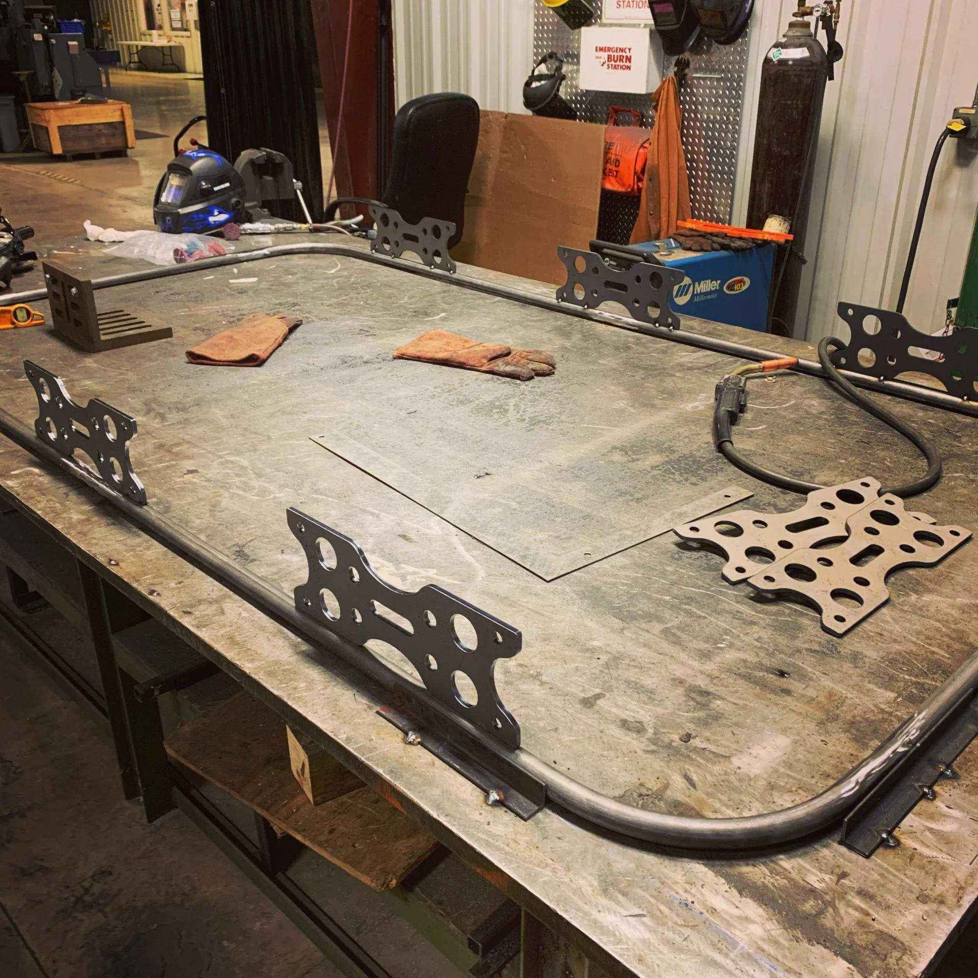

Racked up some of the brackets on the bottom frame.
added the top frame then welded all the way around.

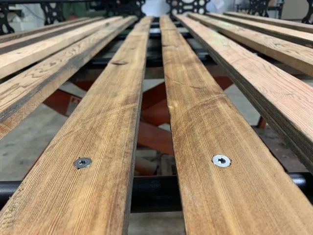

next I cut down several 30 year old Cedar fence post from a scout camp. I didn’t finish finish them, just ruff cut and left live edges on them. Afterwards I piled them really well.
