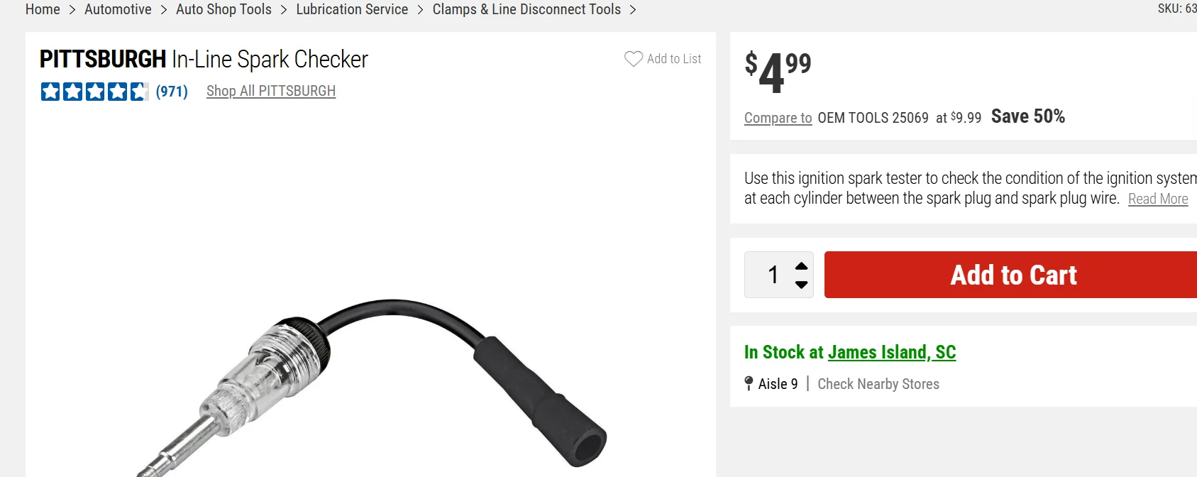

you'll have to verify if you are getting fuel and spark. I would try a cheap-o spark tester
