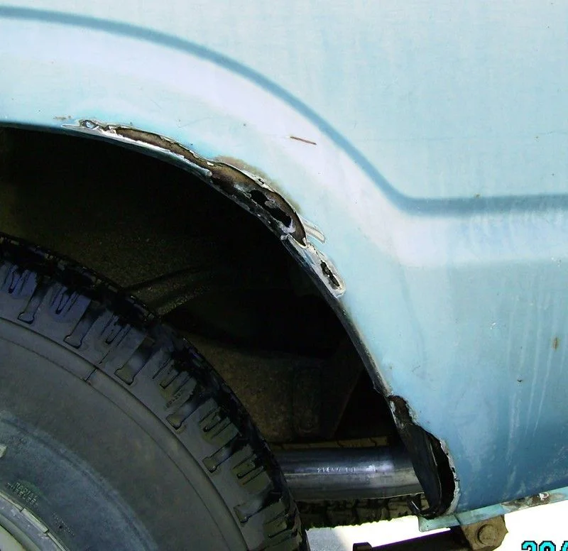

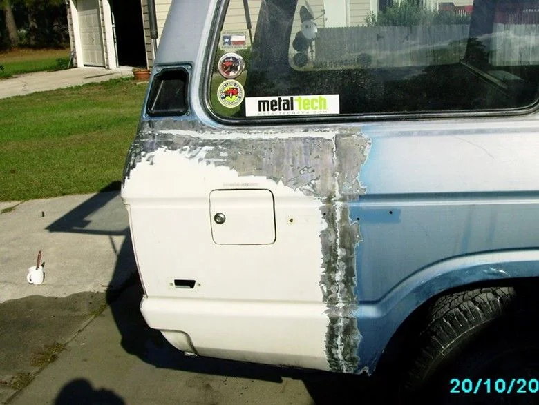

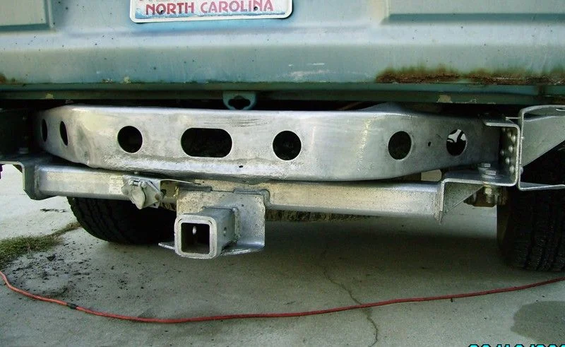

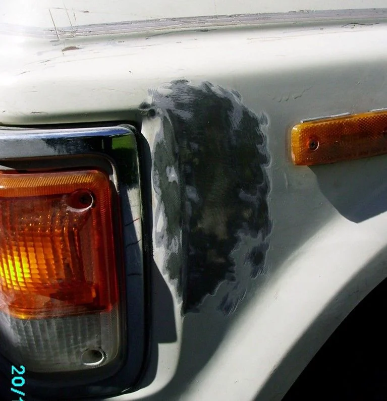

Got some work done this afternoon:
Got rid of all the fiberglass and treated the infected areas with marine clean, metal ready and POR-15 (2 coats so far)
I dont know what I am going to do yet about the wheel well. I am not that good with a welder but I am going to give it a shot.

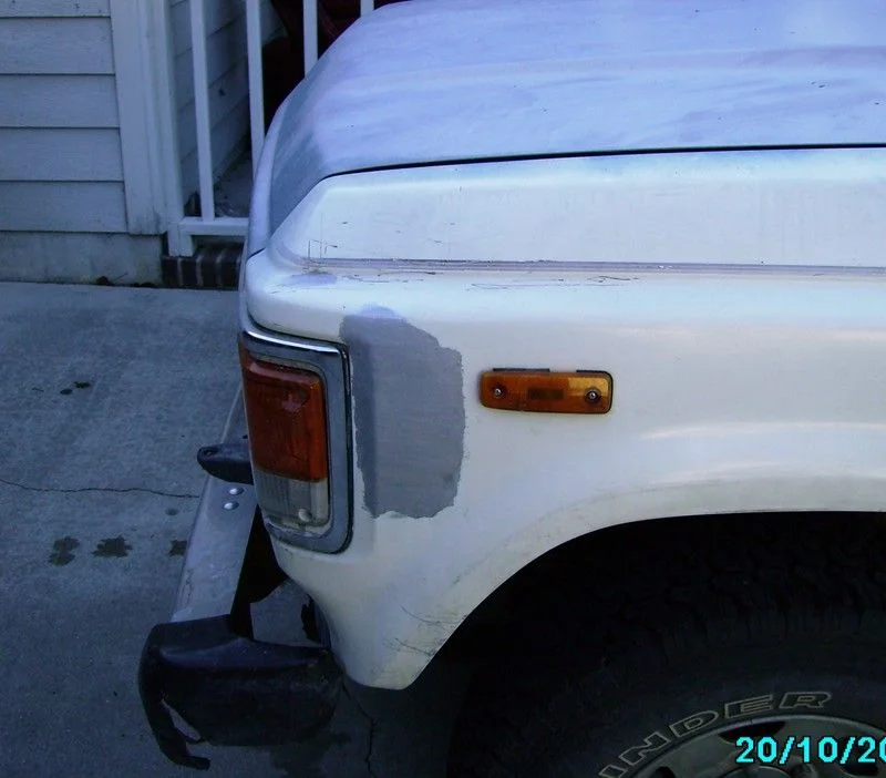

last one for now
That tail gate needs some serious attention, if anyone has a rust free bottom tail gate for sale please let me know.
