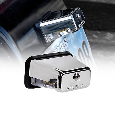

I know these aren't the prettiest, but has anyone used these for license plate lights?
or these.....
I actually like the Hella's.
This is the one I really like, but they are NLA
And another....
One more....
Amazon product ASIN B00G27NVT2
Another....
Are your lights MIA?
My lights were basically chrome plated rust, so they weren't salavgeable, but I found a good set I had set asaide for my '79, but now I need to find a good set for my '79. I may just order them off eBay, but I can't pull the trigger yet.
