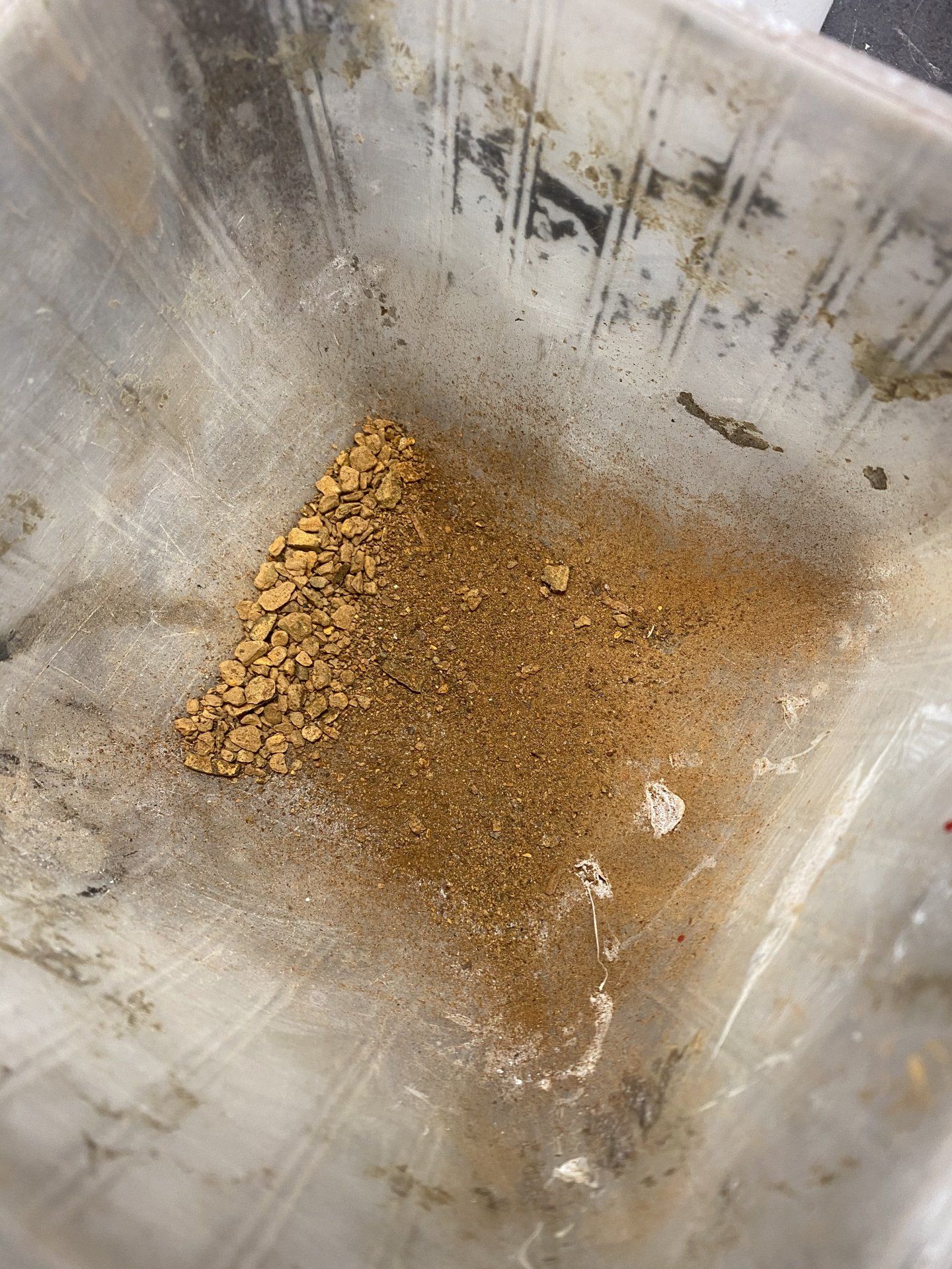

I also was testing the switches on the dash and found that my rear heater was intermittent, I could push start the fan, and it would run, but if it sat for more than 10 seconds it wouldn’t start back up. So I decided to take the blower motor apart and see if I could see anything obvious. As you can see by the picture the problem was obvious. I cleaned it up, greased it, and put it back together, everything works great now.

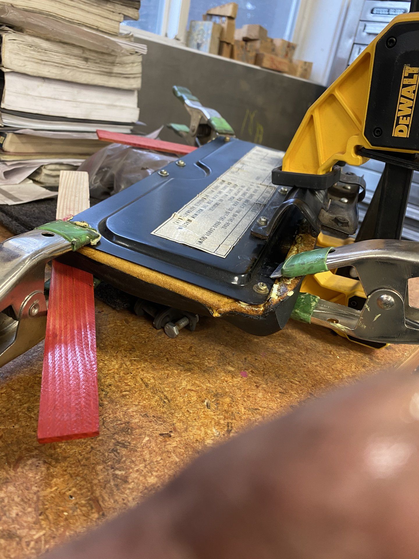

Got a few more things done today, nothing overly exciting, but at least it’s progress. Played around with some expand a foam for dash repair, worked great. I wish I would have had a before picture, but I couldn’t see the gauges since the vinyl was warped and pulled away from the foam, but after some strategic placed paint cups and clamps it seems to be a pretty solid repair. I also cracked into the tailgate regulator and motor. The gear is broke, but still in working order. I’d love to find a replacement before I put it back together.
