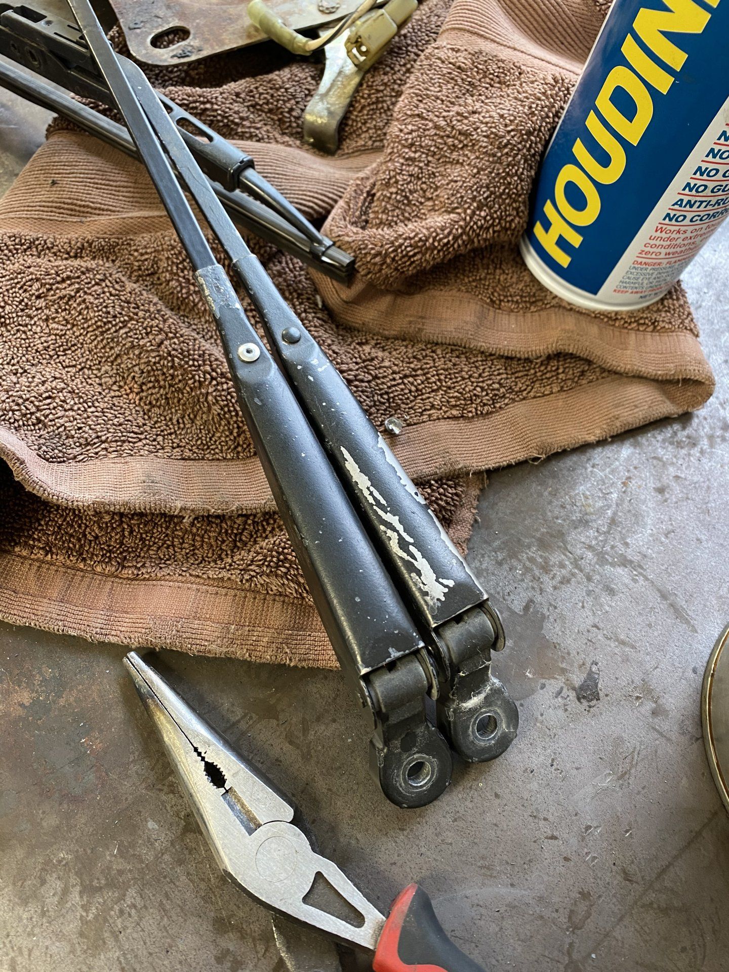

Well, learned something today, I bought two wiper arms from a 76 55, and found they aren’t the same as a ‘78. It looks like ‘77 to ‘80 would be the same, again back to the drawing board.

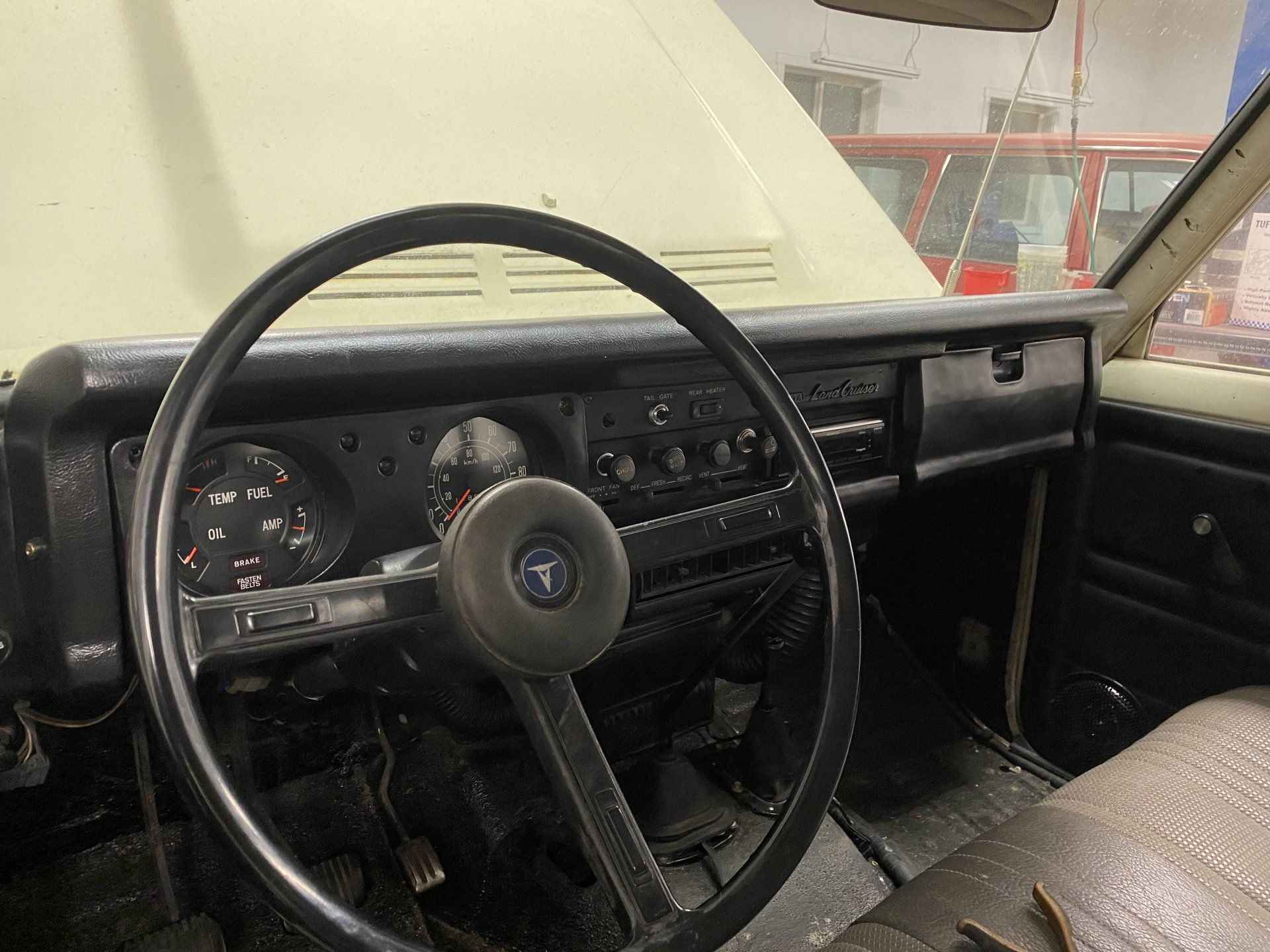

I did get the dash put back together, I found LED’s to replace every dash bulb. I’m really happy with the results. I also painted the needles and refreshed the gauges while they were out.

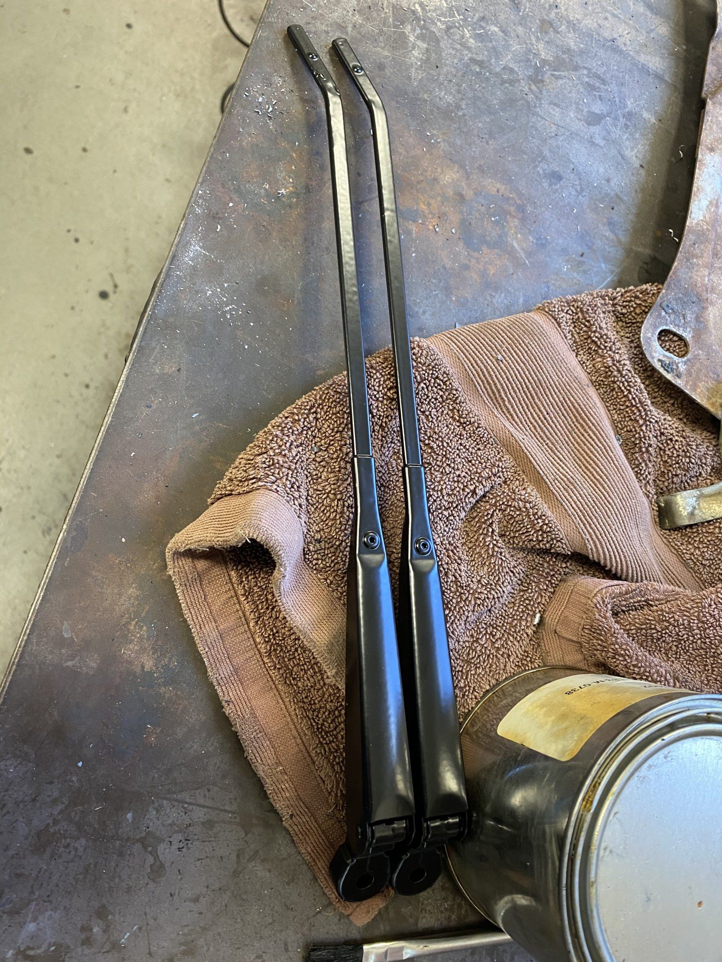

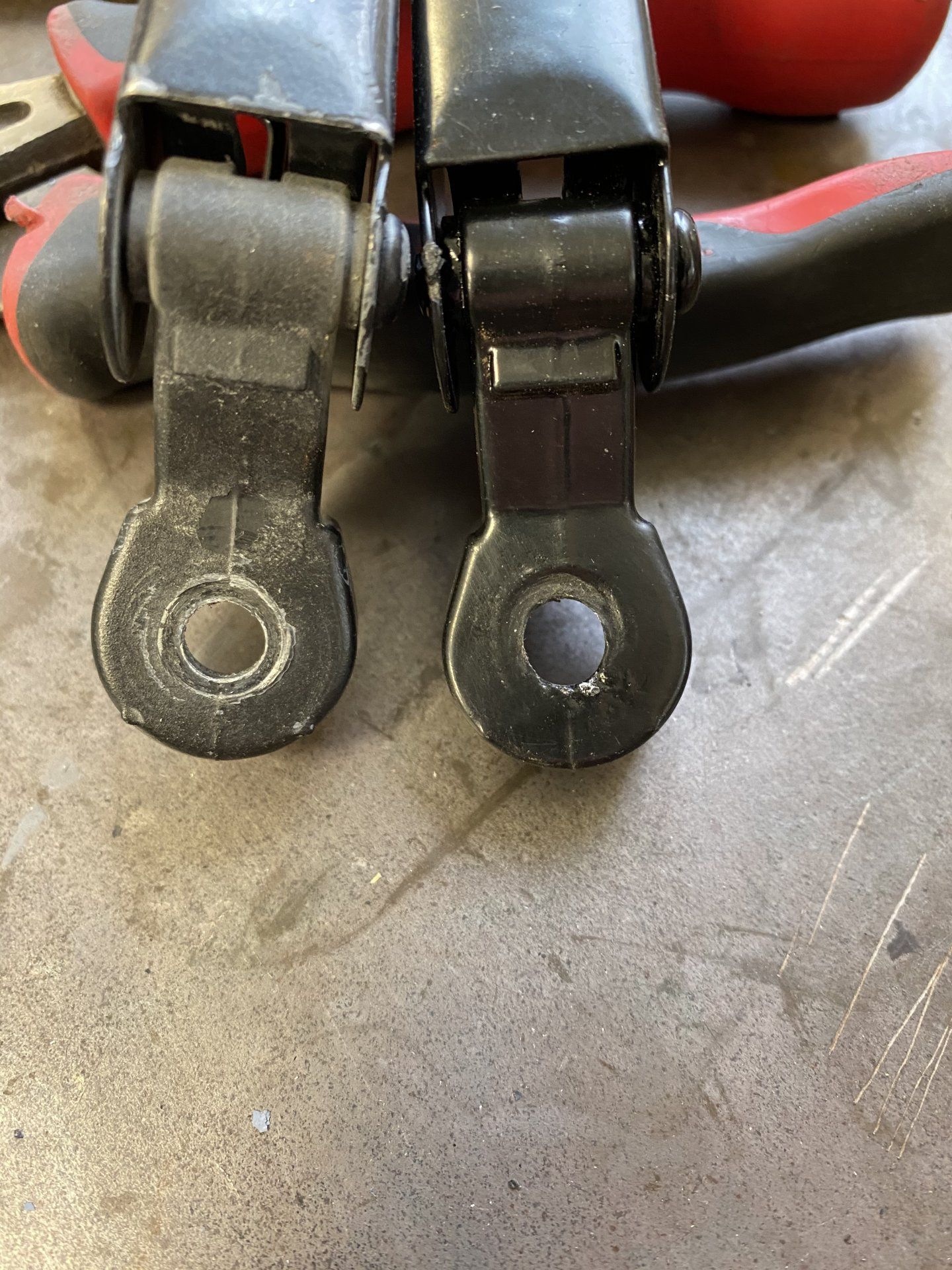

So since I still haven’t been able to find replacement wipers for my year I decided to merge some good used 40 series inner arms with my 55’s outer bars, worked great should be a permanent fix. You can see the wallowed out hole that made the original ones no longer work. 60 series, along with 40’s, have the same size mounting hole as the later 55.

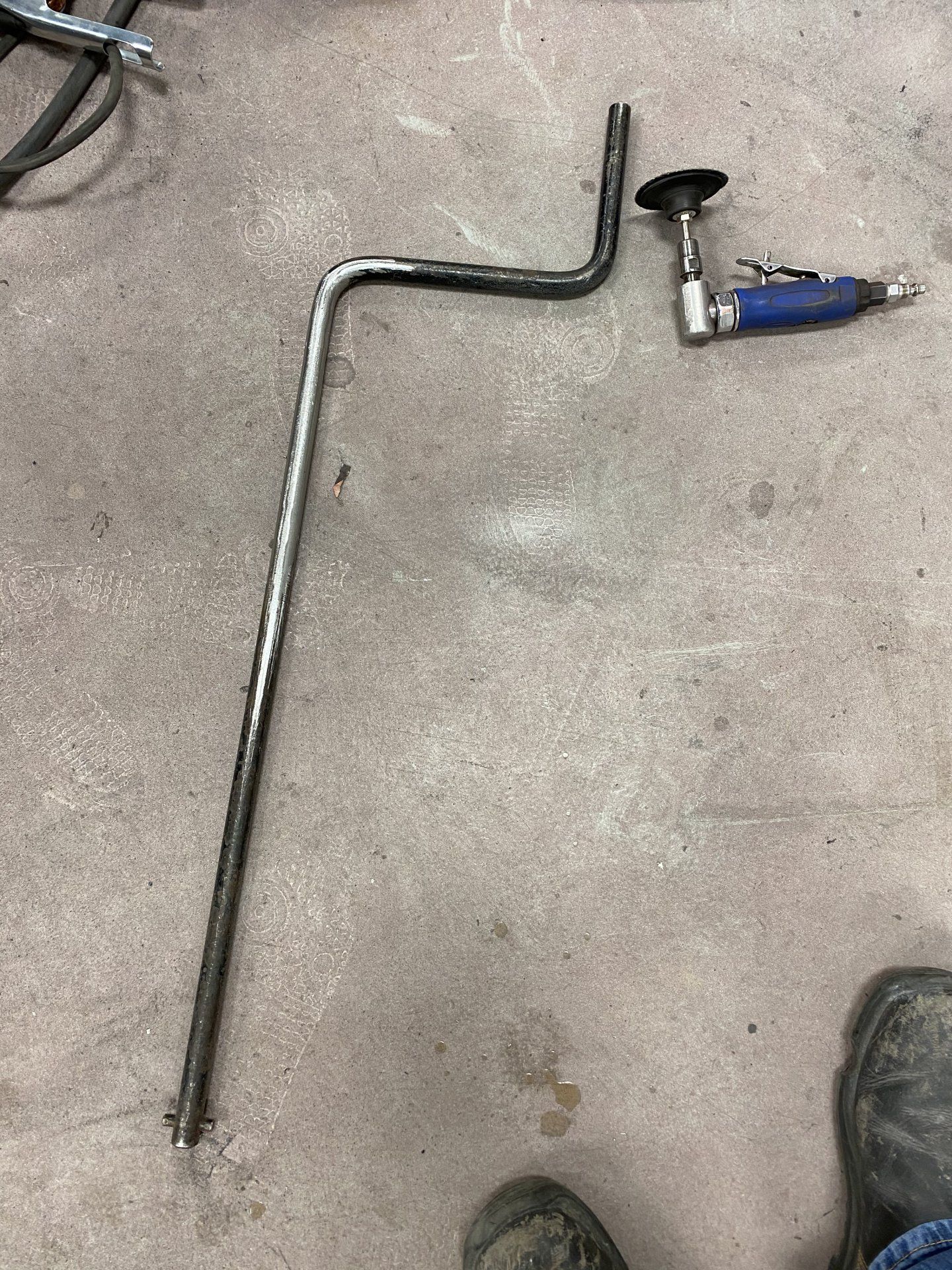

Luckily I had the bar for lowering the tire, although it was cut in half. Pretty simple repair, but another step done.
Nice repair on the handle. I'm sure you already know this but that handle can also be used for cranking the engine. Not that anyone with a battery would ever want to do so.
Yeah, I watched a video once where someone did that, I might try this one day just for fun to see if I can get it to work. Maybe I’ll video it so everyone can laugh. 😁
