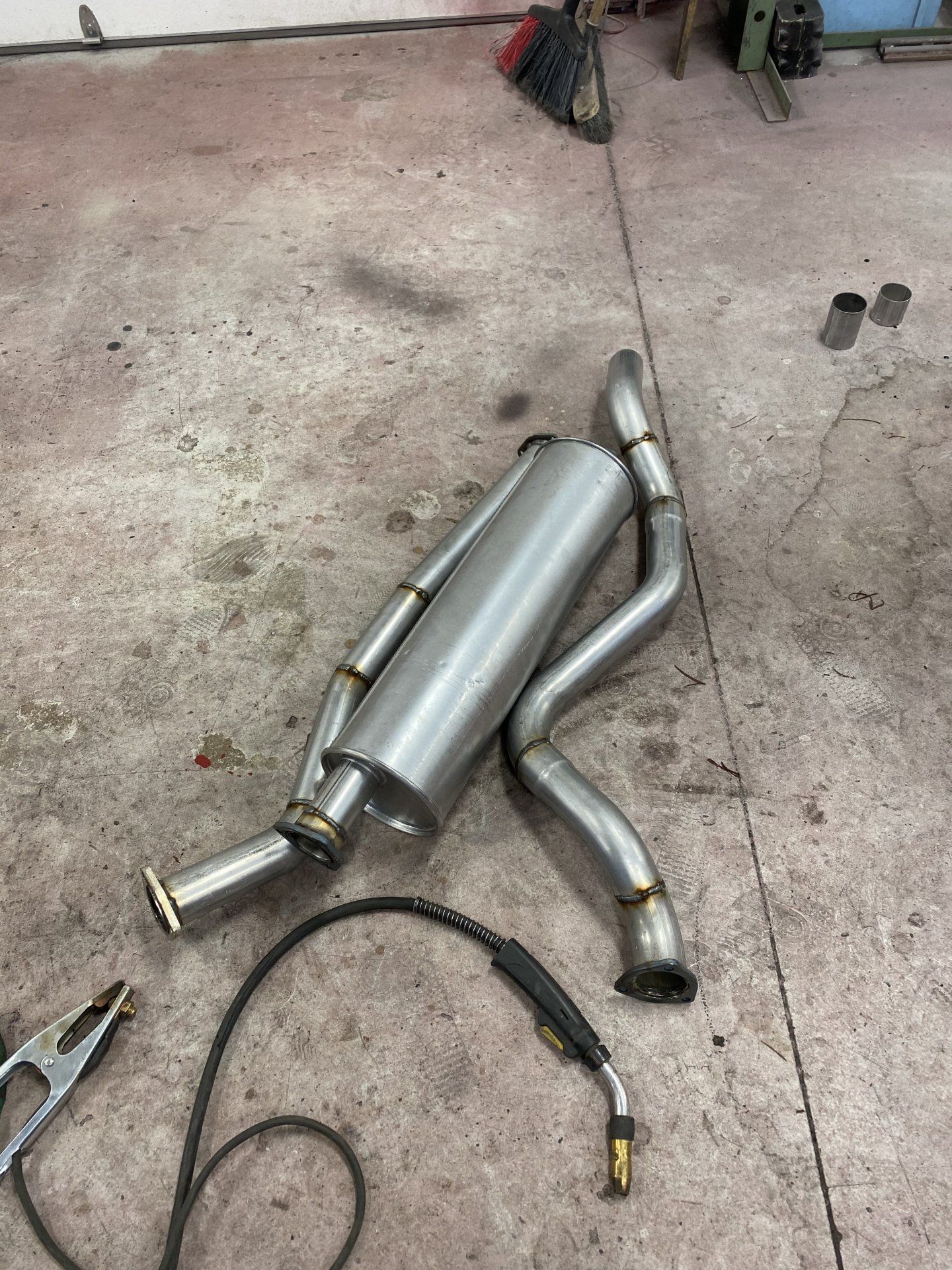

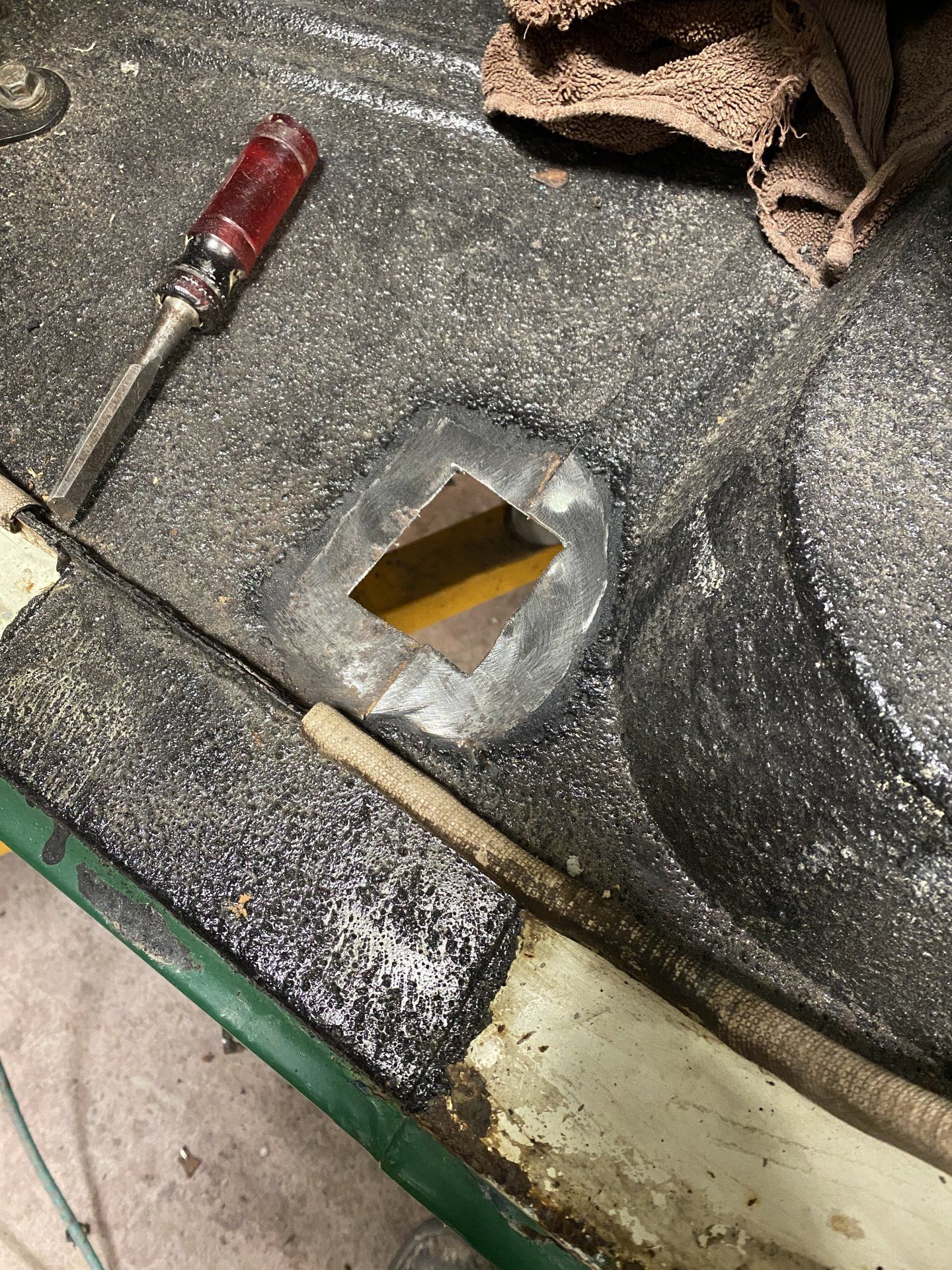

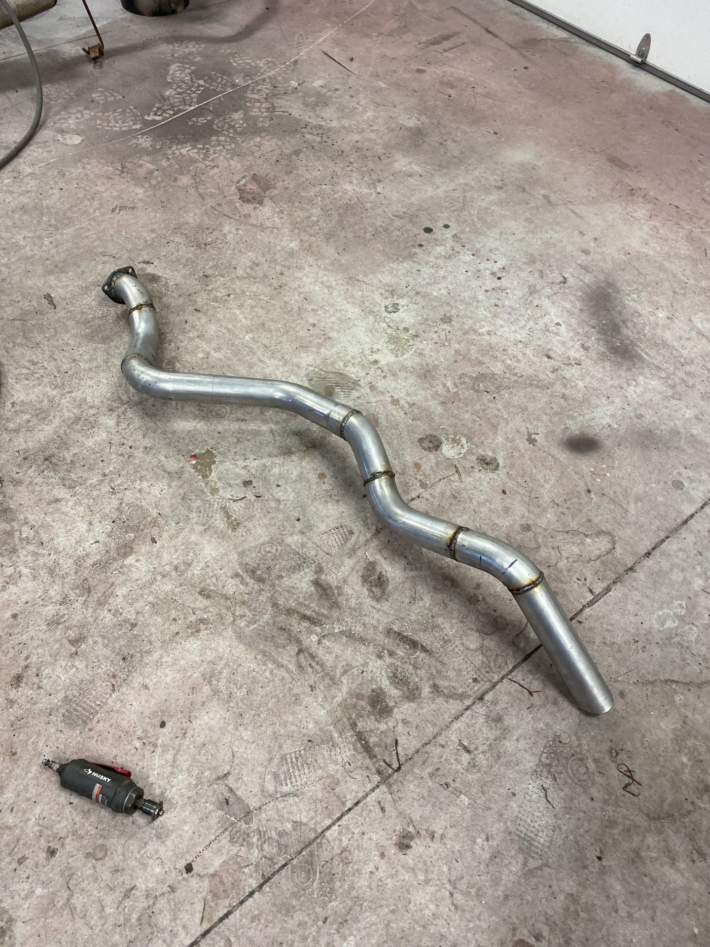

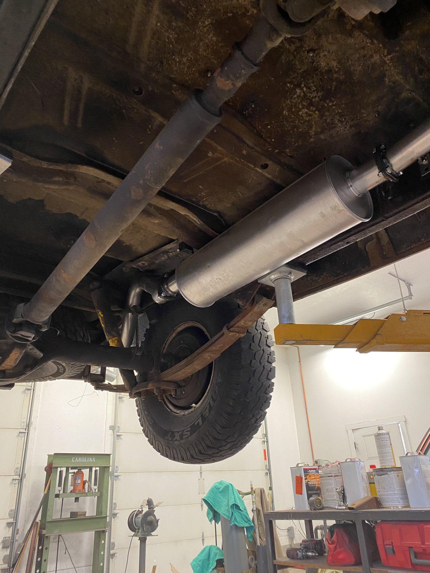

Sorry I haven’t posted for a while, but just got busy. I finished the exhaust, re-jetted the carb for high altitude, installed and built a carburetor blower bracket, I welded up the holes in the floor, and finished most the tailgate issues. I also repaired the rear axle seal and while doing that I replaced both bearings, seals, brake shoes, wheel cylinders on the passenger side and drums. I’m getting real close to having it ready to be street worthy. Attached are a few photos of the progress.

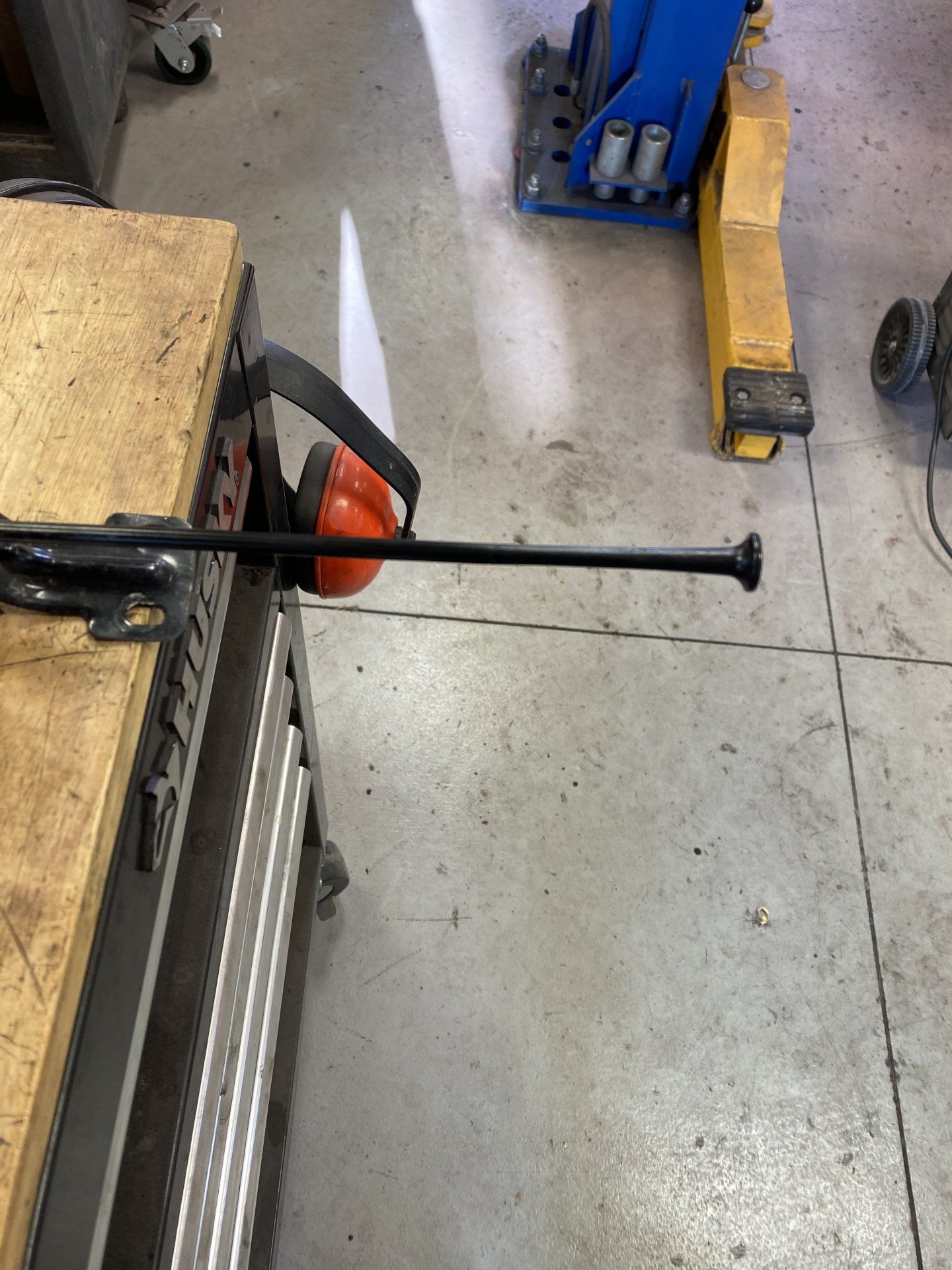

Sorry, I should have taken a picture, I’ll do that next time I’m out in the shop, but I need a picture after the regulator is installed where the linkage is hooked up between the handle mechanism and the regulator. Mine had an additional spring to return the bracket to the lock position.
I assume you mean this spring on the left side.
That’s the spring!!! Thanks, I had it attached in that location, but it seemed a bit stretched and kind of odd to be attached to the clip so I attached it to the bar itself at the handle side. I’ll be putting it back in that factory location.

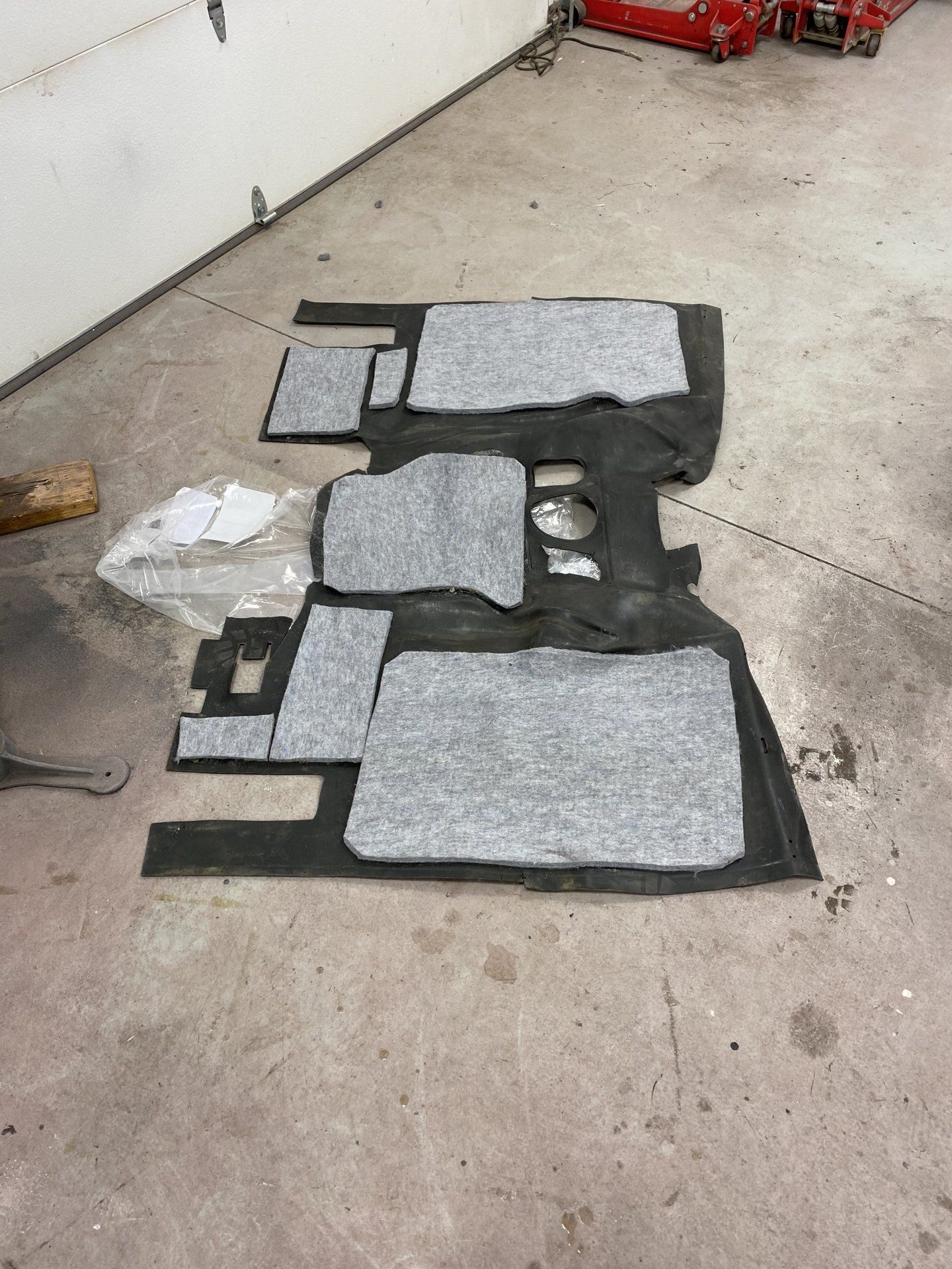

A couple more things competed. I repaired the broken plastic vent pull, and added felt to the back of the floor mat, looking to make it quieter to drive. I also got my springs today. It’ll be fun to see the difference.
... and added felt to the back of the floor mat, looking to make it quieter to drive.
That material will retain moisture. Not that it won’t work for your intended purpose, but keep that in mind. Pull it back to check your floorboard conditions often.

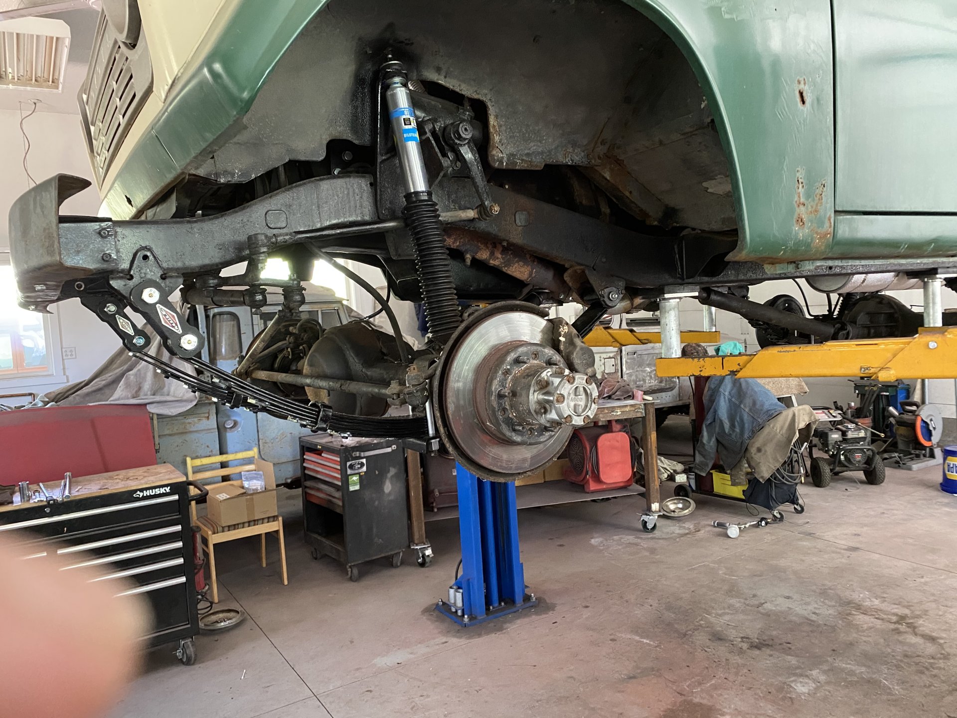

Got the lift and shocks installed, I need to extend the front bump stops, bleed the brakes and it’ll be ready for it’s new set of tires. I did extend the brake lines, and the breathers are relocated under the hood.
