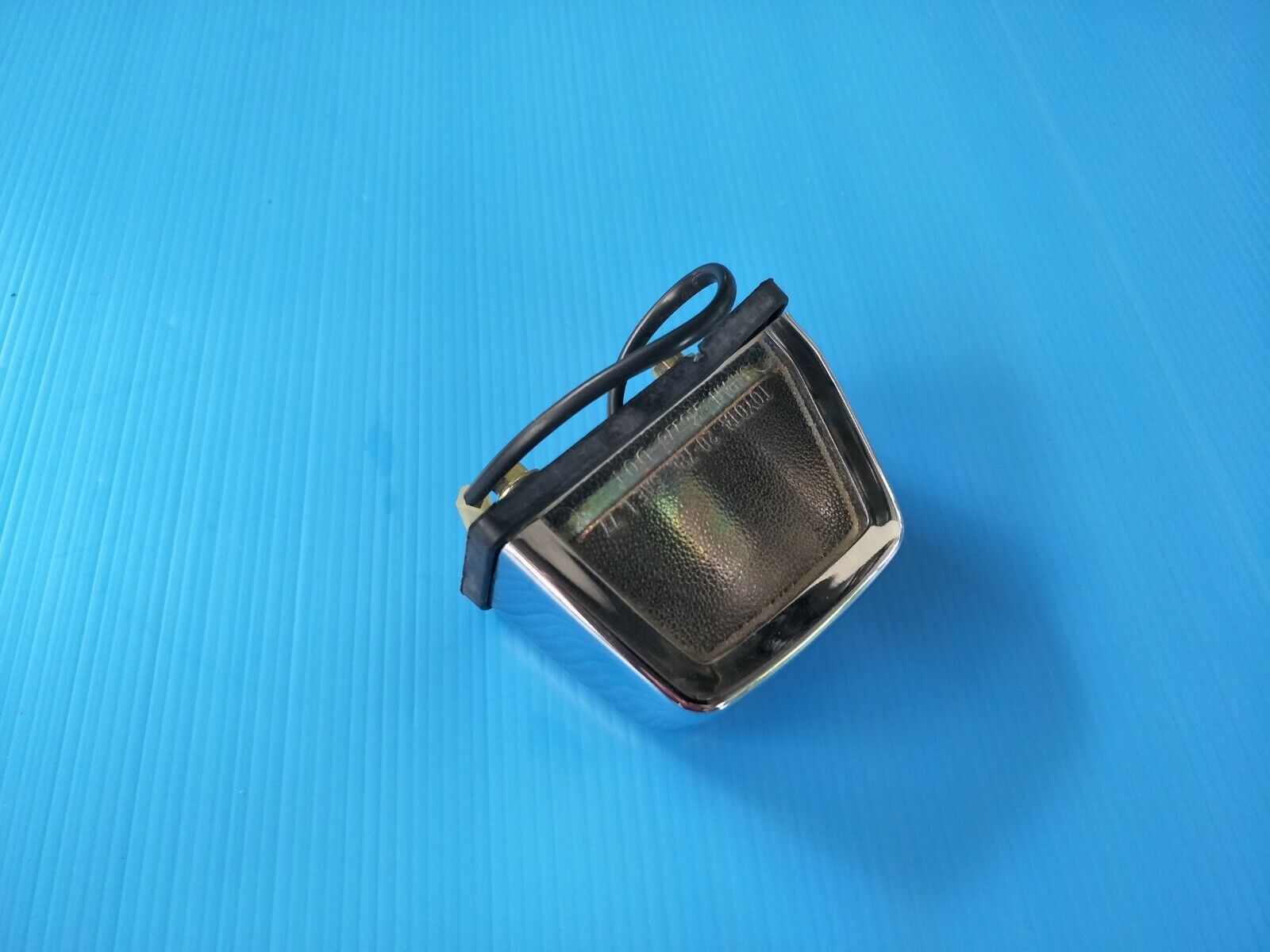

So, I cracked into the tailgate to repair and lube things up, but now I need more parts. I’ve looked around and found some options, but I was wondering what others have done for the license plate lights and cheap rubber for the tailgate glass ie. channel rubber, outer and inner wiper and upper rubber. I found some threads, but they all seem pretty old so I thought I’d see if there were any updates.

I know these aren't the prettiest, but has anyone used these for license plate lights?
or these.....
I actually like the Hella's.
This is the one I really like, but they are NLA
And another....
One more....
Amazon product ASIN B00G27NVT2
Another....
I wouldn't mind using the second choice, either. Wonder how close the mounting holes are?
Not sure, I believe they will fit in the recess of the tailgate which is good, I'll have to verify that, but for the studs I figured I could probably relocate the studs in the housing if necessary, or just drill new holes which isn't my favorite thing to do incase someone decides they want to reproduce the original ones eventually.
Ah, yes I forgot to add the link above, I was considering that option as well, but everything I see is from Bancock Thailand, and I believe aftermarket, but maybe just the last of the NOS for that part. Since they didn't look exactly like the factory lights I was considering other high quality low cost options. BTW, I checked a few part numbers and from what I can tell they are NLA from Toyota, but I could be wrong, I only checked a few years and a few models.
