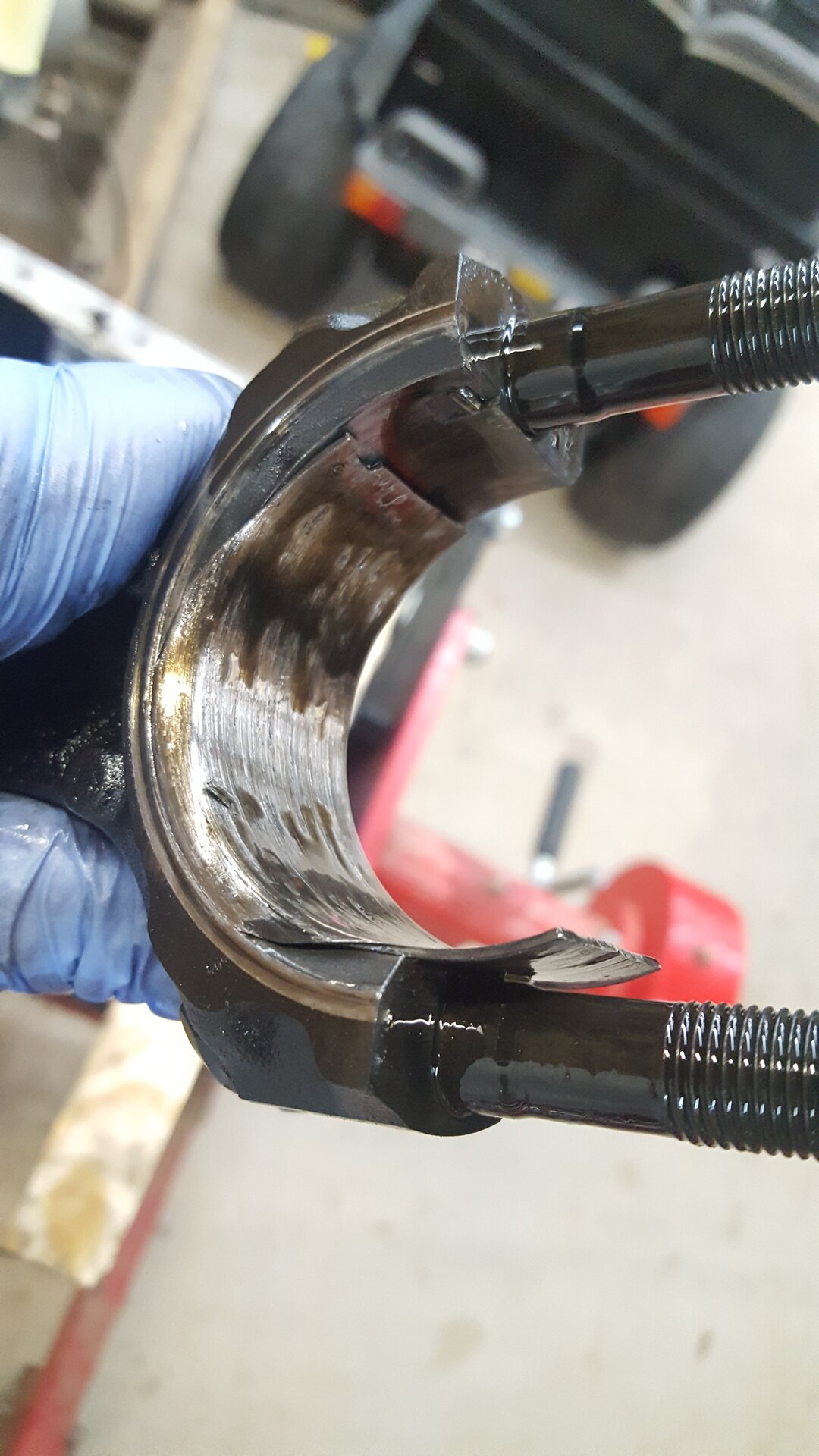

A few weeks ago I finally got the short block up on the engine stand. Timing cover, rear seal retainer, and oil cooler came off on there way to the vapor hone. Lifter covers and oil pan were removed to access the internals. I started pulling the pistons and instantly found the culprit. #6 rod bearing had spun.
Bearing material blocking the oil orifice.
