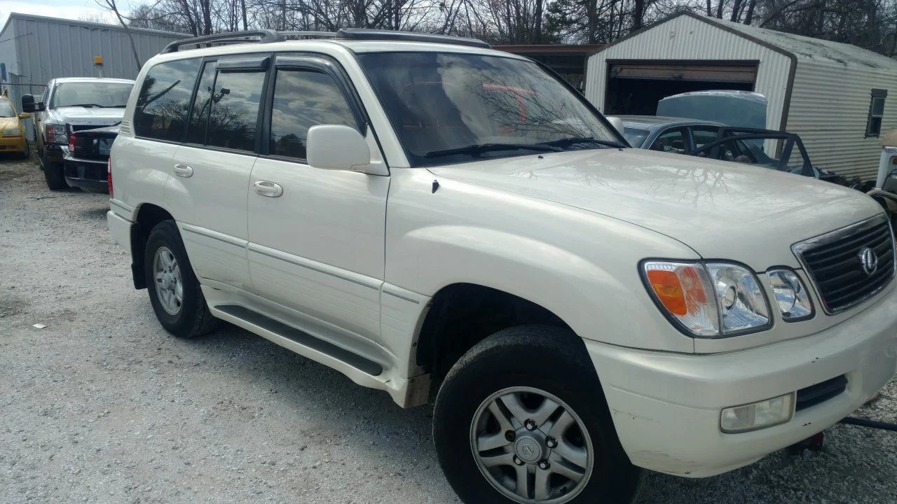

And now I have a pearl 99 LX. 190k. I love this truck it is soooo smooth! Not perfect but I gonna drive the wheels off it anyway! She's mostly clean. Lil surface rust here n there..
AHC is removed good ole coil spring in place.
Small issues..
High beams are broken, no blown fuses. (Actually low beams. Blown bulbs. Fixed.)
And the remote key had a dead battery replaced that. Does this deprogram it? Red light on the key works now. No locky trucky. (Still on this one...)
CEL is on.. But the air filter was way dirty.
I'm not mad for less than 7k.
Updates in orange!
Small issues..

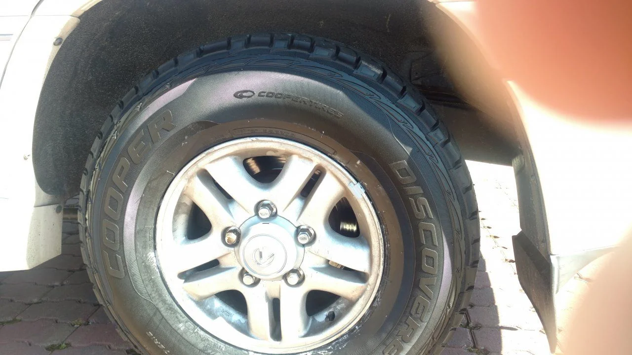

Talked to the dealer. He says he'll do the tires 50/50 split with me so maybe won't get MT/AT's this go.. But even 20k on $300 off brand tires is OK with me at this point.
No regrets on this thing at all.
I wonder if the dealer would be willing to give you in cash what they would have on cheap tires and let you apply to that to good ones. The BFG AT KO2 are available in the size for your truck and are $891 from the Tire Rack. Good tires are important for lots of reasons. I worry the dealer may chose a really cheap, poor quality tire that you would regret.
Worth a shot. Ill call 'em tomorrow!
Gave me cash. Now it sits on Cooper Discoverer ATP's. 265/75 16.. They were cheap had decent reviews.. Sorry bout the fingers. Ha!

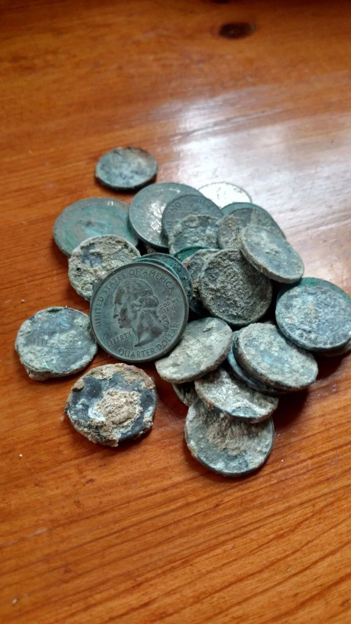

Soooo on my foiled attempt to replace a door actuator so my key fob will work I found out that previous owners used the door card for a piggy bank!
It seems as though the coins had been there a while.. but there is zero evidence of water damage.. I'm thinking it must have been caused moisture build up from the humidity as it has been a NC car most of its life. And as for gold... I still have 3 more doors to check! :)
