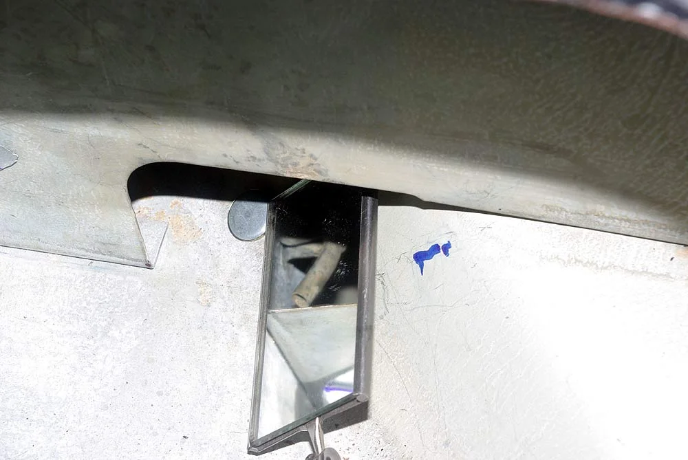

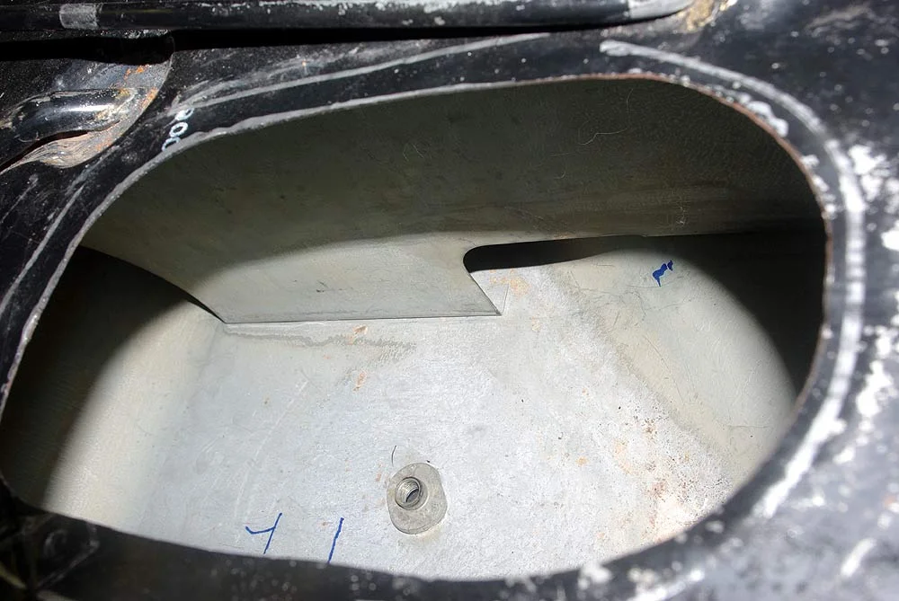

The pickup is behind the drivers side baffle from the sender hole.
rootbeer_7-jpg.1110888
Likely can see the end of it with a mirror? It's just a tube, no screen, etc, but does have some sharp bends.
rootbeer_8-jpg.1110889

Guys, when I looked down the fuel hole I can see pitting and on the bottom some microscopic holes. My mechanic wanted to put copper sheeting over the bottom but with 40 tiny rust spots on the inside, repairing is just not doing it right? CCOT $289 delivered new tank, metal.....
If it has significant rust issues, I would replace it. Check with cruiserdan for Toyota pricing, may close to aftermarket?
