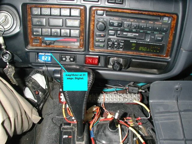

Digital AmmeterJeff;
Jeff;
Of course, u could go digital!
https://forum.ih8mud.com/attachment...ent.php?attachmentid=57128&stc=1&d=1139713406

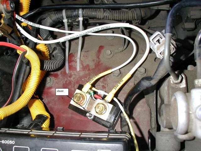

dfmorse: Do you have more info on that shunt, current capacity, website, etc?
I would prefer both but with 2/0 battery cables and #2 alernator wire I didn't want the hassle of trying to wire it.

1) True, you can get an ammeter without the high currents inside the cabin. But since these are relying on a very low resistance shunt, in my experience they tend not to be very accurate. A very small change in resistance (either due to connections or old age) will give inaccurate readings. But I think the trade off is worth the extra margin of safety of not having those wires in the cabin.
