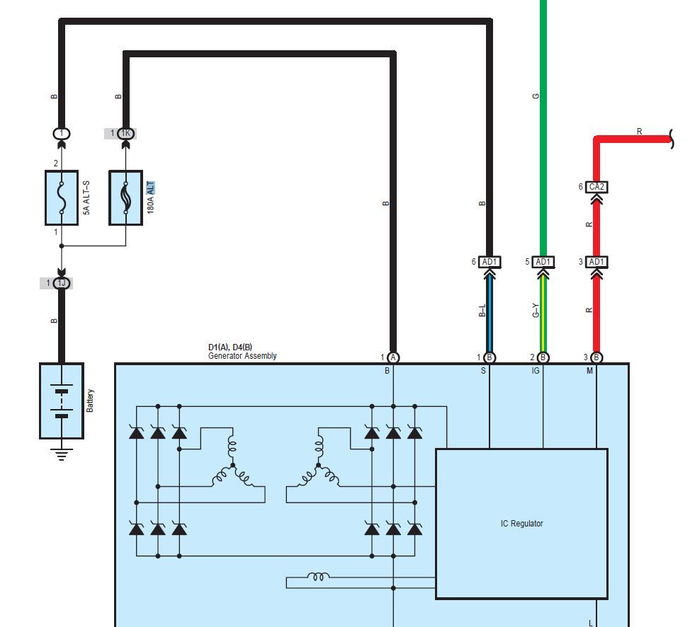

Regarding the 5A charging rate... There's (up to) 180A going to the battery. The 5A is the battery voltage sensing line that controls alternator output. Electrical systems are battery fed but alternator charged. We have a (roughly) 14V electrical system with a (roughly) 12V battery. The system operates at 14V when the truck is running which is sufficient to both provide for electrical demands and charge the battery. The system drops back down to a 12V (technically 12.6-12.8V) resting voltage when the engine is off.
All that said, the system will supply as much power as required to charge the battery (or more specifically, to attain the system cutoff voltage). 5A would be a horrible charge rate.
Thanks for the extra info. I wondered about that 5A rate when I read the specs in the manual. :doh:

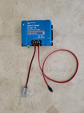

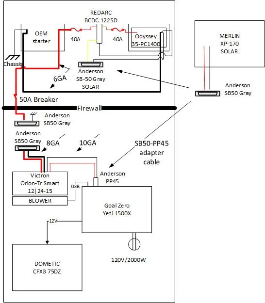

The car charging units weren't available when I got the 1500X so I made my own and saved some $ too.
To charge the 1500X I use a Victron Orion Smart Charger 12/24 15A configured as power supply. It's connected to an Anderson SB-50 plug which runs through the driver's side firewall straight to a 50A breaker and then to the starting battery. With the Orion, The Yeti charges at 360+ watts which is 3X more wattage than the 120V wall unit using the 8mm input port that it ships with. The Orion can be configured to stop & resume charging at any voltage you wish to prevent over-discharge of the starter battery. You could get fancy and connect the Orion's on/off cable to IGN I suppose.
I also have a Redarc BCDC 1225D that charges an Odyssey Group 31 AGM both of which are mounted in the engine bay on the passenger's side. I've had it installed for 2 years and have had no problems with the Redarc or the AGM battery whatsoever. This gives me the ability to charge my 2nd battery and the Yeti 1500X via solar.
This is the most basic unmounted setup for the Victron Orion. Anderson SB-50 in and Anderson PP-45 out to the Yeti 1500X.
This allows me to connect the Victron to ANY 12V power source using battery clamps or other connectors on an extension cable compatible with Anderson.
Note I went further and mounted the Orion to a board with a blower.
I then bungee-strap it to the Yeti 1500X when driving.

Hunter, we have really similar setups. It looks like you have the Starter/main feeding the fridge. And, the 35 accessory battery is isolated from that path. Wouldn't you want to pull from the 35 to the fridge and leave the main off of the Yeti circuit? That way you could use the solar priority, support the 35 at the right AGM voltage, and then feed the Yeti Li? I went that route, but with a blue sea switch downstream of the redarc so I could feed the agm or Li and change the charge rate appropriately.
You are almost at a switchable jumpstart/winch circuit already, how about a switch between Main and the AGM +?

Hey thanks for the post and I get great ideas in here, btw. That's how this all started! 😁
This whole thing has turned out to be an evolution. It all started when I had the trailer brake controller installed and I had the installers throw in the Anderson SB50 on the driver's side as an after-thought thinking I might use it for something. Then I added the 2nd battery just in case I ever ran down the starter battery. Then I got the Yeti & Dometic. And so evolution has produced an Armadillo!
To answer your question yes I would like to run from the 2nd battery and I do plan to add a SB50 to inside on the passenger side as well as a USB/cigarette lighter panel to run stuff like dash cams and communication radios. I could then run the Dometic off the 2nd battery - but for not nearly as long as from the Yeti. But I would not want to charge the Yeti via the 2nd battery - see below.
Re "blue sea switch downstream of the Redarc so I could feed the agm or Li "
That's pretty cool so you can accommodate 2 kinds of batteries with one Redarc.
But if the goal would be to charge the Yeti with the 2nd battery then I'm not so sure, at least with my Redarc 1225D. The Yeti needs 14V (I have the Orion set to 24V) at a minimum to charge so would the 1225D Redarc be able to safely charge it without the Orion as a current limiter? The thing to consider is that the Yeti is also a beast and sucks as much power as you can throw at it up to 600+W. 600W @14V is 43A so my Redarc could be constantly maxed dependent on the load on the Yeti. I think I'd run the risk of burning up my 1225D, frankly.
As a practical matter charging the Yeti off the car should really only happen with the motor running so running off the starter battery is OK I think - I have the Orion calibrated so that it switches off in seconds after the engine stops. I can charge the Yeti directly from the 2nd battery but I'd only do that if the yeti was low and I needed the yeti's inverter; otherwise just run whatever straight off 2nd battery.
Note I have experimented with charging the Yeti from the 2nd battery using the Orion with the engine off, just to see how far the 2nd battery would last. It doesn't charge the Yeti by very much before becoming dangerously discharged.
Re the switchable jump start. I considered that but decided against it due to complexity and even if I had it I'd still feel I'd need jumper cables. I've already jump started my wife's car and a few others off the Odyssey 35.

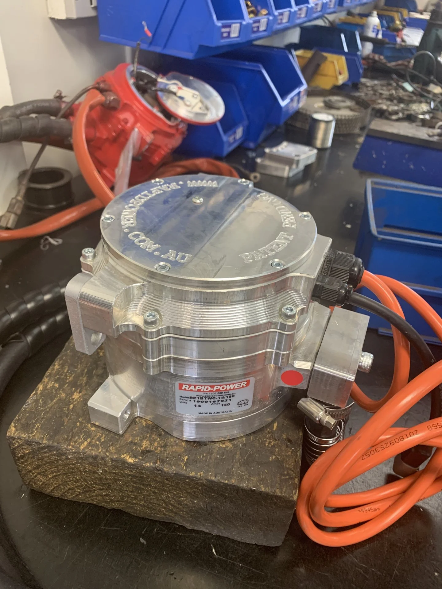

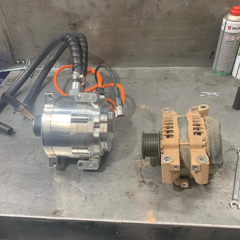

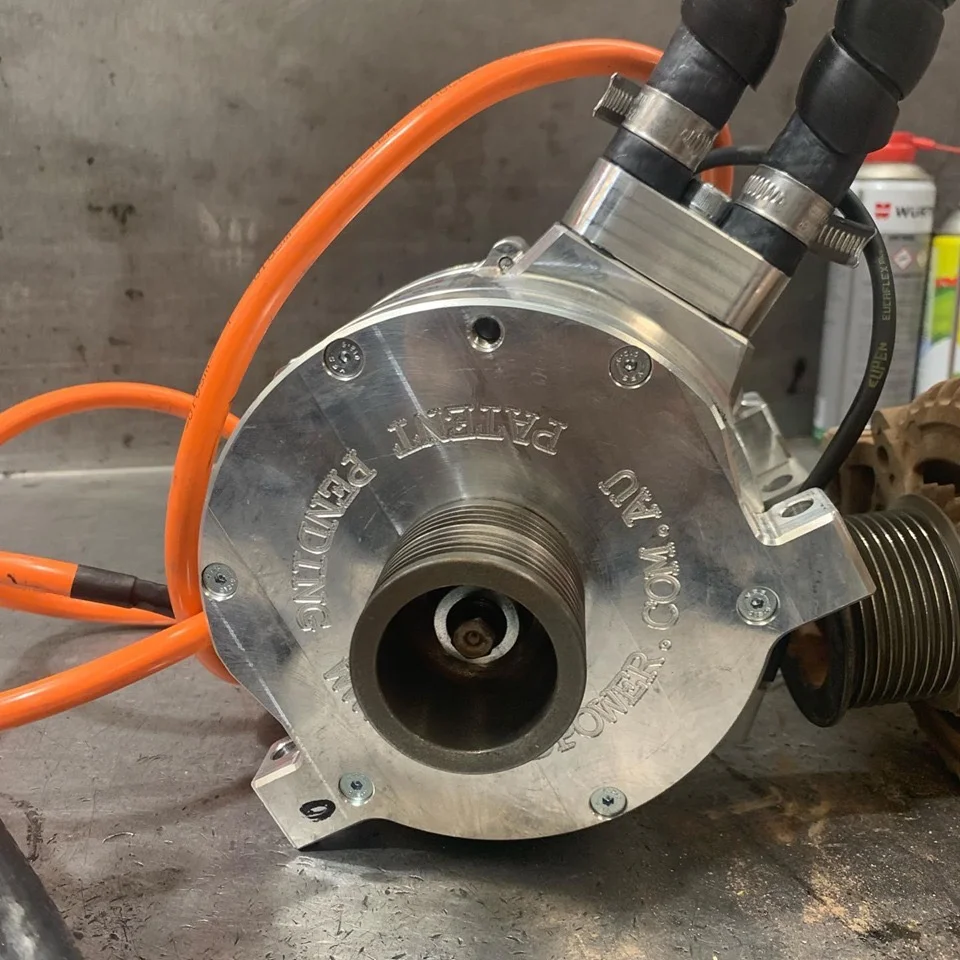

Redarc does boost the voltage a little but its VERY low amps. 25-50a MAX but a decent alternator can charge at 200a. Over here in AU we have underbonnet lithiums and run a LOT of high demand devices. Not only wont a stock alternator do this but a AGM doesnt have the sustained discharge rates to run things like airfryers and induction cook tops.
Engine OFF, Cranking, Idle then driving off.
Im the distributor for Rapidpower and the 4.7/5.7 (2UZ) has been developed but not yet the UR engine.

VooDoo: Rapidpower has a lot of fans here, but the pricing is high. The location of the alt in the 200 is terrible and we do need a solution. We don't really see lithium starting batteries in the US. That seems like a built-in market for anyone who wanted to try. There are a ton of lame CCP batteries but for $500 usd and no warranty service, doesn't seem worth it.

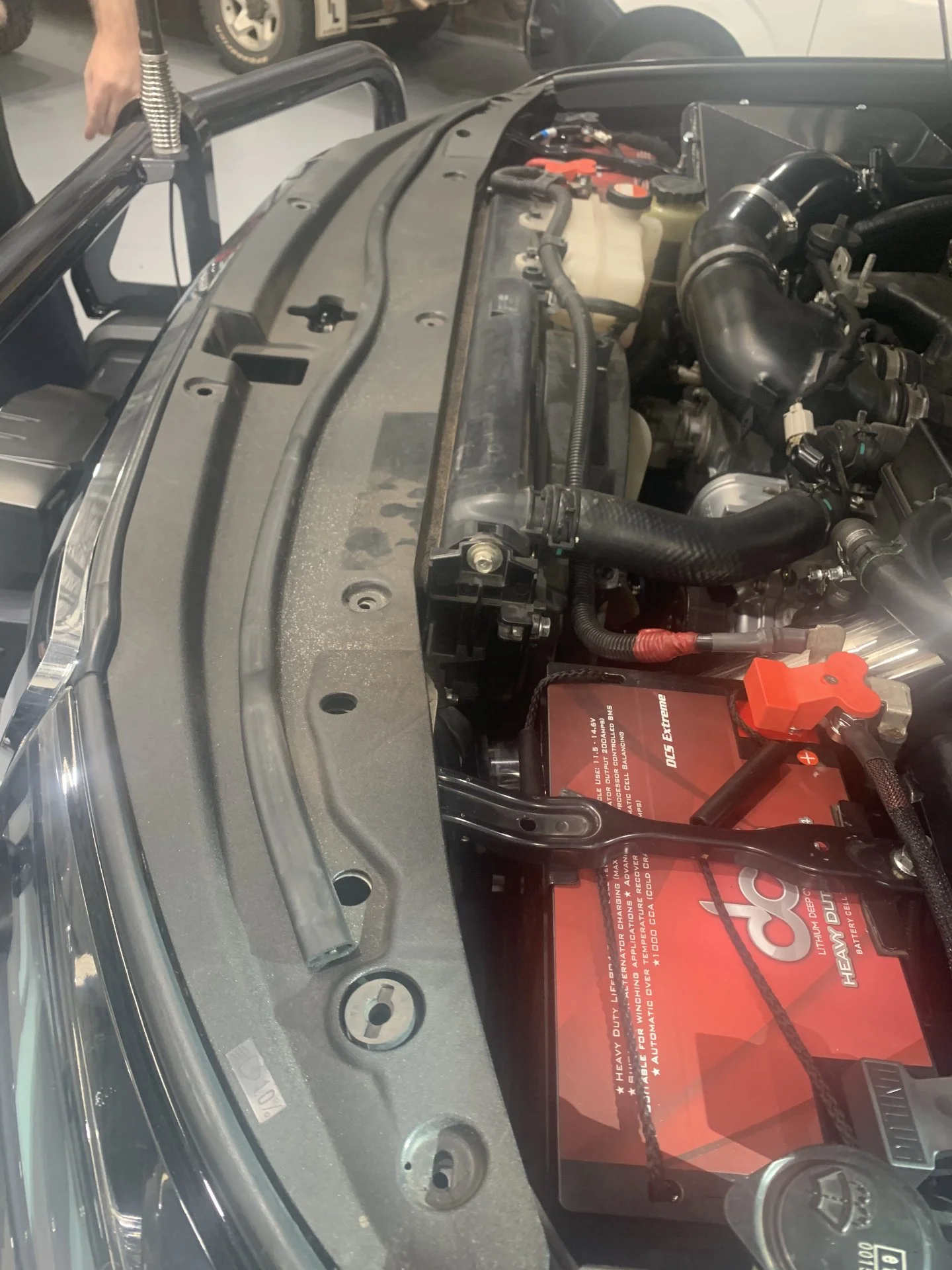

Price is high on good gear, we do drive landcruisers for that reason. Id love a Rapidpower / Lithium distributor over there as i think they would go crazy. Huge market for someone willing to invest.
