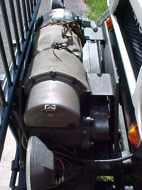

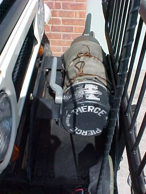

i have a 12500 pierce winch.... have the stock alternator... AND dual batteries

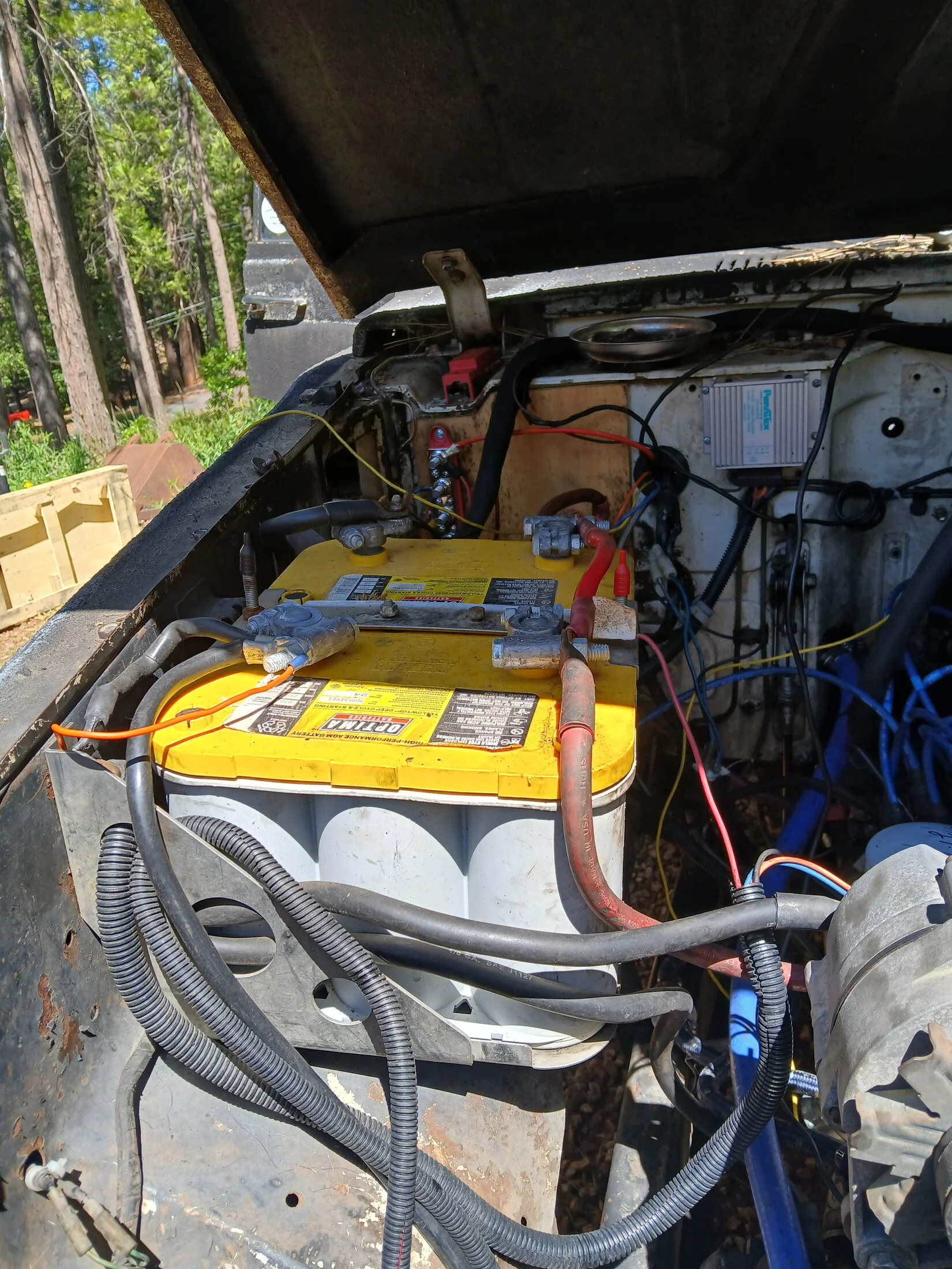

I put a 200 amp Mean Green alternator in my 40, upgraded all of the battery/alternator/starter/ground cables, and rewired the winch with heavier gauge cables than Warn used. I only have one battery, but it’s a good one and the biggest that would fit in the stock tray. I have done some very heavy pulls and some long pulls with that setup, and never had a problem and never drained my battery, FWIW.
