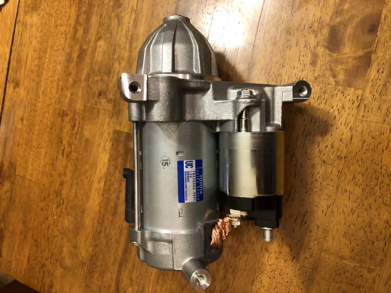

Just got my new starter. A physically remote solenoid would be pretty difficult...

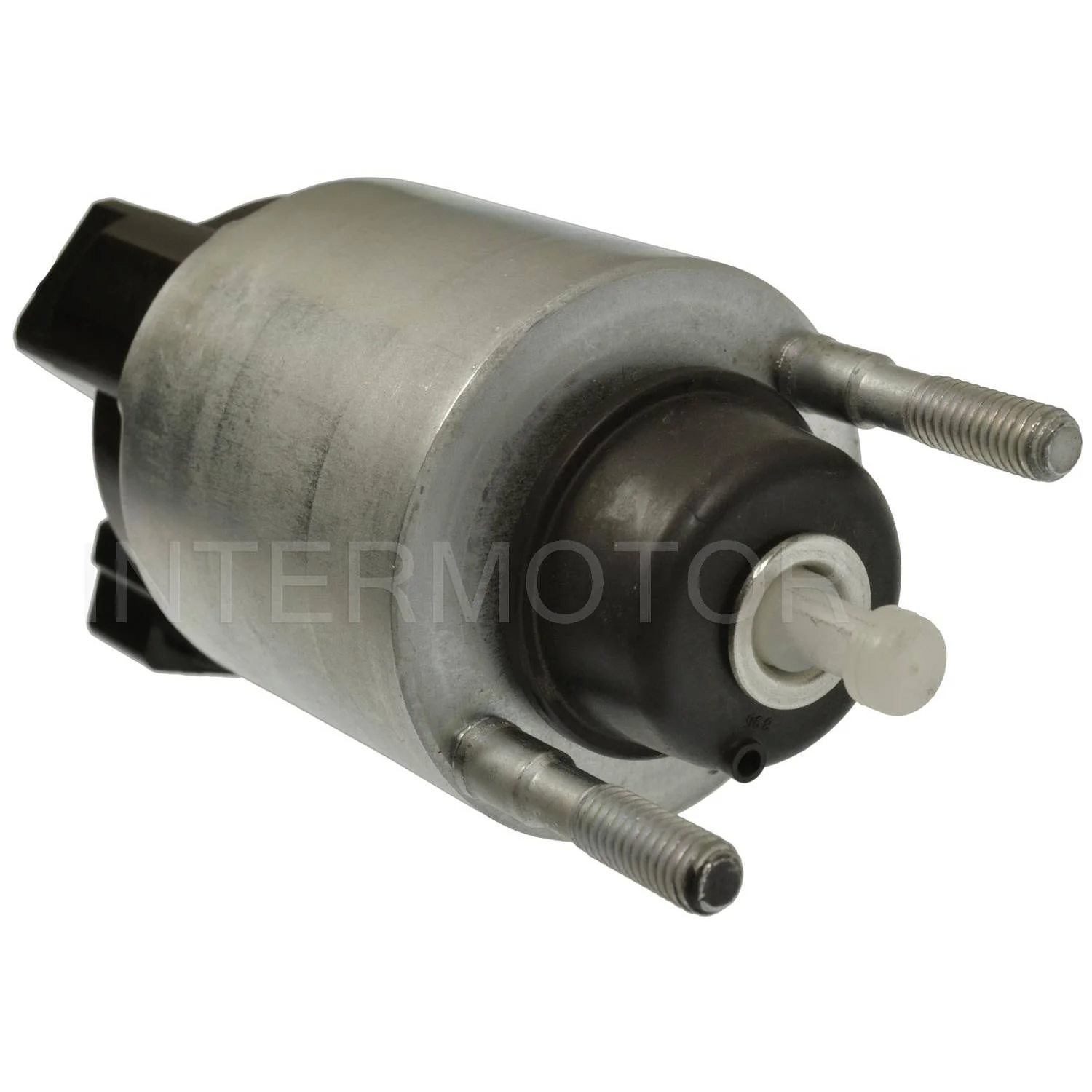

Can you see what the 'hidden' end of the solenoid is doing with that whitish plastic pin? The copper cable (assuming positive) could be lengthened, but I'm curious what magic is going on inside the bracket that is joining to the starter. Have to admit it is one part I haven't spent too much time with.
Without taking it apart , I can't tell. My guess is that it triggers a mechanism that pushes the drive gear into the flywheel.
Seems likely. Sure you don't want to pop those 2 10 mm nuts off and find out :)
All modern starters rely on the solenoid to engage the starter drive with the ring gear of the flywheel. When the solenoid is energized, it operates a plunger or lever which forces the pinion into mesh with the ring gear. The pinion incorporates a one way clutch so that when the engine starts and runs it will not attempt to drive the starter motor at excessive RPM.
Some older starter designs, such as the Bendix drive, used the rotational inertia of the pinion to force it along a helical groove cut into the starter drive-shaft, and thus no mechanical linkage with the solenoid was required.[2]
No reason to doubt wikipedia, no reason to disassemble, and no remote solenoids for us. Bypassing the contactor seems to be the way to go.
