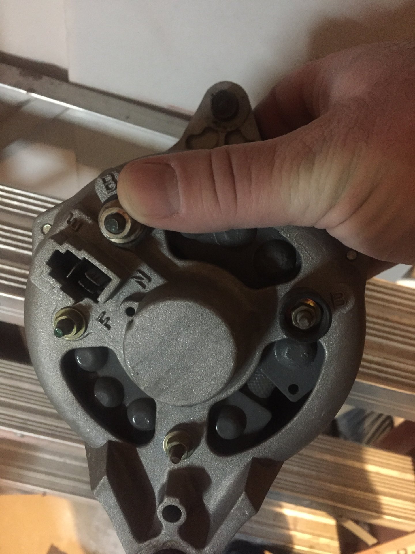

I checked the wiring and the fusible links were cracked and almost falling apart so I change them. I live in California and I went to Autozone to buy a new battery in case the newish battery from napa was bad and after hooking up the new battery, it started right on. Then I took it back to get the alternator checked and the guy said the battery was getting low on charge and that the alternator wasn't working. If you see the picture, I wonder if that wire needs to be hooked up somewhere because it seems odd to me to have it loose and it seems like its hot because of the dust rubber cover. I'm trying to find out where that wire belongs to.
That wire needs to go to a post on the alternator. That is the charging wire. It should be where that hex looking bolt is. Looks like the post has broken off. Probably tightened to much and broke loose and that is where your problems started
This is a FJ-40 alternator and has 2 terminals that can be used. They are marked B.

If you see the back of this which looks slightly different but same conectors that the one the shop installed. The rounded connection is fine and its the only one connected. I actually tried to connect it to the hex nut/bolt, red on the picture and it started smoking so I disconnected the battery terminals right away. Its so weird that the guy at the shop would leave the wire hanging loose after installing the alternator which it worked good for 3 weeks until it didn't.

Travis, you are right. I'm an idiot. The wire goes on the terminal and it broke off. I'm an idiot because I thought since the bolt is short, then if I took off the black bushing, I'd have had space for the wire making a short by touching the alternator housing. Thank you!
