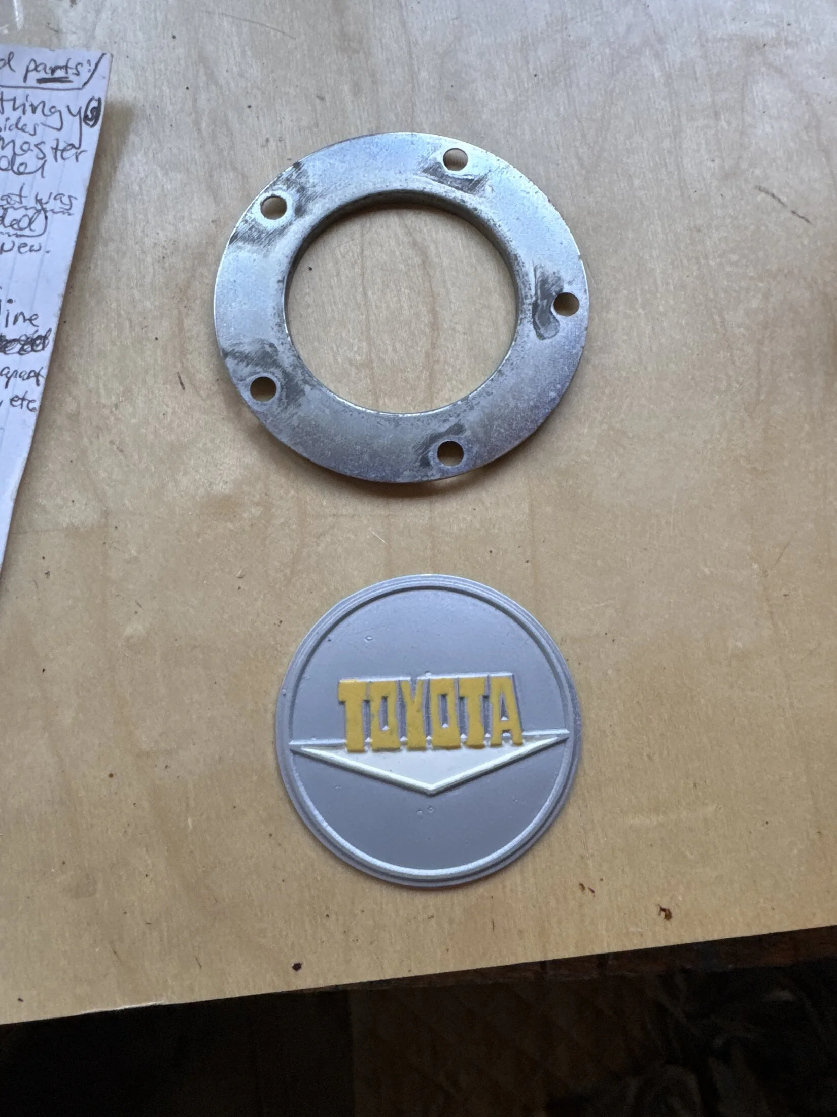

Has anyone ever found a different steering wheel than of course the original 67’ wheel the emblem is made for?
Basically I wanted a little smaller steering wheel than the original lager diameter OEM steering wheel.
I know this is somewhat a rare question, but just seeing if anyone has ever played around with that and found something, a steering wheel with smaller diameter - even slight, that could fit the emblem in the center with minor alterations.
Shot in the dark, but worth a try…
(Oh the bracket thing on top is for a tiny diameter off road style steering wheel the PO converted). A GT one and it doesn’t wanna quite fit on that one with a lot of cutting and grinding to McGuyver it. But where there’s a will, there’s a way I guess.

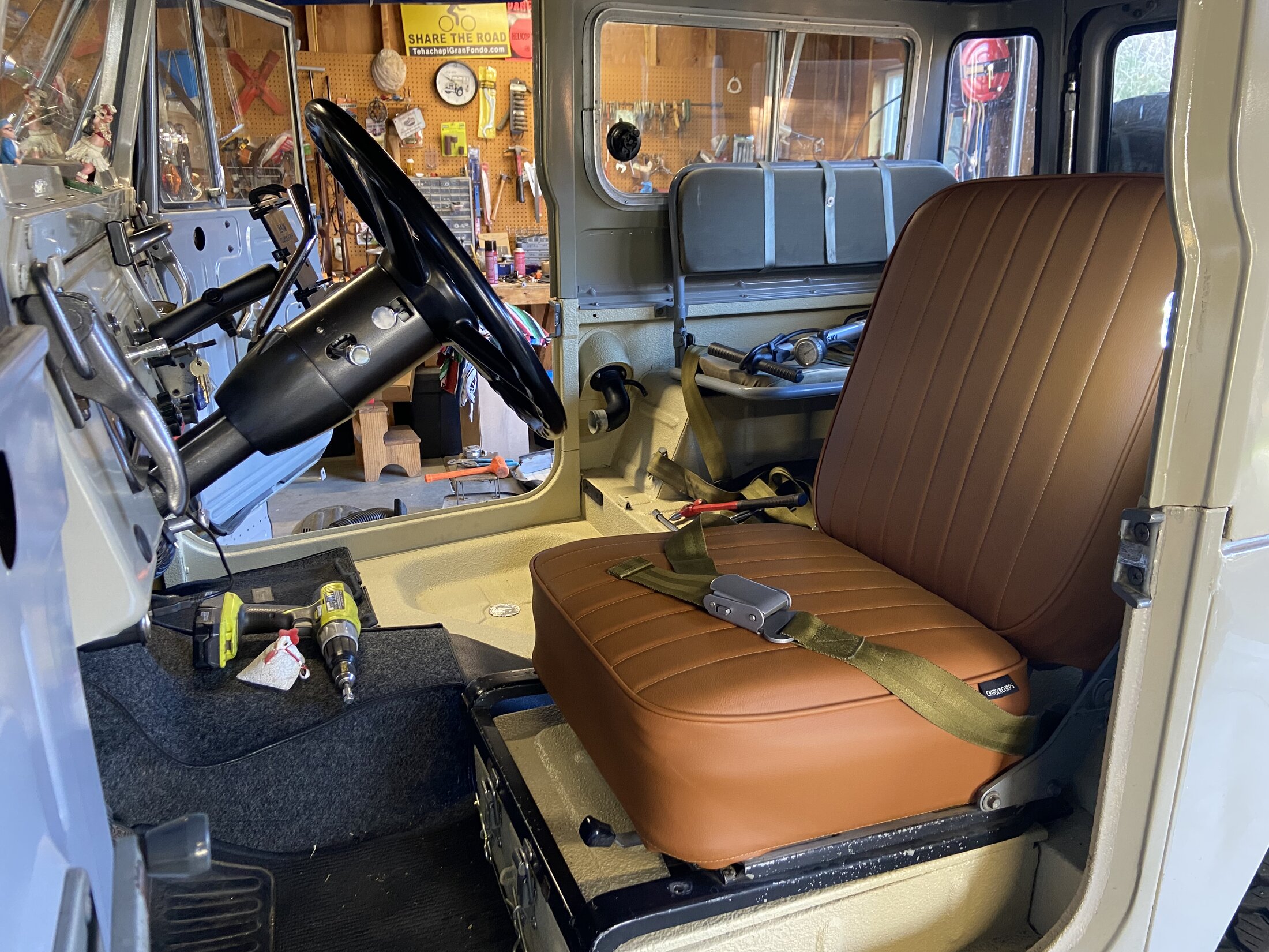

Only when I converted to Saginaw PS and a GM column. The steering wheel is a 15” GM early 50’s model that Speedway sells. I don’t remember the spline count but then all of the new stuff was compatible.
If you are going smaller diameter and big tires you may want to do a power steering conversion. Lots of options out there, and mine is a ‘67 also. Horn button fit oddly enough.
Column is a 32” tilt generic Speedway item.
Saginaw kit from Advance Adapters.
Edit: beautiful work below although I think I have maybe $1500 into the AA kit, column and steering wheel. Love that someone took on making a new wheel. Much more organic solution.

Only when I converted to Saginaw PS and a GM column. The steering wheel is a 15” GM early 50’s model that Speedway sells. I don’t remember the spline count but then all of the new stuff was compatible. View attachment 3911767View attachment 3911768

No it’s a full Saginaw box with GM Column. The Saginaw ‘kit’ is from Advanced Adapters too. Including steering shaft and universals. Was the easy button for me.
The steering column is from Speedway as is the wheel, like I mentioned above.
