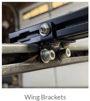

yes. we sell a cross bar kit to add extrusion cross bars across the top of your OEM rails. Can be done in any length, I think that's what you're after? Our wing brackets are a direct bolt-up, here's a pic:
