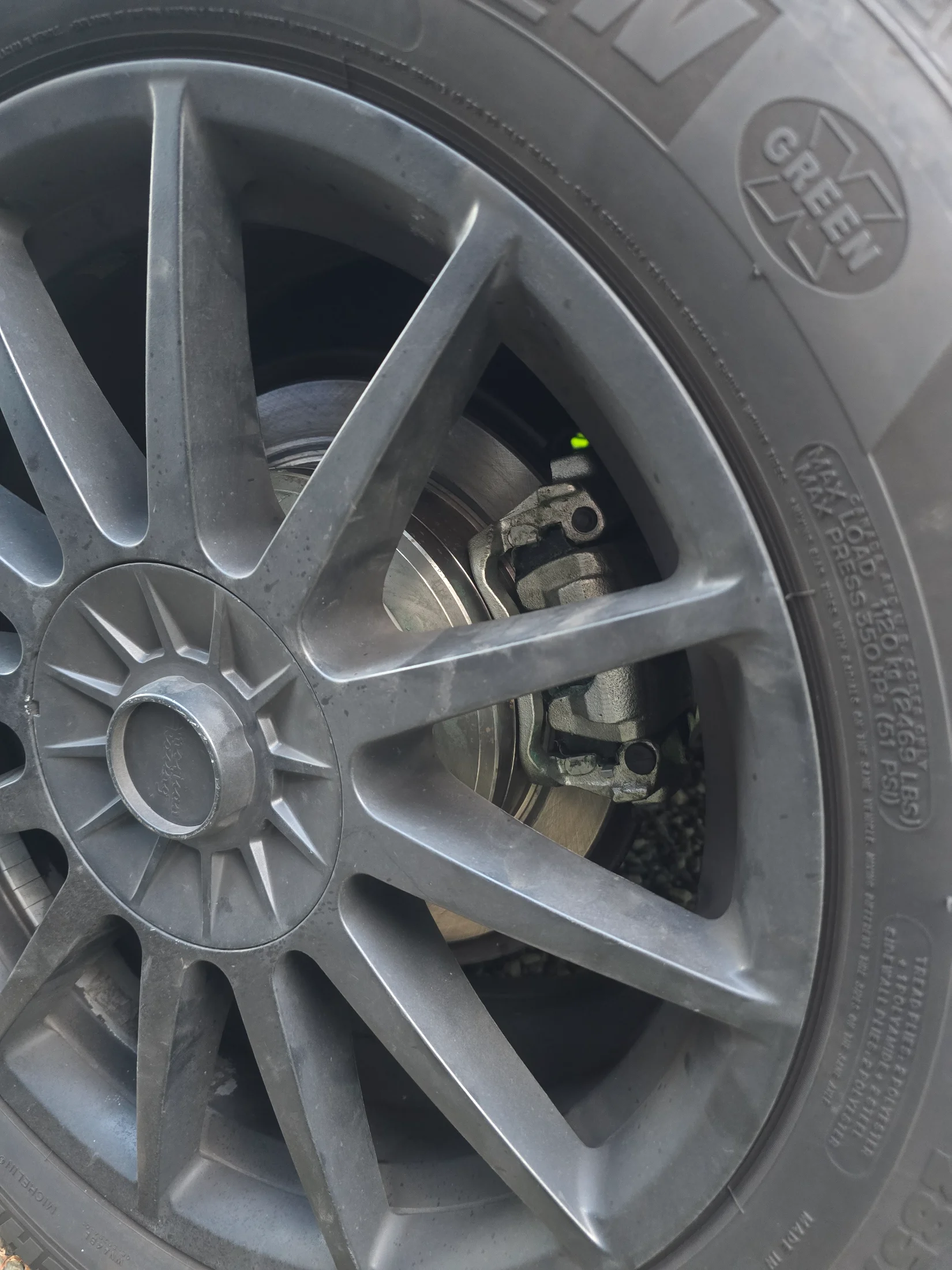

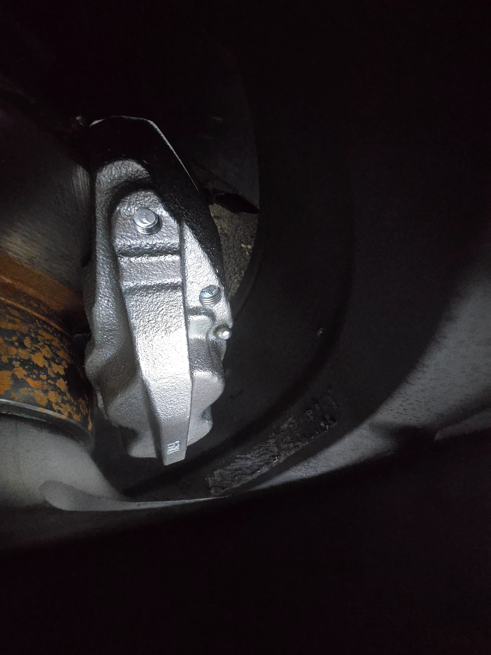

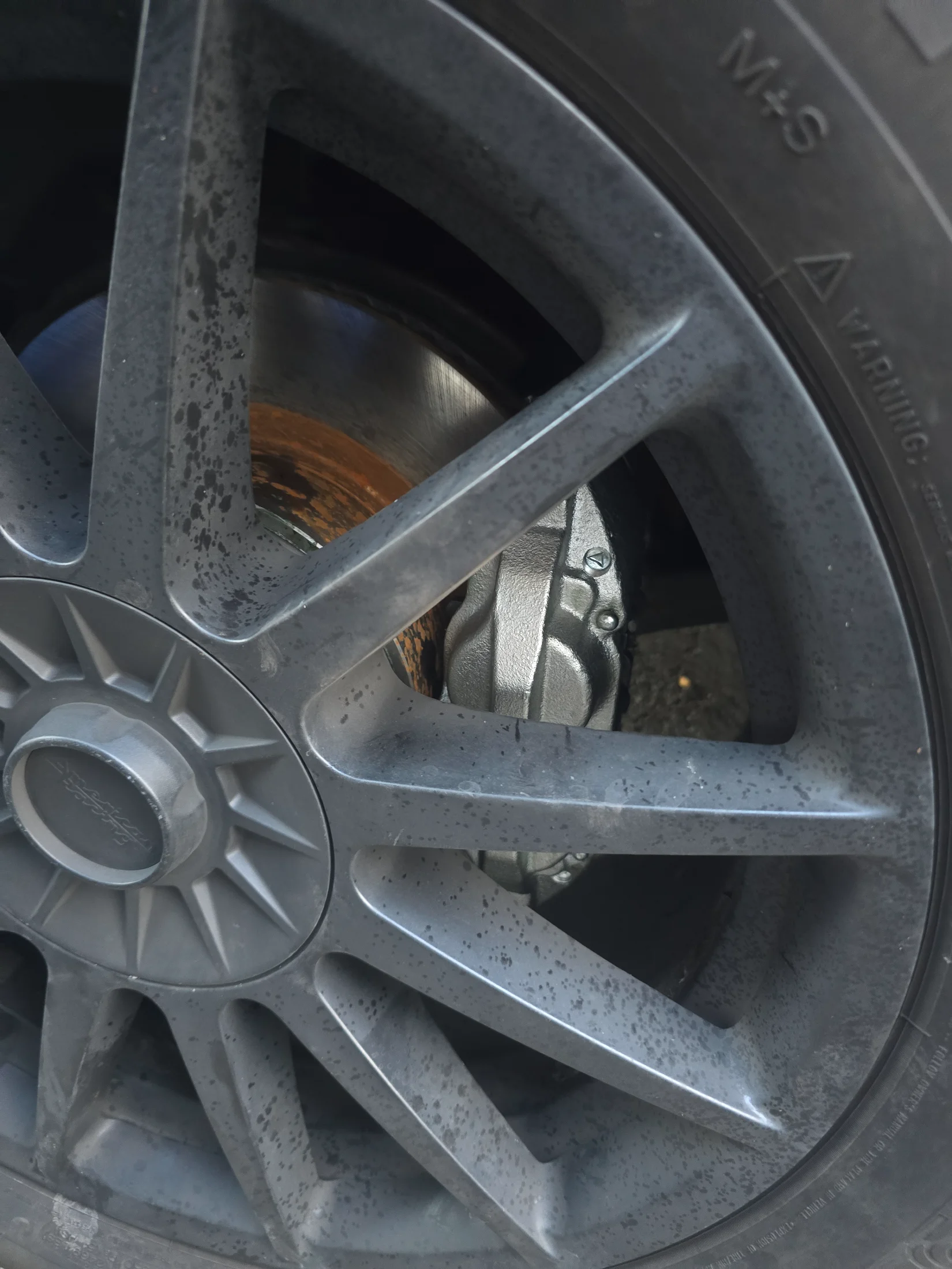

Parts are from rockauto bosch pads and centric rotors, same with calipers. They are installed with the bleeder at the top of the caliper. I couldn't take the wheels off to take pics I took them with the rims on. Hopefully in the next day or two I can take some pics with the wheels off.

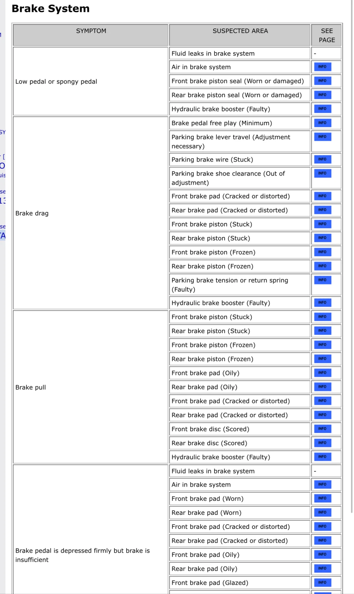

BTW the FSM troubleshooting says that if all brakes are dragging the only commonality is the hydraulic brake booster…

BTW the FSM troubleshooting says that if all brakes are dragging the only commonality is the hydraulic brake booster… View attachment 3960194
