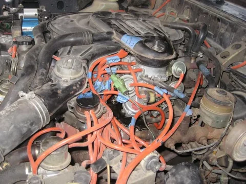

One question. As I was working, amazingly my carb cooling fan came on. It turned out that I was grounding this wire, which looks like it was burned at some point in time:
I was actually grounding a bare portion of the wire against the fitting for the brake cylinder. It looks like a fuse link in line, so I didn't ground it. Should I be looking for the temp sensor at the end of this wire?
Curtis was saying the theory goes that if you just ground the carb cooling fan, it just runs for 15 minutes after shutoff. True?
Thanks.
