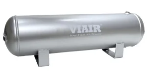

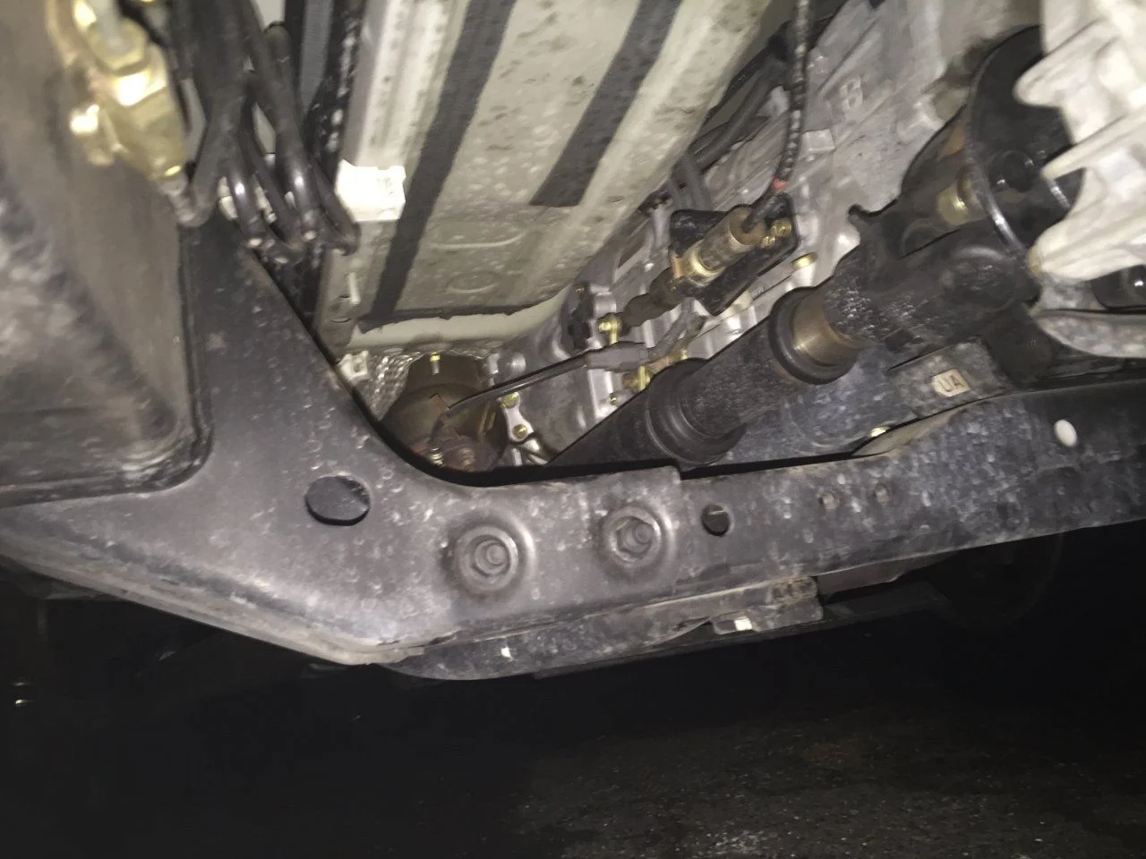

Has anyone mounted an air tank in this area under the body to the left of the front Driveshaft? I took some measurements of the area and it looks like the 2 gallon Viair tank should fit fine mounted upside down to the body. Anyone see why this would be a bad idea?
If it fits, go for it. I havent seen anyone do that. Once you get a swing out you can mount as many as you want in the old spare area lol

I think it would work as long as its protected.

I think I'm going to go ahead an plan on mounting the 2 gallon Viair tank in the area near the front driveshaft. Seems like a no brainer for my planned setup.
