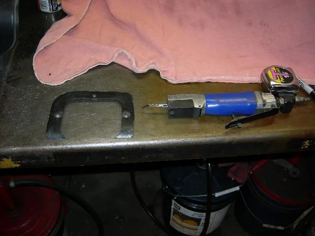

At first I thought I could do without it. As I hadn't seen many people that had ever used them. Most people just use a cutoff wheel on a grinder or air grinder. But I bought one anyway.
Boy was I wrong. It cuts sheetmetal like butter and it's very exact unlike a saw zaw. I can cut anything from bolts, angle iron to any variety of sheetmetal. The blade is very flexible which make getting into tight spots very easy.
$99 dollars at Northern Tools
Marshall...
Those saws are worth every penny.
I have, as have many other people, used the hell out of mine.
attachment.php
:beer:
I used one of these tools to cut the fenders out on my 80. Worked like a charm. It was almost TOO easy...
Picked mine up from the local tractor supply for ~$70, with a 2 year warranty.
-Tim
I thought a cut-off wheel would go quickly thorugh sheet metal, and I was WRONG. I use my air saw (IR) for any sheetmetal cutting I can.
Only problem is you have to clamp/hold the part well, otherwise it just vibrates with the saw and it won't cut (particularly when doing small sheetmetal parts).
For bigger things I use a Sawzall-type saw (mine's a DeWalt) and that cuts metal MUCH faster than a cut off wheel also.
