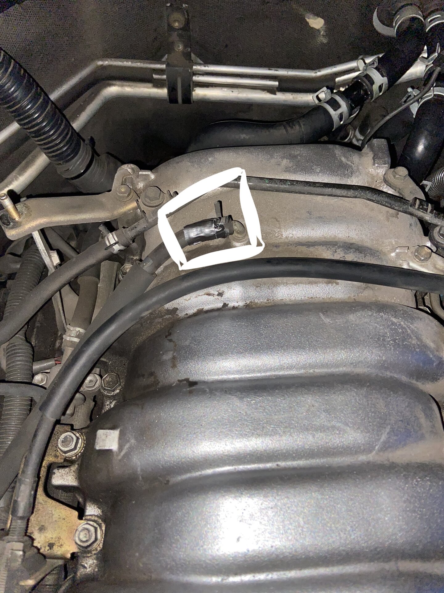

Air leaking from small hose on engine

After changing my heater tees, noticed this small hose on top of my engine was leaking air. I’ll attach a photo below, as a temporary remedy I put some duct tape to stop the air from leaking out.
If anyone could help me identify this hose it would be greatly appreciated
Yes powersteering idle up hose. Generic works too but oem is also not expensive and 100 tomes better. Replace both hoses going into the power steering pump and return. Be careful when pulling the hose off the nipple as excessjve force can break the nipple. Use a pick to break the bond between the hose and the nipple.
