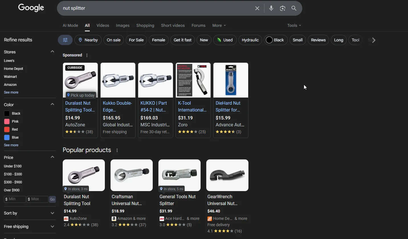

In the extraction phase of the old hose I snapped of one of the bolts holding down the end of the hose on to the shock. my thought was undo the 22mm nut holding the cushion down and then I can try to extract what's left.
In the car would be a nightmare as there's just no room.
Problem is the nut that hold the cushion on is rusted as anything and I can't seemingly get a spanner on it. Any alternatives or trick to get this sorted?
