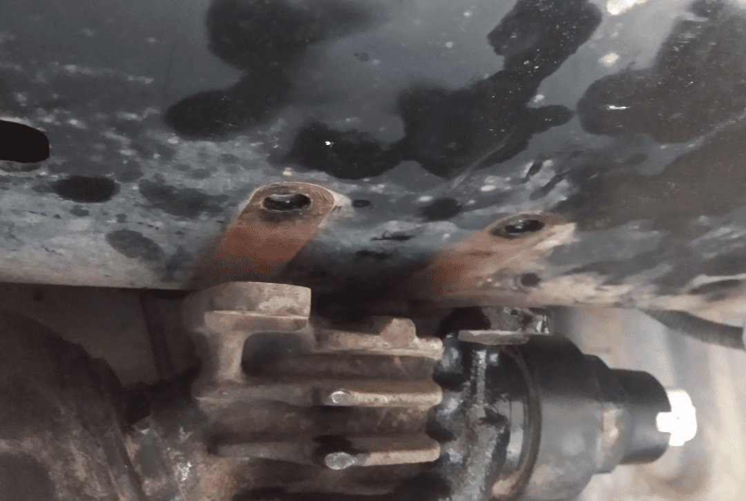

I pulled mine off because I wanted to run three post LC style rock sliders. Even in an area where road salt is not used, rust started forming behind the AHC components that were bolted to the frame. Once I removed the frame components, I ground the rusty spots down to bare metal and refinished the area with primer and paint to keep that part of the frame looking like the rest. I had problems removing one of the top 12mm bolts I used a Sawzall to cut off that one. off.

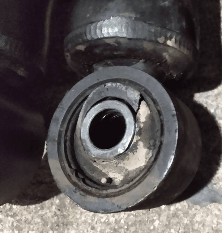

The bushings were gone, the pump was weak, and all but one of the accumulators had failed. It was just a tired old suspension that needed a lot of love.

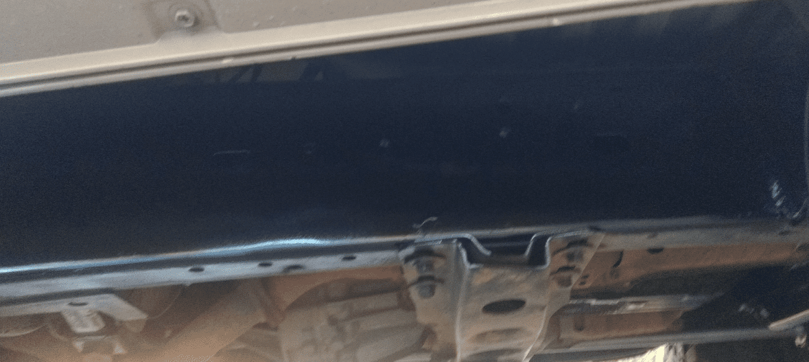

After refinishing the frame are where the AHC components had been rusting.
That's a great picture of that lower bushing and why it's worth replacing. I think that bushing right there is one of the main drivers for people feeling harsh ride with AHC after basic checks are complete.
