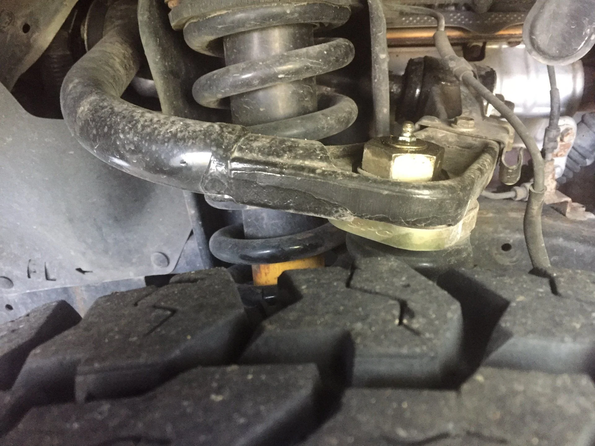

So, I have been battling these UCA's and would like to know if anyone else's UCA recommends to install washers on the inside of the bushings (Between the UCA and the Bucket). That is what I am being told the issue is, however... I cannot fit a washer/spacer between those two. There simply isn't room. Just putting feelers out to try and get to the bottom of the issue.
Where I am having a problem is where the UCA travels up as the suspension compresses, it meets the bucket where the outer edge of the bucket angles out toward the wheel as it travels up.

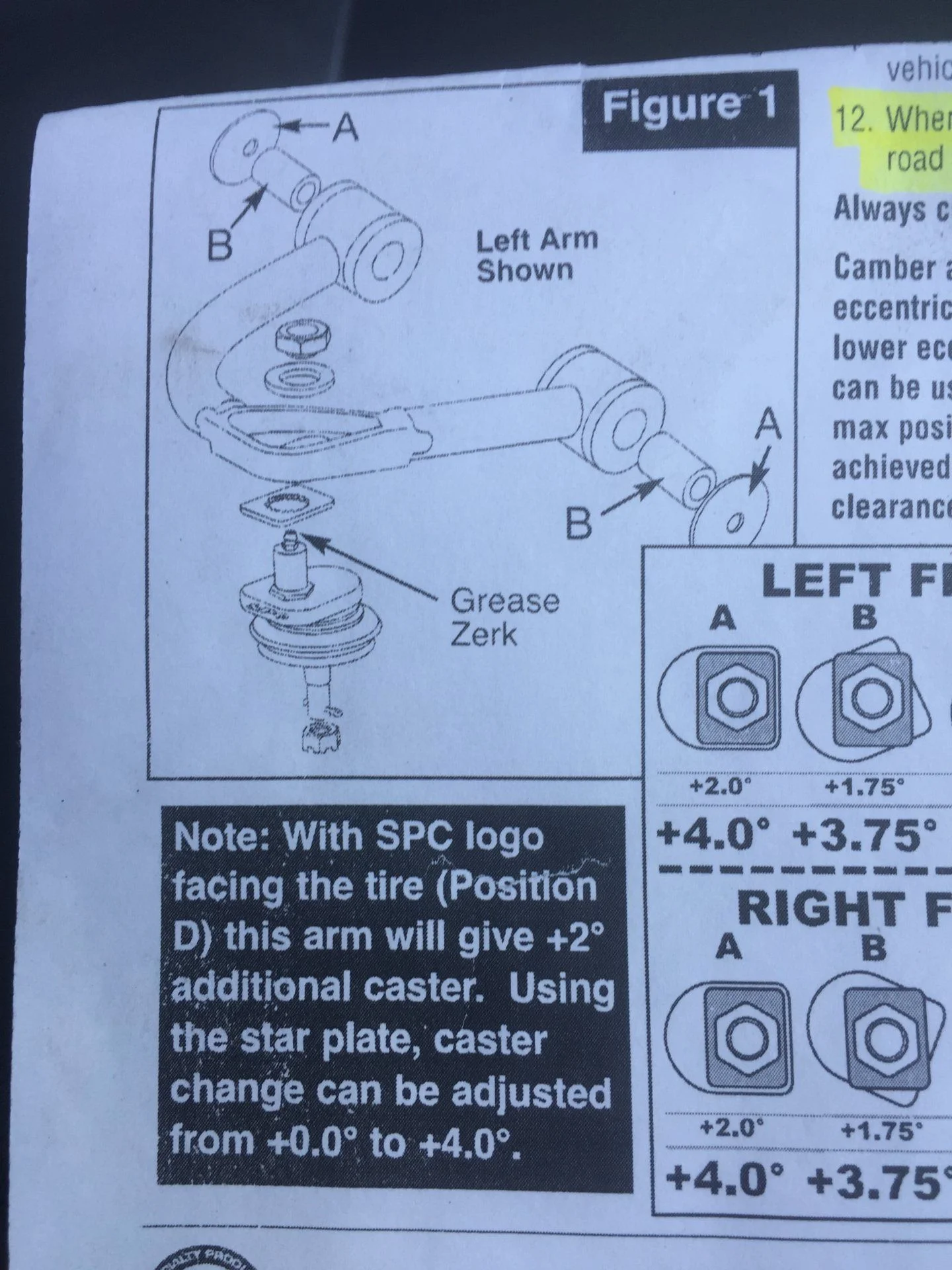

I have SPC. They came with their own washer/spacers in the kit that were to replace the stock washers. IIRC, the stock washer was beveled and the SPC was completely flat. But they did fit.
So the SPC also used the washers on both sides of the bushings?
Thank you for your reply!
Yes, I installed a washers on both sides of the bushing on the outside.
Here’s a pic for clarification
When I say both sides, I was referring to both sides of 1 bushing. For a total of 4 washers.
I have since removed the Dobinsons UCA's and installed Delta Joint Icons... Much mo betta.
