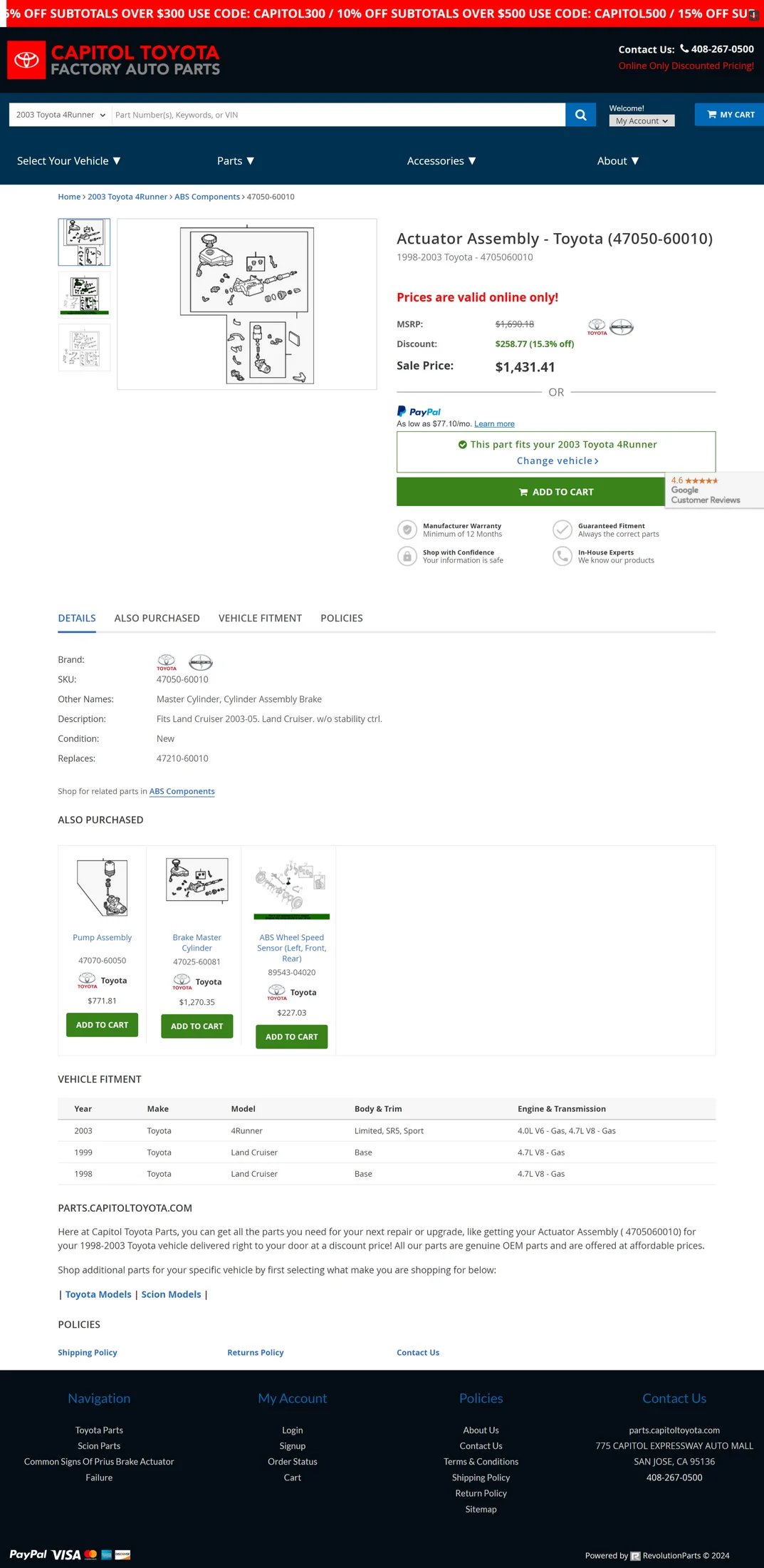

I was told by the local mechanic that I need to replace the “master cylinder with electric assist” and that he couldn’t find any since it’s such an old car. I think I have found some online but it’s named something different. Is there anyone here that can help me find the part I need? Send me in the right direction? I will attach a picture for some reference. Thank you for the help.
Here you go, you can also find used unit on Ebay or CL. What did the mechanic tell you what's wrong with the part?
