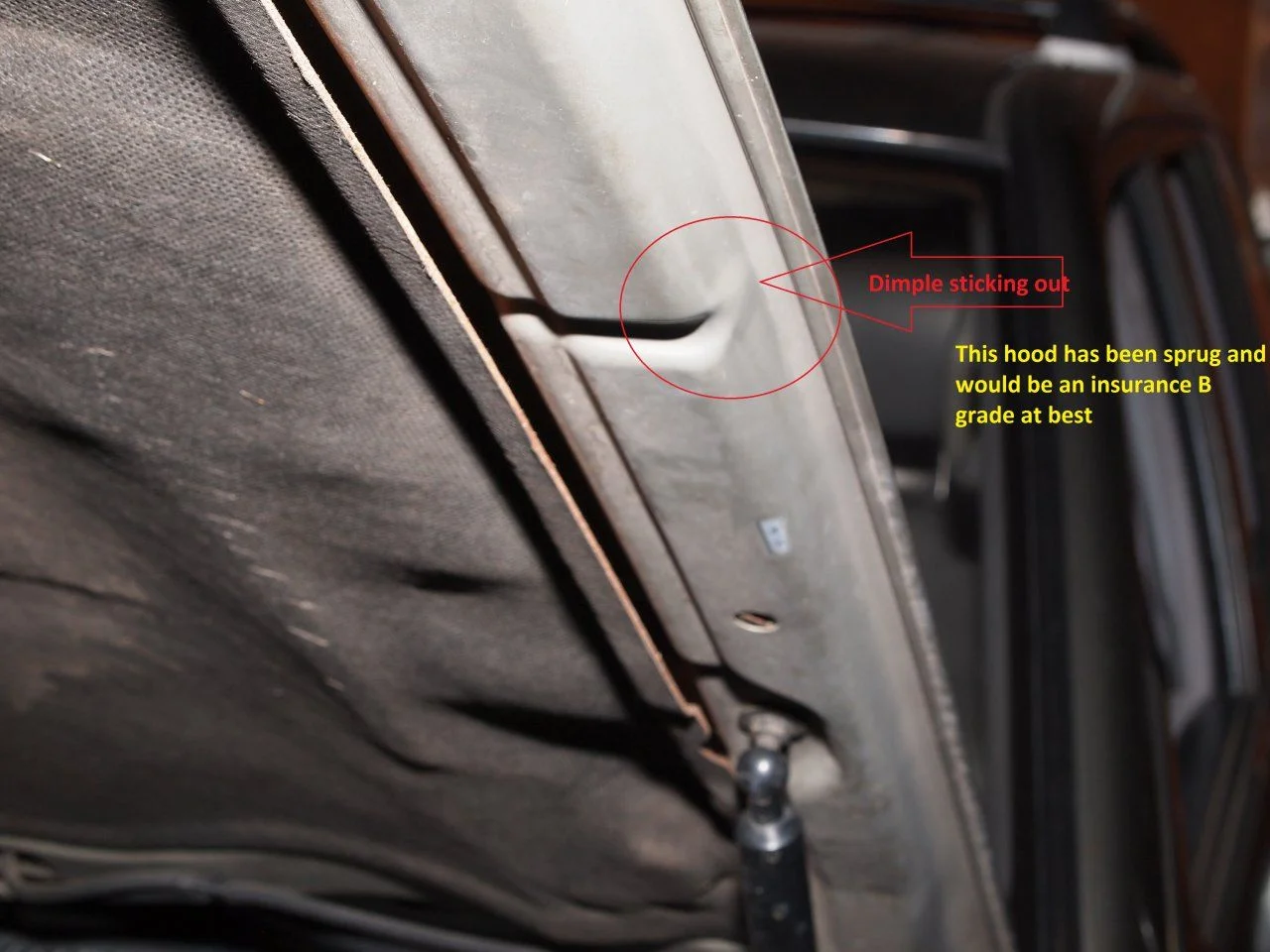

Your hood may have been damage. Look at crinkle zone half way down each side. If you see any distortion there it's had a front impact. Also feel/press around center of hood as it is close, does the sheet metal flex. Here two examples.

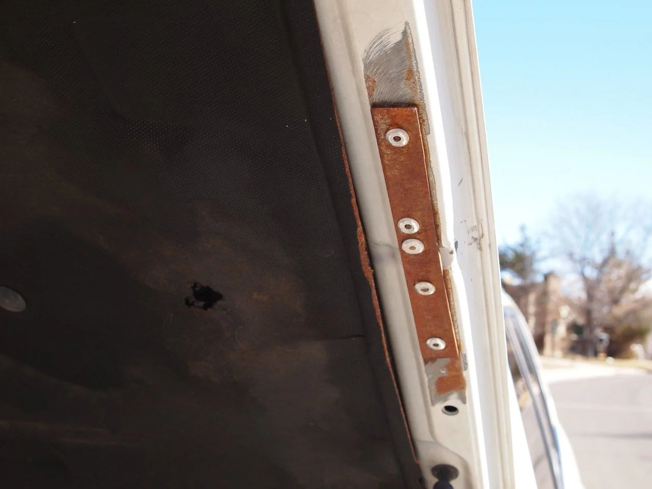

This is the one I'd like to replace. I may take to quality body shop and see what they can do with it. The shop that PO used that did this hack job, is not on my short list
Very interesting note on that crumple zone. Oddly enough, on the drivers side there is a noticeable dent on the top portion of the hood (visible from the outside) near that area. It looks like someone closed the hood while something was in the bay at that spot. The carfax did show side impact (hit by a motorcycle, door replaced no frame or fender damage) but nothing on front impact. I cant see any other signs of front impact but they may be there and I just don't know what they are. Or perhaps they just repaired the hood and didn't replace it completely. I will have to check that dimple as that may be the reason mine flexes. I was considering putting some metal straps in between the support structures under the hood to make it more rigid, or just leave it since it doesn't appear to be dangerous.
The support structure (skeleton) is most likely bent. The dent you see may be from someone sitting or walking on hood, then tried to pop it back out. Its the skeleton that keeps it from flapping in the wind. Yours may be and easy fix.
