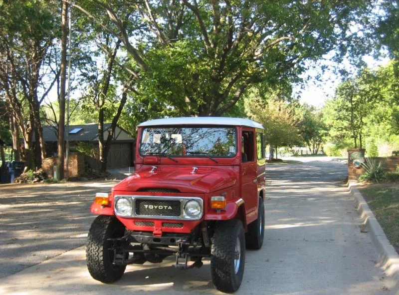

Sea Knight,
That is a nice ride!!! I bet even wrecked it looks better than anything I have. Reading some of your posts in other threads it appears that you take your time and put them back together with some care. I'm glad you and the fj came out all right.
Is that a 79? I have a limited knowledge of the difference in the years. Is that a recent picture or one during the restoration. By your conversation I am assuming your still restoring.

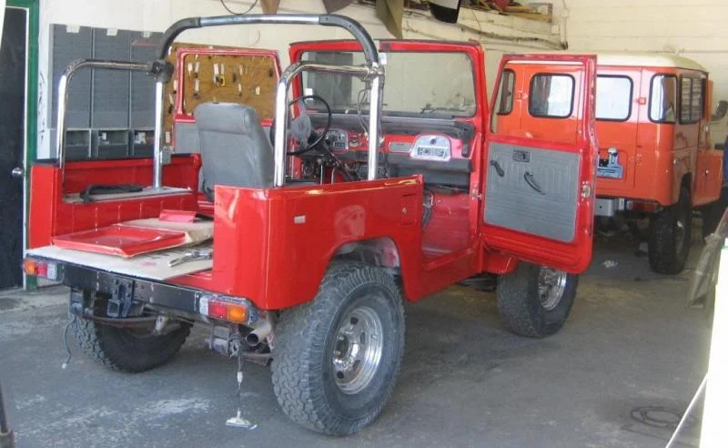

3 yrs ago I pulled my gas tank and half the passenger floor came out with it. Enough was enough. Ripped everything from the firewall back out. Ended up rebuilding most of it with modified forms for braking and such. Before I got use of a brake, I made one bend with a 350 gal. tote filled with water a fork lift and welded the steel to a metal table. Soon found out it was better to find a good ol boy with a brake!!!
Turned out pretty good. Went back with either 14 gauge on rear fenders and 10 gauge (It may have been 12) on the rear bed. The thing is a tank now. I was still tack welding and getting ready to sand it down and paint when my youngest daughter kept on pleading to get it back running so we could drive it. She was 10 at the time and basically ran the roost as far as daddy was concerned.
I slapped her back together thinking I only have about 4 to 5 yrs before dad would no longer be fun to hang out with. Haven't touch it since. Surface rust everywhere and unfinished welds. This thing is ugly!! But we still have fun in it. Later was looking through some of the posts on here and saw some of the easier ways several guys came up with making the rear fenders.

It's an '82. That pic was taken last October and yes, I'm still putting it back together. I'm pretty anal, and slow, but it should be finished in another couple of months.
Here's a more recent pic, I think from December?
