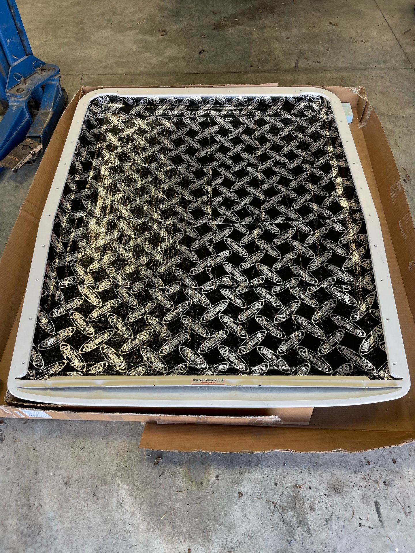

Grab some popcorn and and beer because here comes a really honest review after this top consuming ALL of my Saturday and still not totally installed.
First impressions are that the top is well made, sturdy, and should give a long service life. I never expected it to fit perfectly going in and I was not disappointed because I realize that putting something made from a mold in 2021 won’t ever fit without modifying sheet metal from 1974 (assuming these vehicles have been used for what they were originally sold for as well).
My most positive surprise and one that will please everyone curious as to the hole placements: they’re all almost dead on. The only bolts I have gotten started at this point are the 2-3 in each back corner. I can’t 100% say if that’s any fault of Gozzard putting them in the wrong place or if it’s simply a case of me being exhausted after fighting my biggest issues of the day - I’m pretty confident the top is molded incorrectly on the driver’s side above the door.
At first I thought it was the windshield frame, top, or the door connector that was tweaked so I ended up slotting some holes and in the most egregious place drilled a new hole altogether because it was so far off. Picture below for how far off the hole is from the original mounting location in the connector.
This side of the top narrows so much more than the passenger side. After stepping back and looking at the relationship between the top to each side, it’s pretty uniform in overhang until you get here. My initial thought was that I had the top twisted in place until I saw this.
LH side:
Versus the RH side:
As a result of this I still don’t have the top totally on or in place and the header panel, which is way too short, REALLY doesn’t fit now either. I was able to make it work after many test fits and my own stupidity of being unable to drill a hole where I wanted it to be causing me to enlarge each hole more than I would ever like to admit…adding to my insanity is forgetting to account for the thickness of the weatherstrip that goes between the top and windshield frame. Didn’t think it would be that much difference, turns out I was wrong. The good news is that the fiberglass is easily cut/worked to do what I needed it to but that, unfortunately, doesn’t make my lack of skills with a drill any better.
The too narrow tapering on the LH side vs the RH side is also keeping the top from sitting down properly because it’s hitting the LH side of the windshield frame while leaving a large gap on the RH side. Pictures below show the contact vs gap
Another gap that I’m concerned about, although I think it could be partially a result of the top not being totally in place, is the gap at the front where the header panel meets the WS frame. With the factory metal header panel I’m not concerned about bending but fiberglass will only bend so much and age doesn’t help that at all. On test fit I put a 3/8” spacer on each bolt to help get an idea of what may be needed to seal up. Based on the weatherstrip fitment to the top I think it will seal without issue but will look pretty funky with that big of a gap though.
I intend on contacting Gozzard to get their thoughts on the situation and how best to proceed, but I have to admit for the cost involved it’s pretty disappointing to potentially be cutting one up this much.
Some other weird issues that some may want to know but I don’t see it being a problem is a funky bend in the front of the top and some gaps on the sides pictured below. The front upward sweep makes me think of a baseball cap for some reason.
Last bit of pictures just for some to see, including one of the hot rod that I’ve shared workspace with this week. Who knew someone out there would actually want to restore a Ford Pinto(?!) :oops:. Turns out one box of Dynamat will cover the interior of the top as well.
