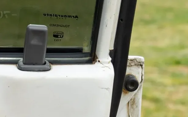

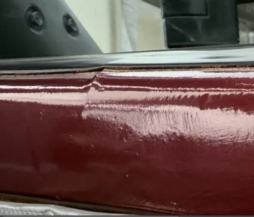

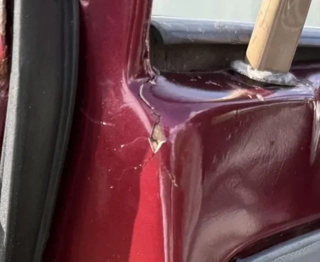

Anyone try these doors? My RH side has buckled on the inside near the window, and inside the metal tore near the handle; cracked window frames where it joins the door. Anyone else experienced this? Not sure if these are worth the upgrade and/or just resold from AliExpress

Thanks yea I could find a way to get them here. I can probably even source used doors here in Canada. I’m more curious if anyone has tried the 1.3mm thick doors and if are actually any stronger and worth the effort; paint, moving all the hardware over, etc etc

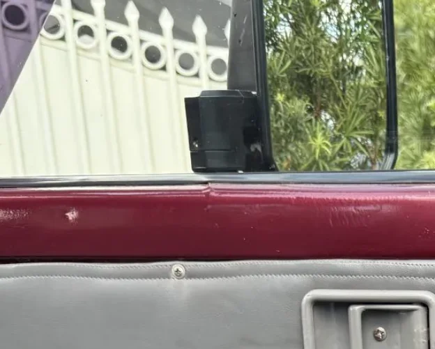

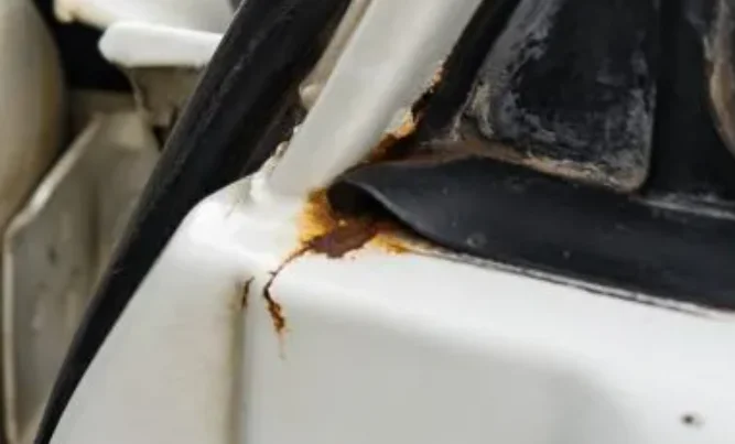

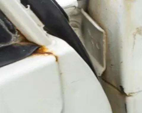

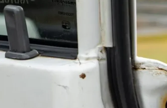

So reviewing photos off BAT and etc I can say this is a problem with these doors
My ute has these same symptoms
No Reserve: 1995 Toyota Land Cruiser HZJ75 Pickup 5-Speed - https://bringatrailer.com/listing/1995-toyota-land-cruiser-hzj75-5/?fbclid=IwY2xjawIHY6NleHRuA2FlbQIxMQABHS8azpS4J8CQl4ZT4xWnSALQLh7GxGE9OZOG0jLeEyWU7RYB76Z1GmKWuA_aem_96DNPAmDI2zoipgPFiEkSA#comments-anchor
RH door buckles by the window. Truck was obvs bondo'd

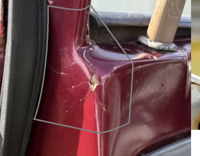

Inner door panel splits in the corners
Sharing thoughts here. Making a plan to bend some sheet metal and make a brace/gusset on the inside of the doors. Try it on my truck and see what happens before committing to new doors. Will have to paint etc, but being on the inside I'm not super concerned
Something like this if makes sense
There is room between the body/door jam and the door in this area when shut so should work
Any thoughts appreciated
