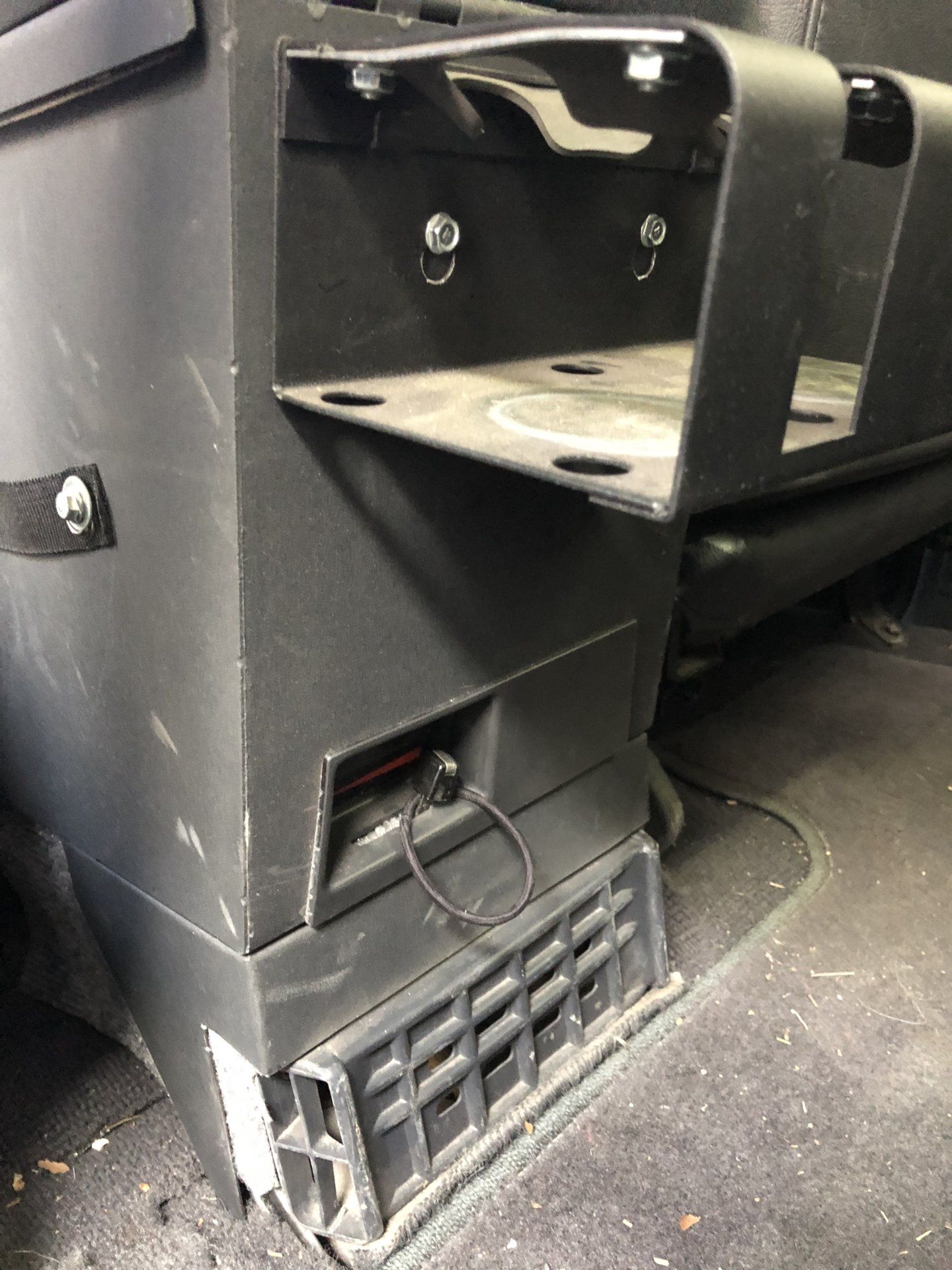

Not sure if you guys have an equivalent in the states but this is a Waeco wcf11 which is a proper fridge freezer. They are around $400au and I've been fitting them to every landcruiser build I've done.
Fits 11 cans (can't remember how many litres) and has the 2 drinks holders at the front.
If you are interested I can upload some pics of it installed (I did have pics in my threads but got screwed by photobucket).

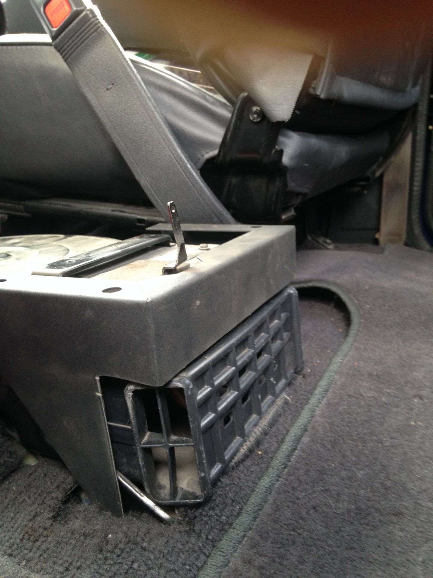

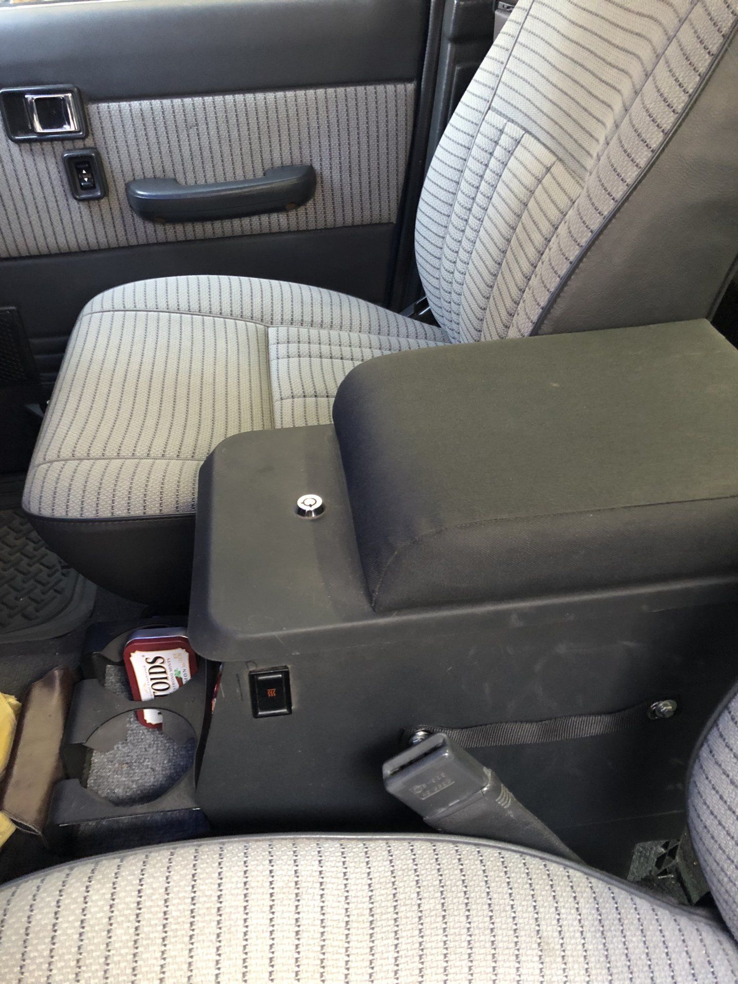

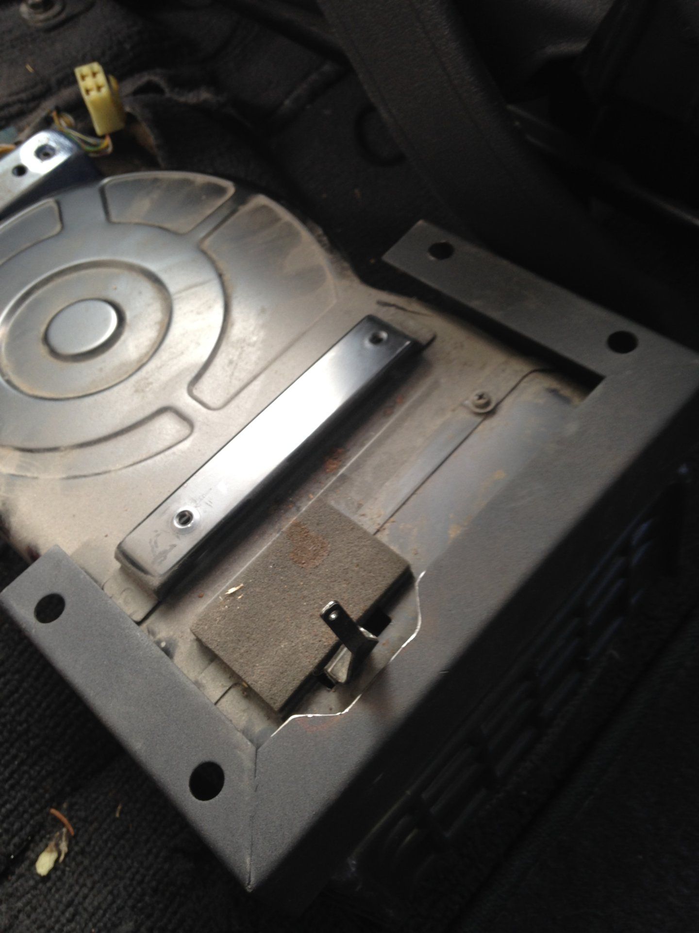

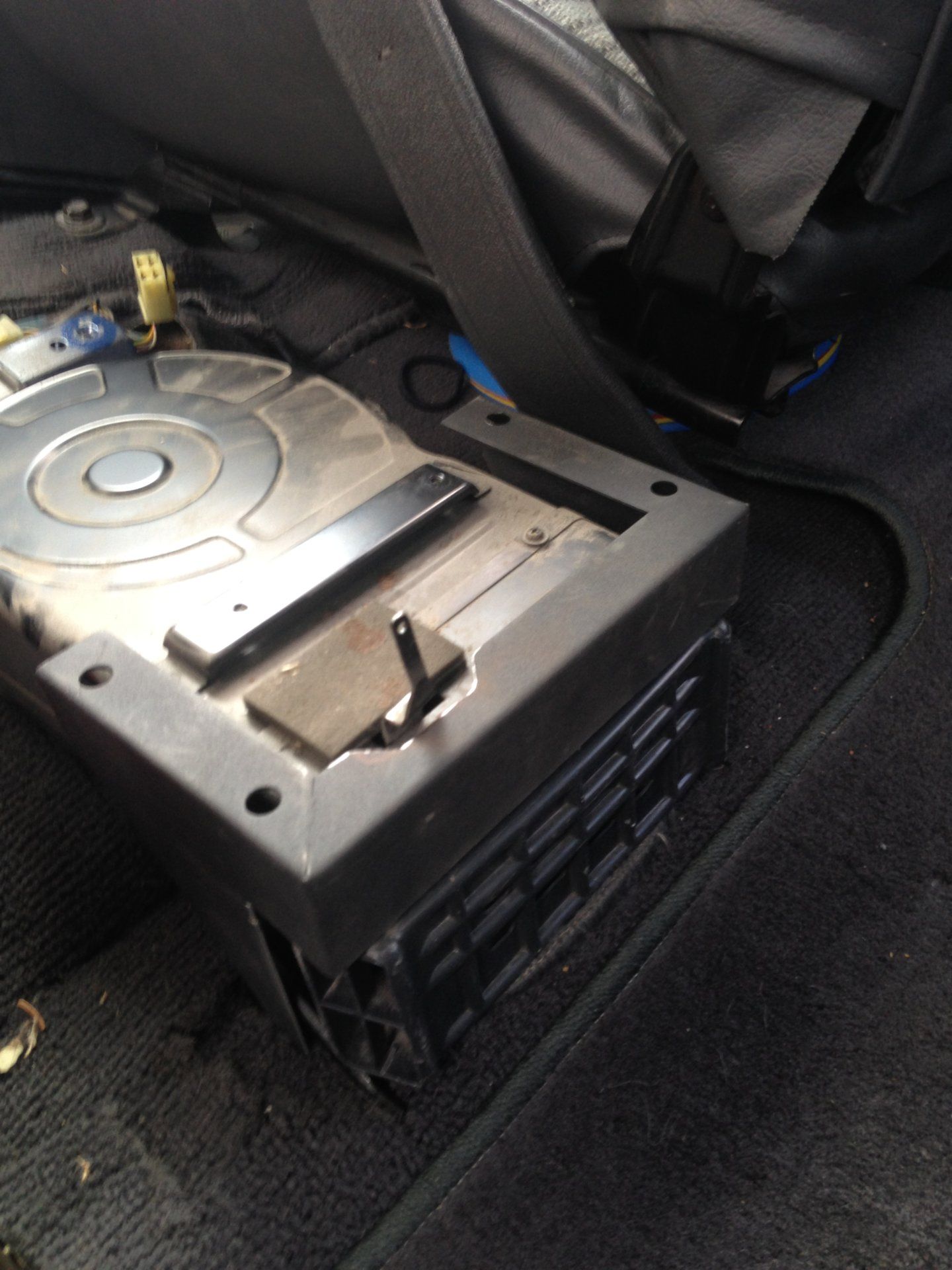

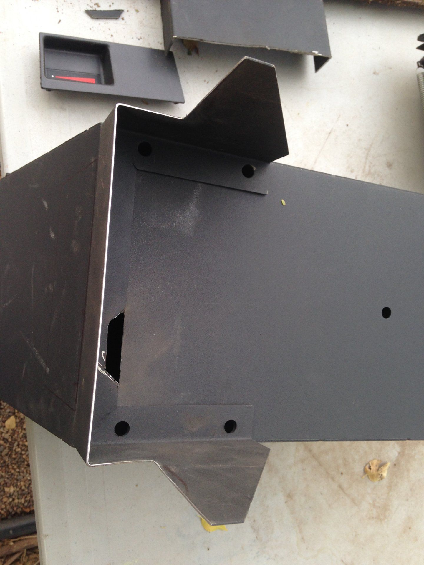

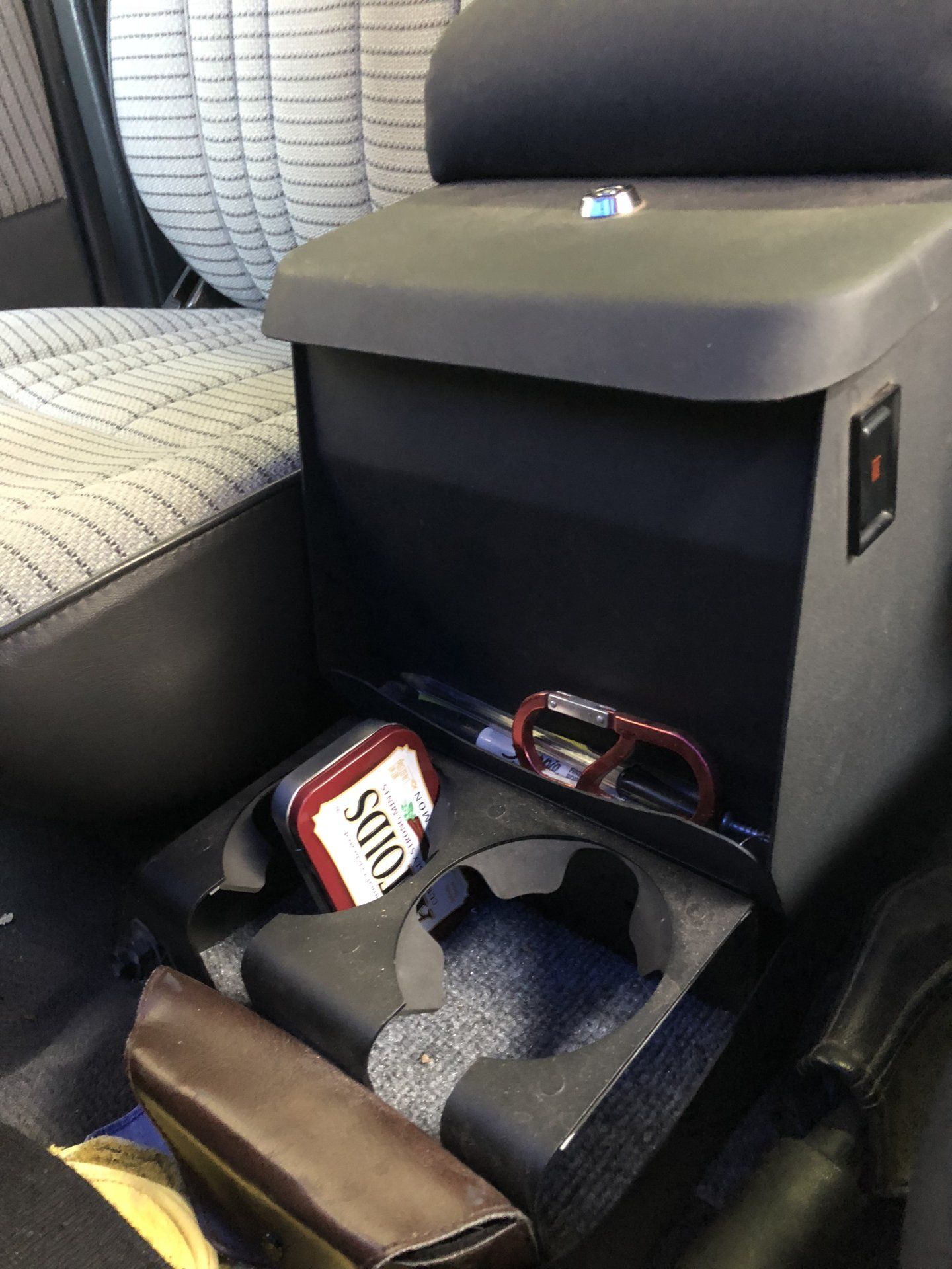

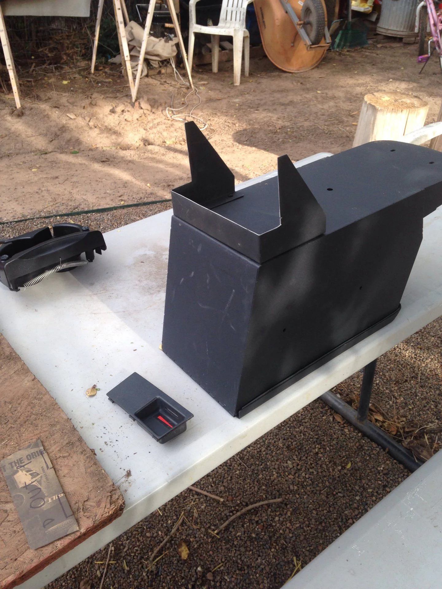

Here’s some pics of installing the Smittybuilt in my 62. I found it at 4wheelparts, I wanted to look at it in person before buying. For $100 bucks and a few hours time to make it nice, I feel it’s worth it.
Is not super bullitproof, and the drink holders were awful. The springs were retained by a paper clip from the factory! That’s was fixed with a Tuffy $25 drink holder that fit in the front of the SB console without severe modifications. It does hold a lot of stuff. I’ll try to shoot another picture tomorrow.
I did find all the info on the install here on MUD. (Thanks again mudders!).
I chose the Smittybilt because it was cheap and I was going to be hacking on it to keep the rear heater temp control and the fan hi/low switch. Since it was an experiment, I didn't trust myself to cut on a Tuffy, etc. But I've had the Smittybilt for years now and I have no complaints... once you replace the cupholders with Tuffy's or similar. Also, some small rubber u-channel along the top of the can keeps the rattles down.

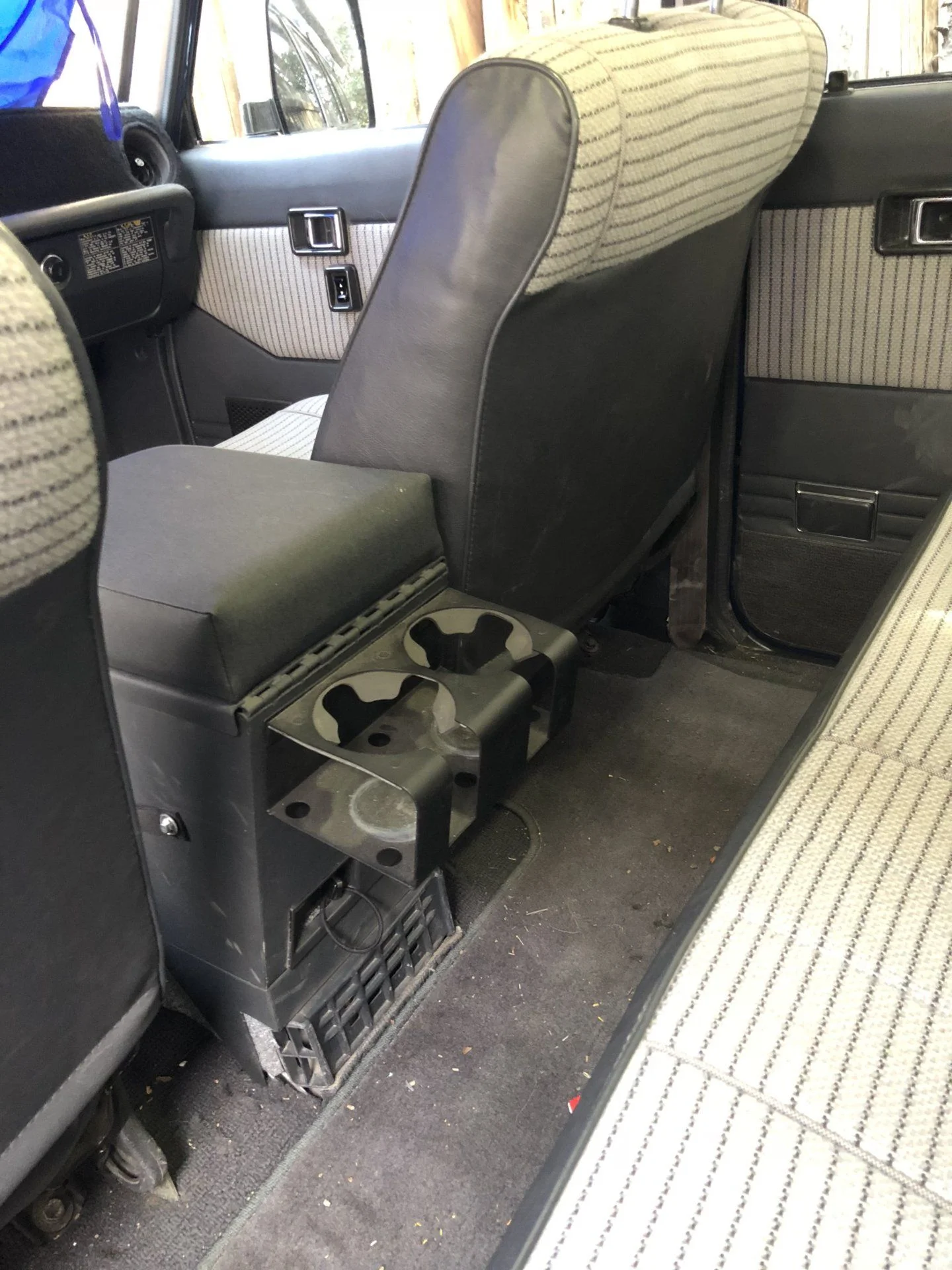

Yup, main thing to realize with the Smitty is that you have to do some modification to be able to mount. I took the long mount bolts that I had from the original console, painted the tops with some white paint and the positioned the SB on top of the bolts. This gave me general markings as to where I would need to cut. Took a couple tries but eventually found a position I figured I would like and drilled the holes. It is a little far to the passenger side but it is good enough.
To fix the cupholder issue, I took some 3" black pvc I had laying around and cut some lengths to figure out how high I wanted it to come up (think it ended up being 2") and then glued them to the original insert. Works great, bit redneck but I dont particularly care.
Big Blue, did you make/bend up that support bracket? I need one!!
