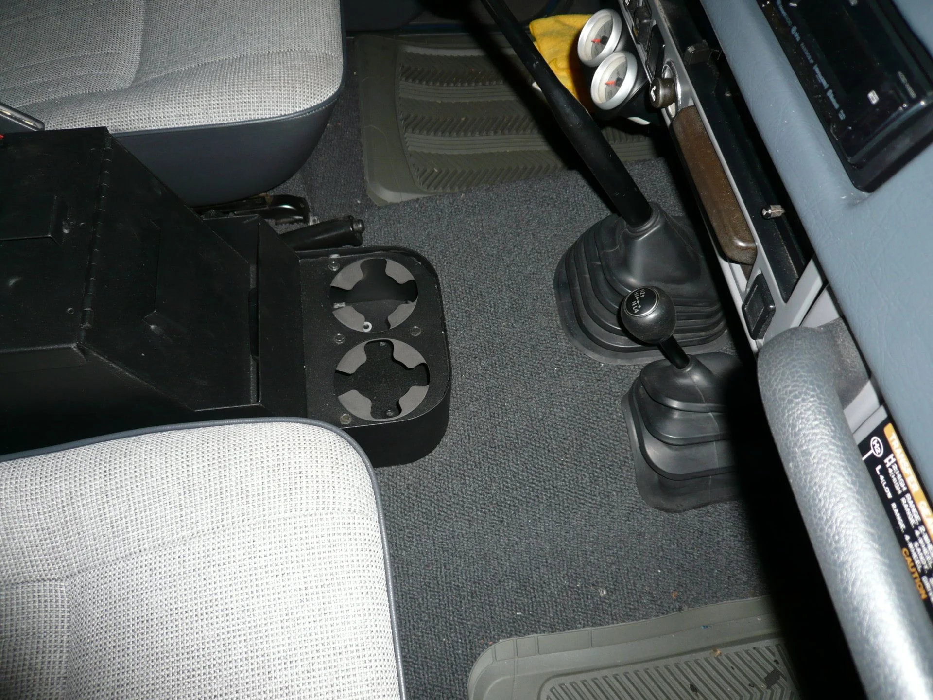

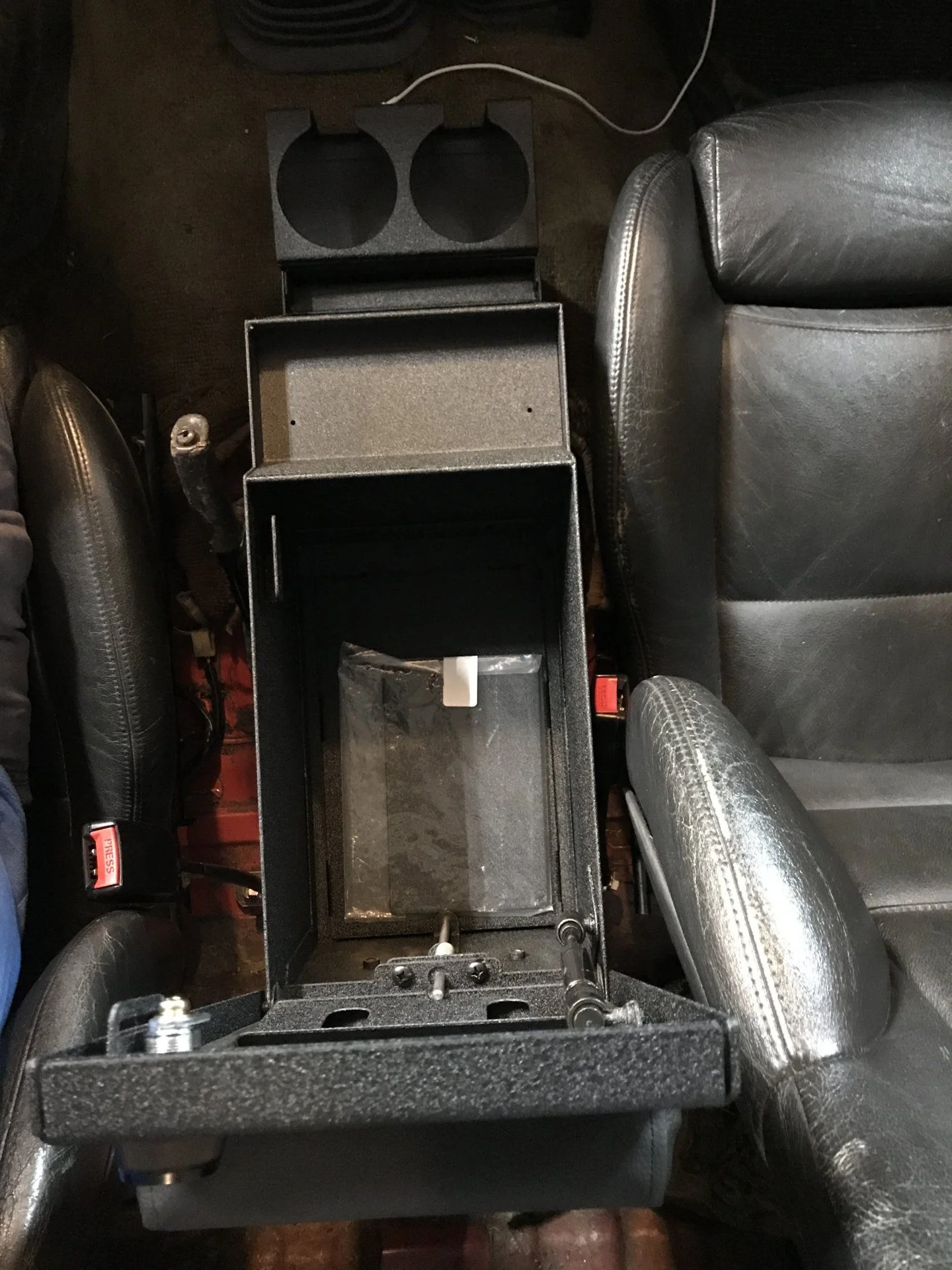

I made my own from an ammo bag ($50), a scrap piece of wood, and 2 camp coffee mugs! I bolted the scrap wood where the old console was and screwed the bag and the mugs to the wood. Easy-Peasy.

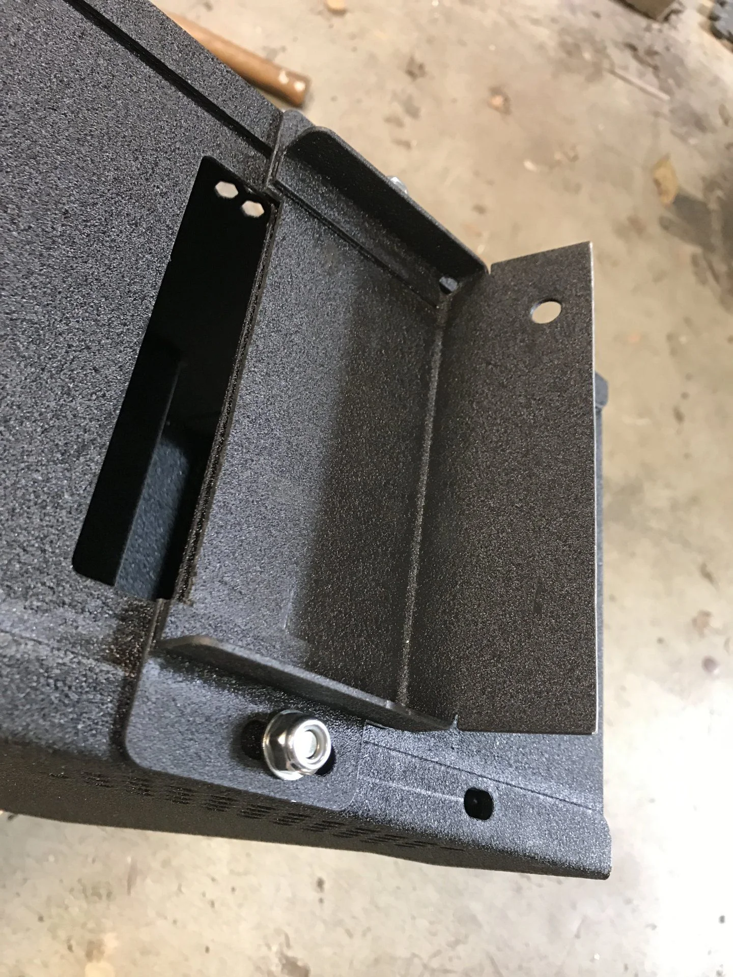

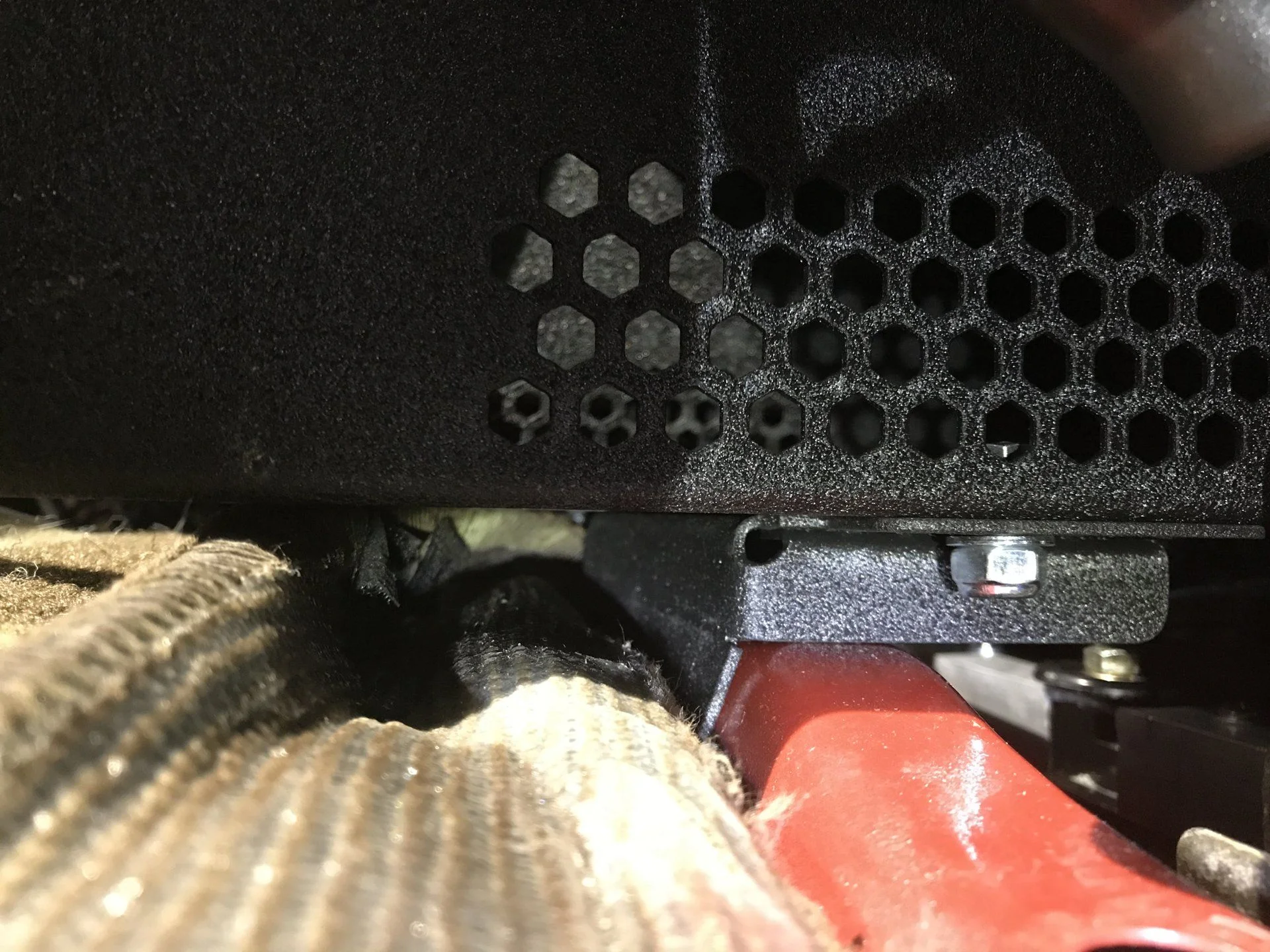

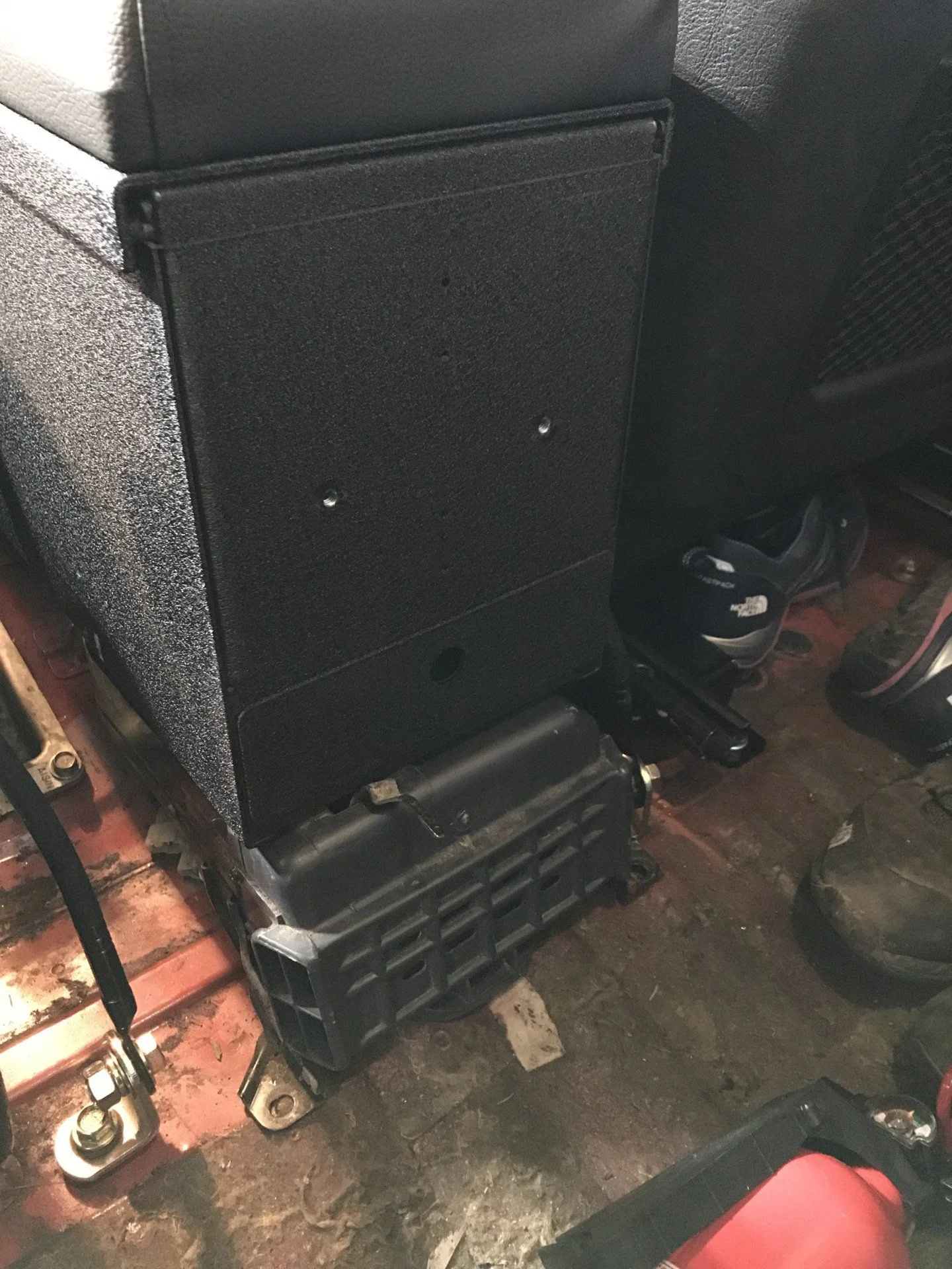

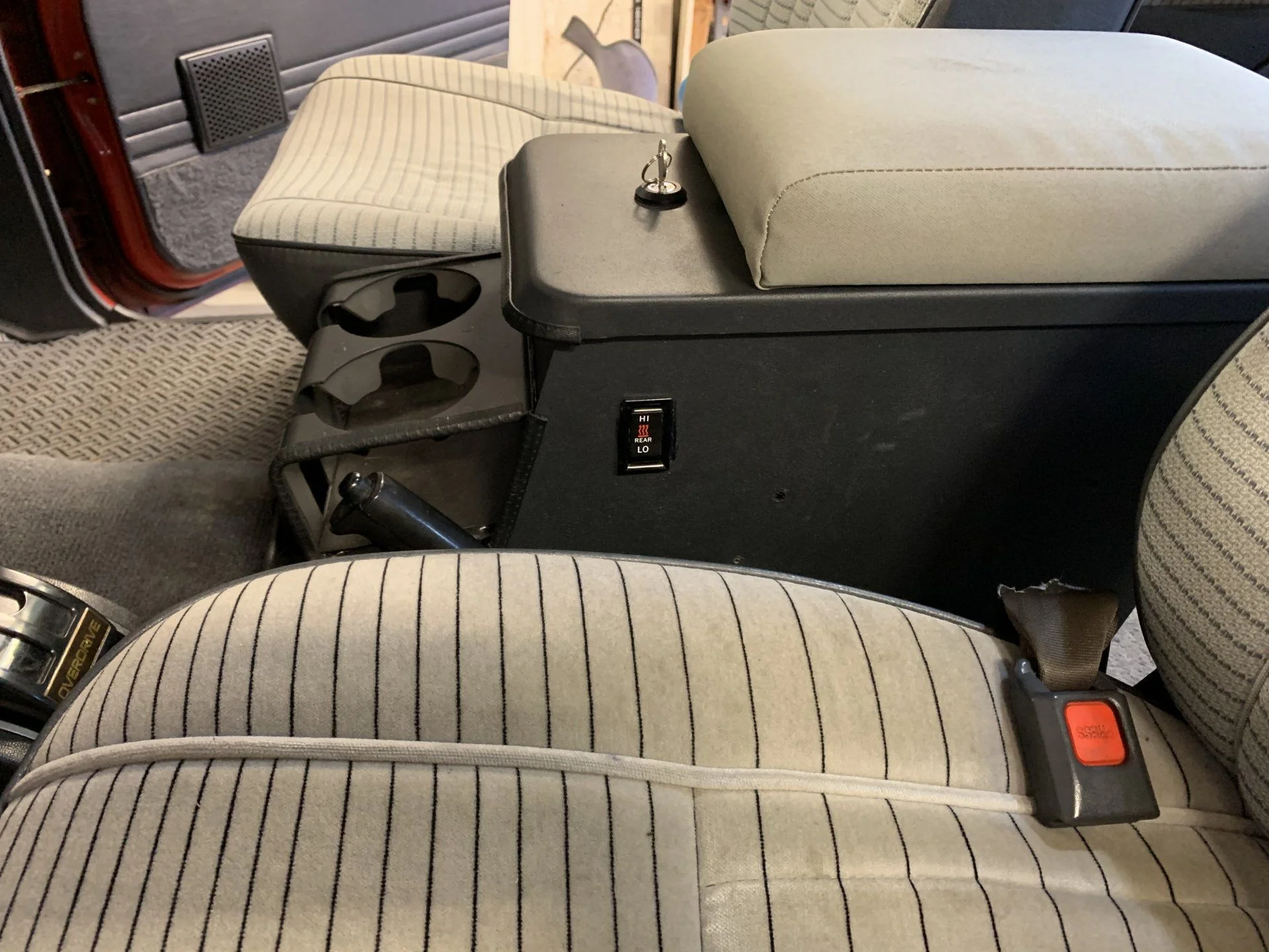

I’ve got a 62 console in my 60 but the heater is still under the passenged seat, but discconeted and needs to be removed.
Seems to be worth the money for me.
As an FYI on the 60 the I just had to redrill the mounts and used the stock hardware. On the 62, you would have to make a rear mount. Though be easy enough with some flat bar bent.
Sorry for the pics, i shot them fast, the cruiser is rather dirty on the inside right now.
Although glad I took that rear shot as it looks like I need to adjust the front seat cover.

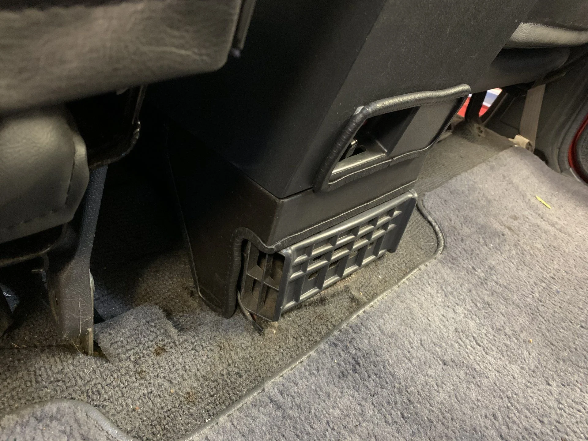

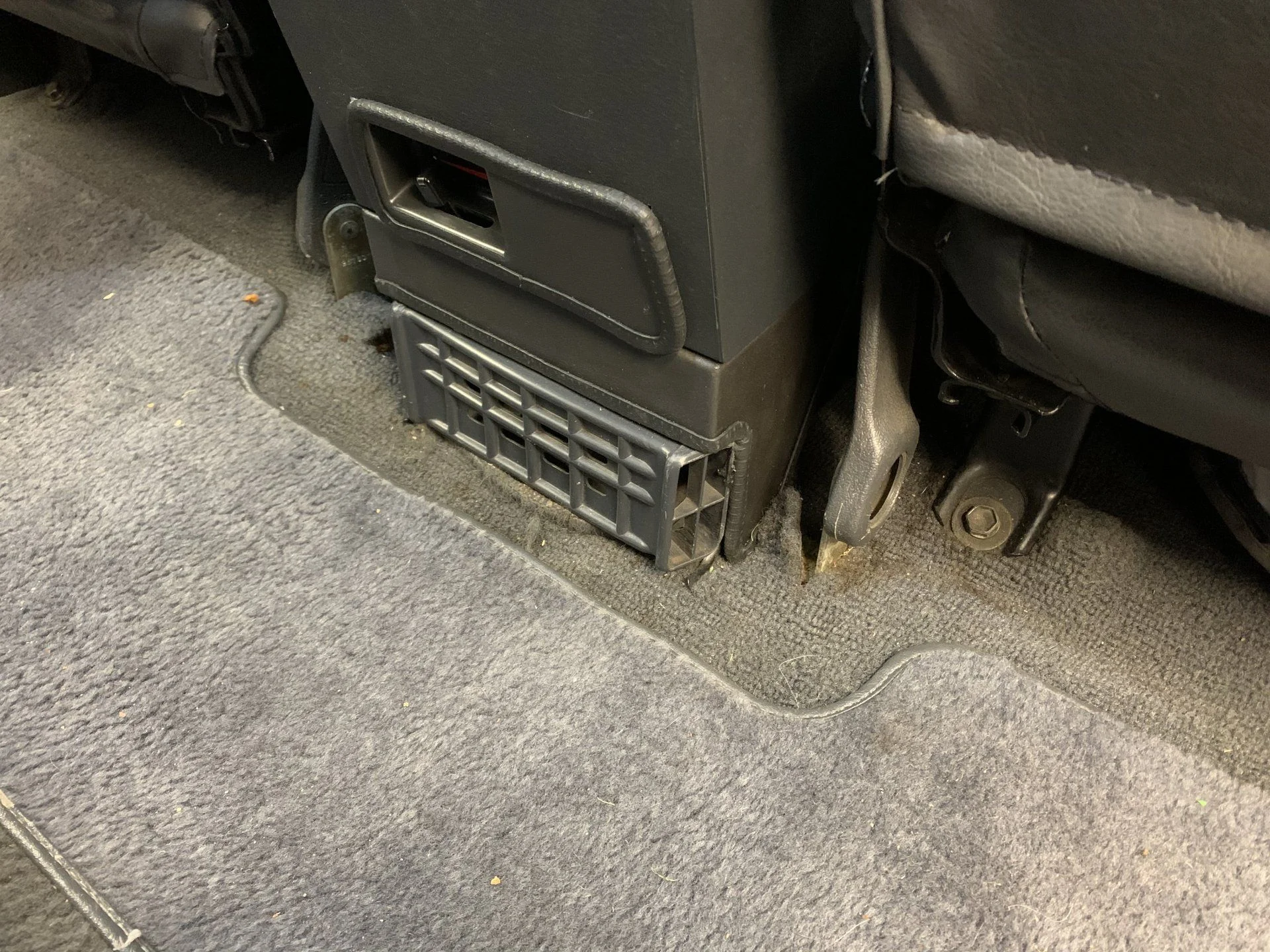

Is this a cruisercrap center console? I wanted to put one in my 60 but wasn't sure if it was for the 60 or the 40?
It can be done. There is some modification to get the front bolted down.

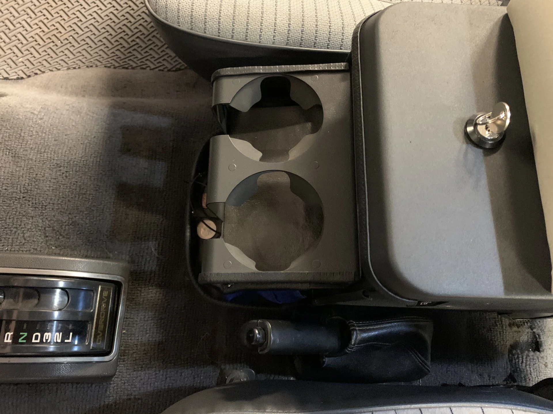

I have a 83 (early floor pan) FJ60 with a 62 rear heater. I mounted the cruisercrap console on top the 62 heater. It took drilling 4 holes, cutting the provided front bracket slightly and was not that bad to get it to work. I wish I had indexed the console slight more passenger. My hand when reaching down to pull the brake handle is a little tight on the console side.
Let me know if you have more questions, or take a look at my build thread in my signature line.

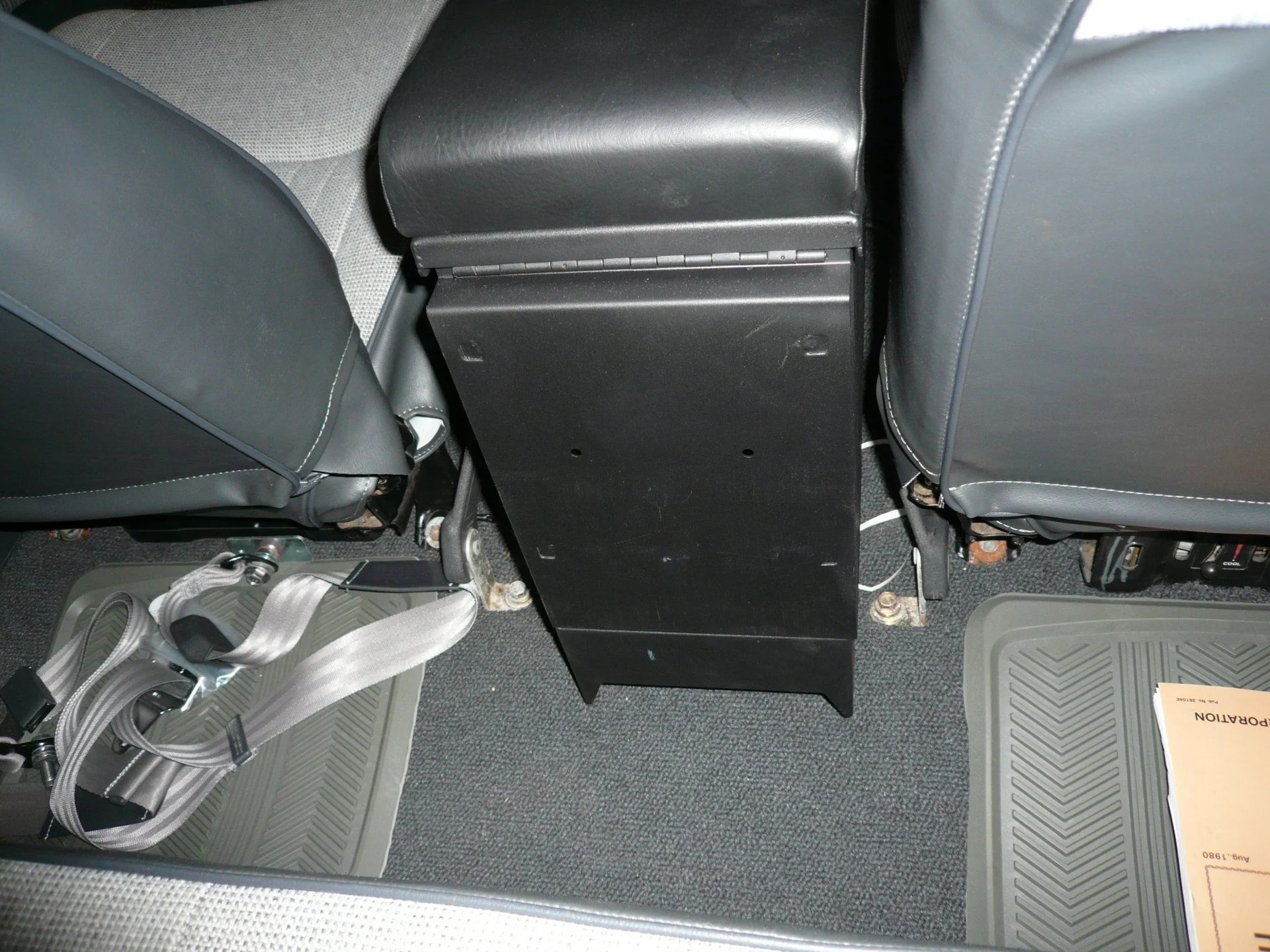

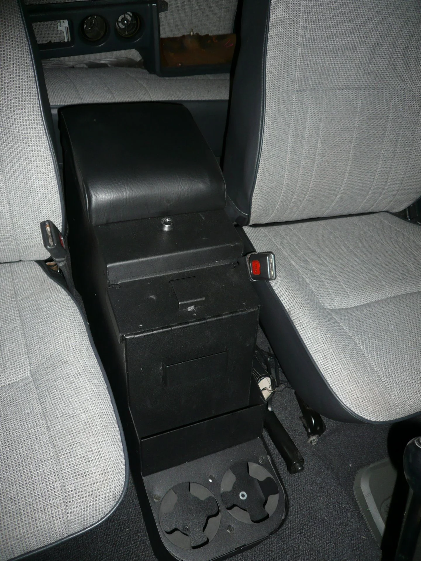

Is your center console the one from Wild Horses? and was it tough to fab a bracket to keep your rear heater? This is the exact set up I'm looking for and you kept the rear heater.
I used the CruiserCrap console.
Looks exactly the same.
I was able to modify the brackets included and only added a 8in length of Alu 1in square tube to support the console.
I haven’t needed to beef it up. It’s held up well.
Check out my build thread here and you can see what I did for the install.
Feel free to message me if you have any questions.
-Dave
-Dave
Dave,
Awesome. Gave me confidence to take the plunge. It looks like it's pretty sturdy and functional. Looking forward to getting it in. Thanks again,
Jaime
