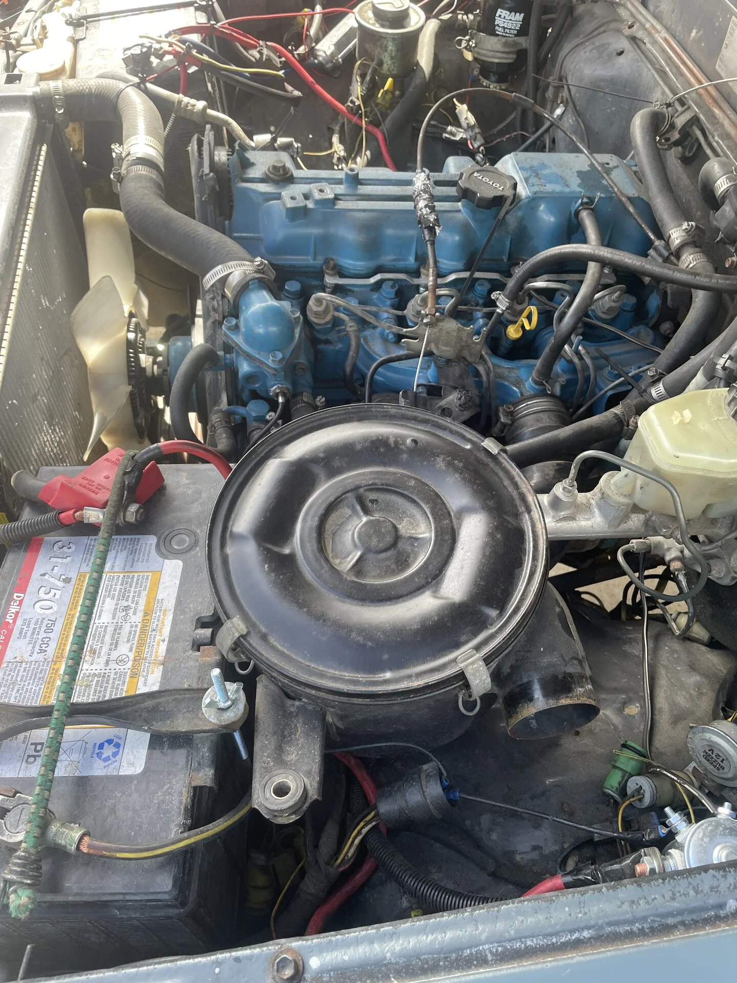

Hey all,
I'm curious if anyone has ever swapped out their stock air filter boxes for something that breaths better and is a little more common to get filters.
The filters I've been able to find don't fit in the housing very well and squish down pretty good, plus its like $60. I'm gonna be turboing the 2L soon also and wouldn't mind somthing that can flow more air. Has anyone put a filter housing in from like a cummins or somthing?

Don't use a K&N filter
The stock is good and breaths and filters well. Don’t change, you are only downgrading.
oh really? I get a bit of black smoke at 80% throttle and it stops accelerating, I figured it was starving for air.
Rumor is AFE makes filters for TRD
Welcome to an N/A diesel. I'd be highly doubtful that the factory intake is a restriction.
Toyota factory air box and filters have been shown to be the best option until you significantly increase airflow with a turbo.
K&N filters are rubbish at filtration. There's been legitimate testing done on several brands of filters and K&N where at the bottom of the list. Toyota and other OEM filters are the best you can get, along with a few aftermarket brands like Donaldson Filters.
The factory filters actually do what they are supposed to, and aren't a restriction if they are maintained sensibly.
